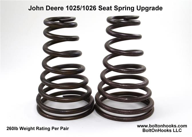

I have an idea on improving the seat suspension on a 1026R
   / I have an idea on improving the seat suspension on a 1026R #41
Psrumors, if you can come up with springs for
a 2 series, I'll take 'em. I have a 2720 and a 2305. Any help would be appreciated. I will try the tennis balls. I am assuming it takes two.
   / I have an idea on improving the seat suspension on a 1026R #42
Tennis balls are cheap at Walmart; get a half dozen or so and mix and match as needed.
But t balls don't work as well as I'd like for my seat since I replaced my safety springs (I forget what they're called but they're not the seat springs, just the safety switch springs) with longer ones. So now I've got a small air filled football that cost like $4 at target. Still not sure if it works like I want it to or not.
   / I have an idea on improving the seat suspension on a 1026R #43
1026R seat springs..
PsRumors, do you still have any of the modified seat springs you mentioned in this thread? If so, please send me a note. I signed up to this forum for the sole purpose of contacting you about this. Thanks!
   / I have an idea on improving the seat suspension on a 1026R #45
PsRumors, would you happen to sell the springs for the seat still? I just checked with JD and they still do not have a better spring for the 1026r seat. Appreciate any help!
   / I have an idea on improving the seat suspension on a 1026R #47
We are selling the updated springs now, please look here: Ken's Bolt on Grab Hooks <<JD One Series Accessories>>
