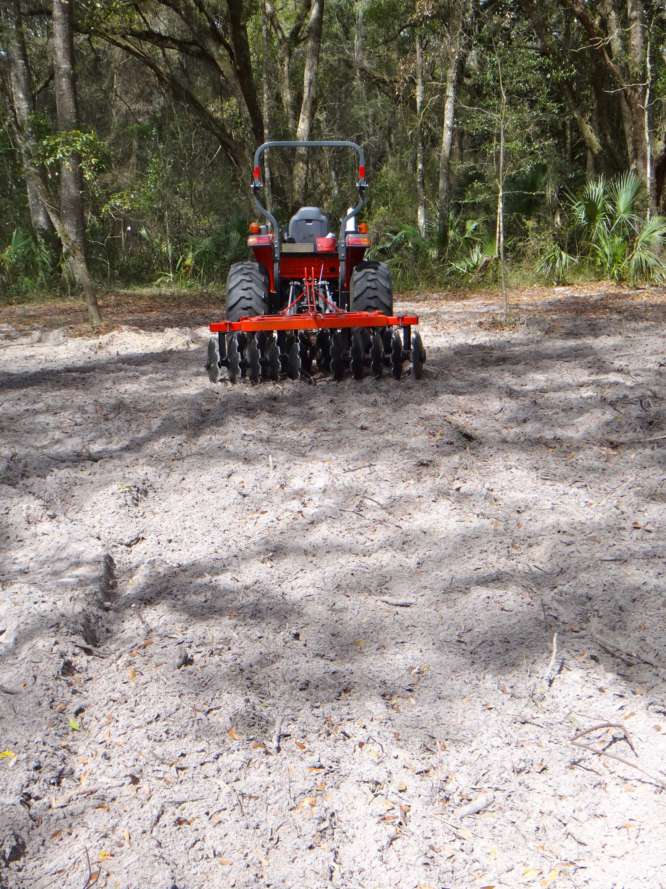

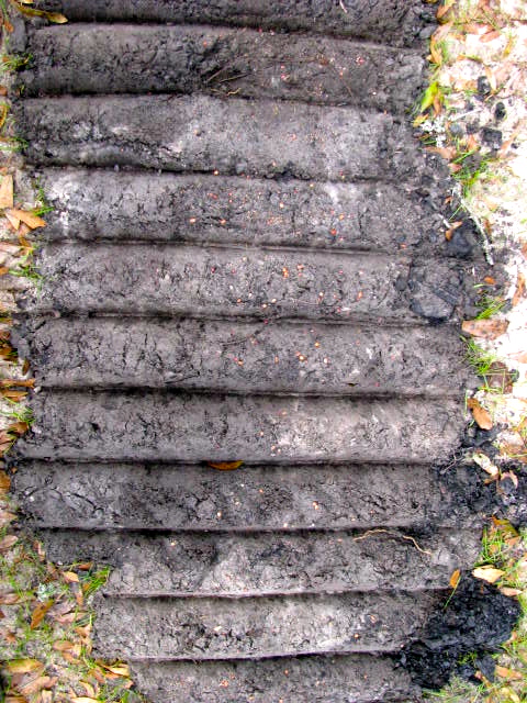

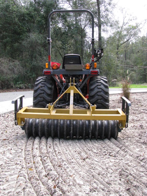

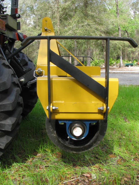

Any thoughts on the bare minimum implements I woud need to do the food plots? They have field grass that will be mown short and have never been tilled.
There are two schools.
I use a Disc Harrow followed by a Cultipacker to press in seed. However, unbroken land needs to be broken by a Moldboard Plow or a Disc Plow (which is NOT a Disc Harrow) before a Disc Harrow will till effectively. Minimum size Disc Harrow which is effective has 18" diameter pans, better is 20" diameter pans. A subcompact tractor cannot pull an effective size Disc Harrow.
( If land has NOT been broken with a plow, Disc Harrow pans just roll/float over the sod root structure.)
Others use a PTO-powered Roto-tiller. There is a roto-tiller made for every size tractor having a Three Point Hitch. After roto-tilling, drag or use a Cultipacker to press in seed. You do not need to plow before using a roto-tiller but more than one slow pass with the equipment will likely be necessary.
