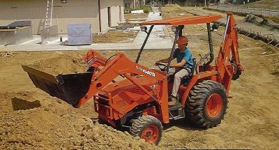

This tractor has industial tires on it. Is this what yours has?

Or does it look like this Ag tire?

Yes! Those are the ones. I'm thinking maybe based on one remark made here, the disc/k may be too heavy for this tractor as well.
