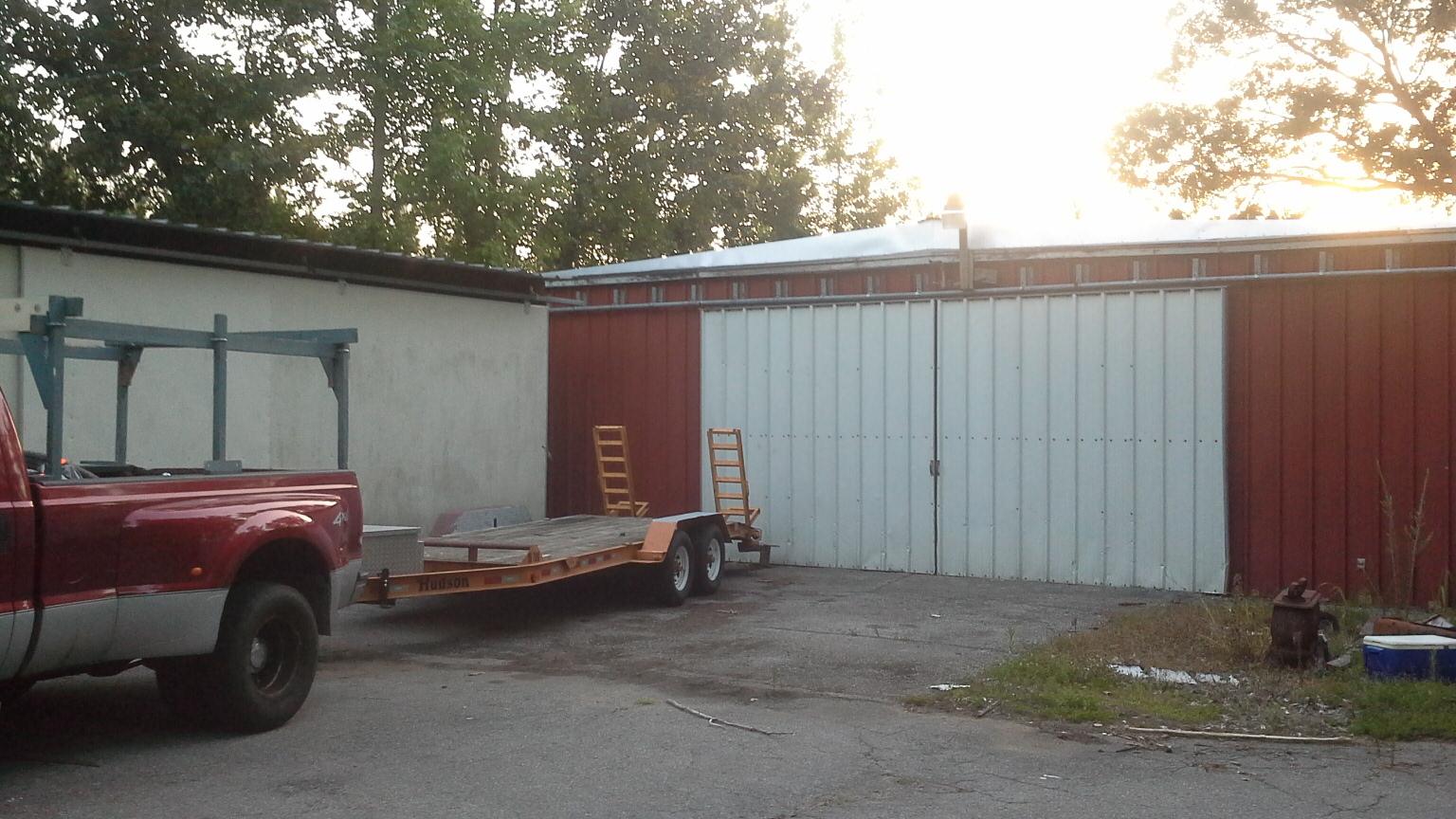

You are in TN, so snowload wont be an issue and as such, I wouldnt worry about the roof pitch.
Aaron Z

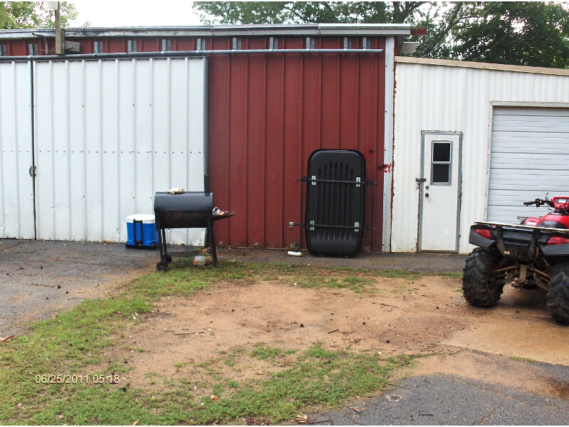

Like I wrote, you need some slope. My big shop's roof pitch was slight, and with snow/rain load over the years some sagging occurred, which caused puddles, which rusted through.
Before, I think there was like less than 6" rise over 20'
Now (apologize for the poor pic) more like a foot plus.
Snow doesn't slide off but rain does easily.
/edit - but Tupelo has had an 8" snowfall in 1940 and a 6.2" in 2011.
