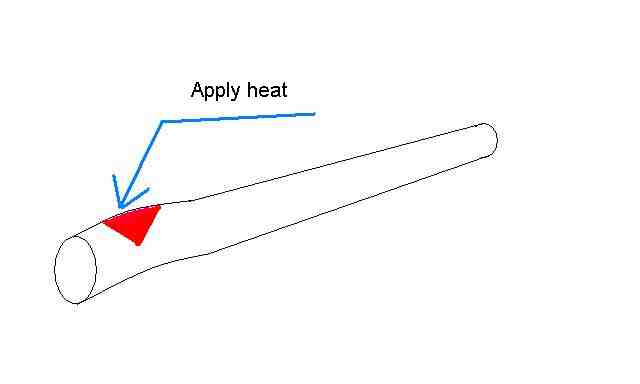

Aluminum can be heated and straightened easily but there is a fine line between when it's hot enough to bend and melting. When the aluminum starts to melt it doesn't do it in slow motion. It's kind of like "poof" and it's gone.
I found that it's a whole lot easier to find that spot where it bends, but doesn't melt by using MAPP gass instead of Oxy/Actelyne.
I'm no expert, but I've had to straighten my boat bimini top poles more than once :( You'd think I would learn.

Thomas, that's funny, I am an electrician but I don't have the ability to bend 3". They have a bending table at the refinery where my brother works. This flagpole is 24' long. I was hoping that I wouldn't have to take it anywhere. Thanks for your help.

I know that dents in shotgun barrels are frequently straightened by using an expanding plug on the inside.
Could you do something similar here with 2" or 2 1/2" iron pipe inside the flagpole.
At a minimum a piece of iron pipe inside the pole would prevent too much of a collapse or wall buckling while you tried another means of straightening it.

Make a couple of V blocks out of 4x4s and rest the pole in the blocks with the bend facing up. Maybe about 4' between blocks. Slide it under your tractor and use a hydraulic bottle jack to push down on the bend using the weight of your tractor.

You have a hydraulic bender on your tractor. Block up the mast, secure it so it wont spin and center your FEL over the high point. Gently down pressure.
Make a few angle iron brackets to set your pole in on the pressure points, when straightening. This will help keep you from putting any kinks in it. I have spent most of my life as an autobody technician, before I became a tractor dealer, and still do some auto body repair & painting.

Please excuse the crude drawing! :eek:
Apply the heat in the top of the crown, in a round to oval shape; bring it down the side of the pole in a "V" shape, let cool to the touch! If not enough after it is cool, do the same thing but a bigger oval on top of the crown, and a bigger "V". If you go to far, do the same thing, but on the opposite side. First try heating to a dull red.
