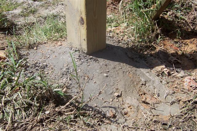

Can someone please explain the difference? In Ohio it is recommended that the posts be set in concrete. In Texas the posts rot out if set in concrete.
When I do a fence, it really depends on the soil conditions where I'm working. If it's sandy, or loose soil, then I have to use concrete. If it's good, red clay, then I'll tamp them in.

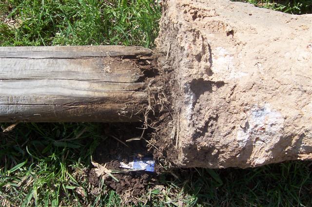

Here is a picture of a residential post that I replaced. It was sandy soil, and the previous fence builder just dumped the concrete in the hole, and let them set. They lasted five years like this.
The thing that I do differently when I use concrete is I build up the concrete so it's above grad and angles up the sides of the posts. After it's dried, the concrete forms a ramp of sorts to shed the water away from the post.
In my experience, pressure treated posts will almost never rot in the ground, but always rot at grade. The water sits there, keeping the post wet, and after awhile, cylce of being wet and then dry again will break down the wood.

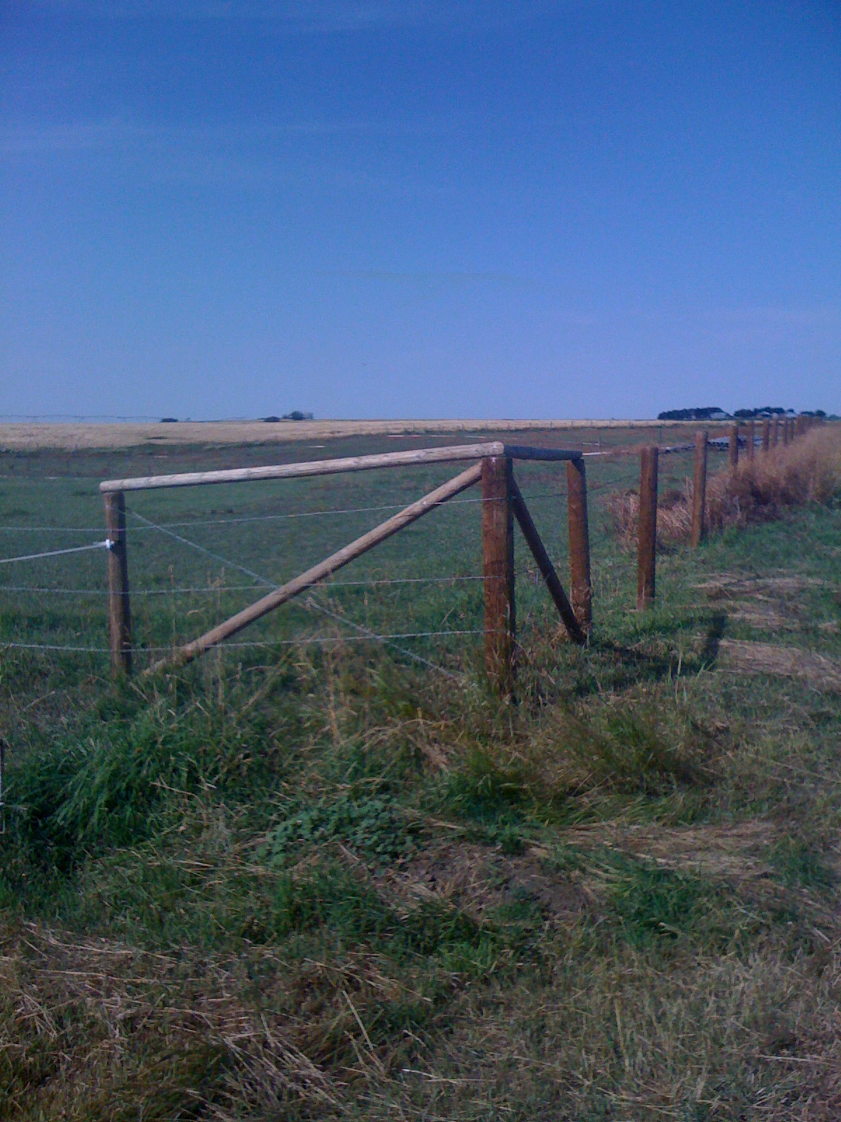

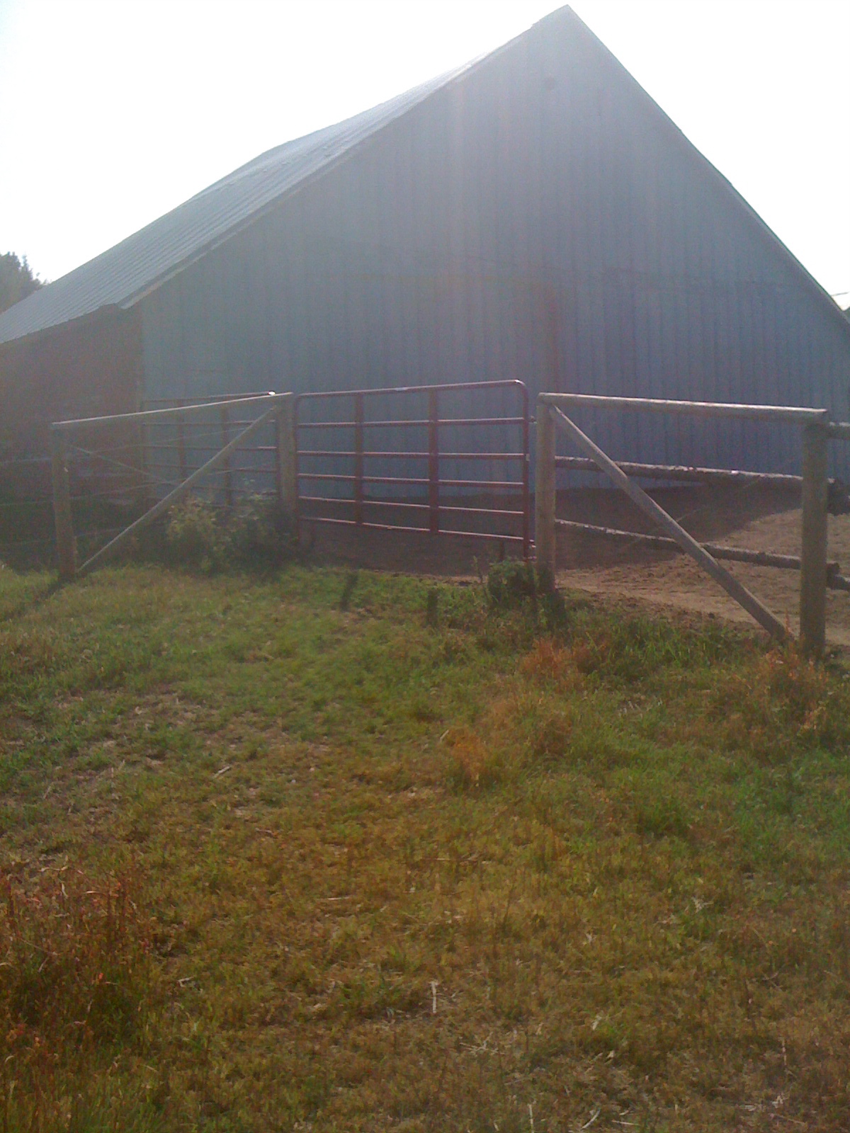

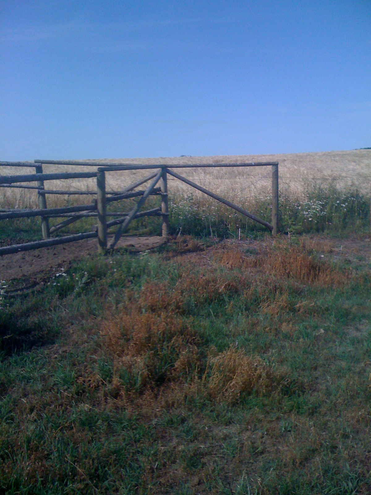

Here's a couple pics of how I braced my 90* and 45* corners. No concrete used, just tamped in. Line posts are 2' in ground and corner posts are in 3' deep. This setup has been in for a touch over 2 yrs and have very minimal "lean" on the posts. High tensil barbless wire all around and is pinned tight at each corner post. So essentially each line is independent and ends at the corner posts. Even used the same technique where the wire meets the rail and post corrals, and gate locations. Hope this helps.

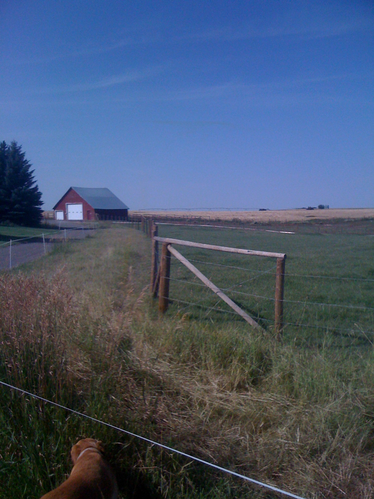

I appreciate all the replies. I am still pondering what to do on this.
Breaking the shallow corners into two straight sections of fence seems like a good solution at the cost of disassembling the fence section, which I have to do no matter what, and then adding two more posts. Since I am planning on electrifying the fence I guess that means there will be some extra splices to move the current from one section to another.
