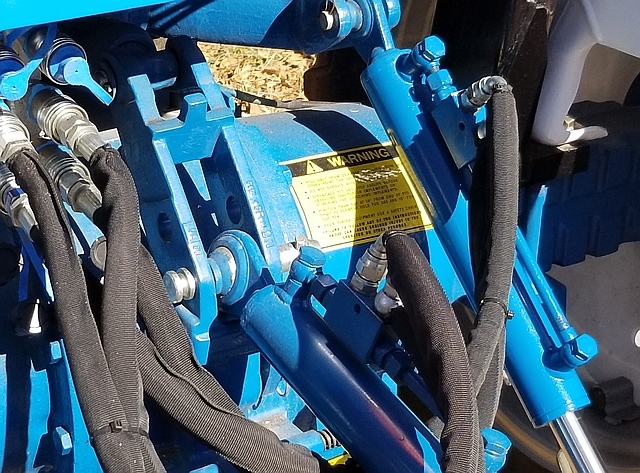

I bought one of the Vevor top links to use on my back blade. I haven't installed it yet though. I'll need to make some brackets and new hoses to reach but that's not a problem. I have the banjo fittings, hose and machine to do it. They're 3/8" BSP bolts. You can get the fittings in 1/4" or 3/8" hose. My fittings came with the bolt and two copper washers so I'm set when that project works it way to the top of the list. ;)
Forgot to mention: You can also get BSP to JIC fittings and use 90 degree JIC fittings. My Ford uses those so one hose runs over the other.
