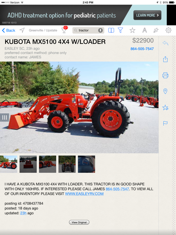

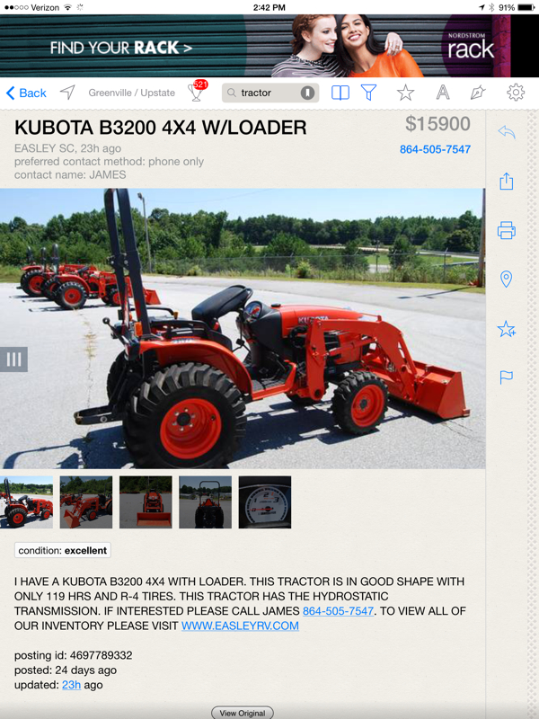

Consider it a gift to yourself! But you should be able to achieve what you need for way less. For example here are two in my area.
Then get a cheap riding lawn mower and a rotary cutter for $1500 ish. The other things can be used.
