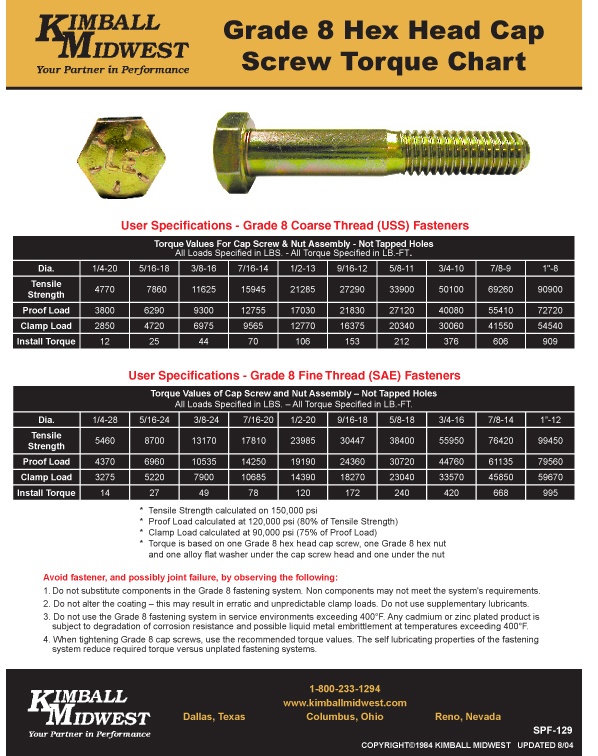

   / I keep breaking bolts #15
How about, as suggested earlier, making sure the bolts are at proper torque before modifying? :eek:
A chart is attached.

Good thread with lots of smart guys. Everyone should have a torque chart somewhere close by.
