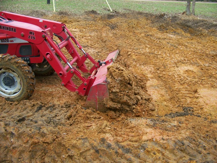

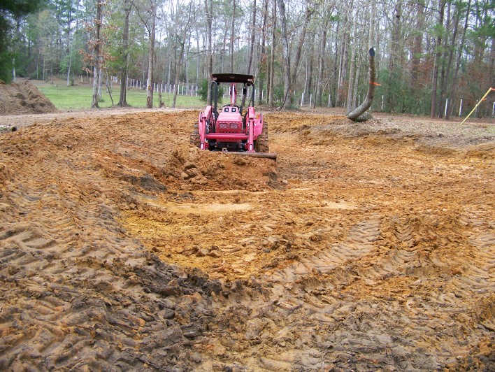

So sorry your thread veered off the subject. Here's a couple of photos of me pushing clay, like a dozer with no tooth bar. Get the angle of the bucket just right and damp clay will roll off in front of the bucket. It's slow going, but a tooth bar would do it better.View attachment 368090View attachment 368091
If you can't get your old pond dry enough to muck out with your loader bucket, you can contract it out to an operator with a long reach excavator.
hugs, Brandi
I wonder about the tooth bar in the clay muck I will be working with. I am going to get one just because there are some other uses for it and if it works on this job then great. Thanks for posting about your mucking. I almost overlooked because of the off topic stuff but kind of enjoyed the humor. So perhaps we have a good bit of both worlds, information sharing and respectful humor. This thread may die on the humor side since for my part I will not get going on this thing until late summer but I will report on things I have done to get ready.
ROADeere,
Two summers ago I rented a Bobcat mini track loader to finish the pond's depth, as my tractor's front tires were sinking it under load. The Bobcat rep told me if I was digging I would need a tooth bar bucket. He explained without a tooth bar, digging in dry dirt can bend (or warp) the cutting edge. I told him it will be in wet clay. So I used a smooth lip bucket and all was fine.
hugs, Brandi

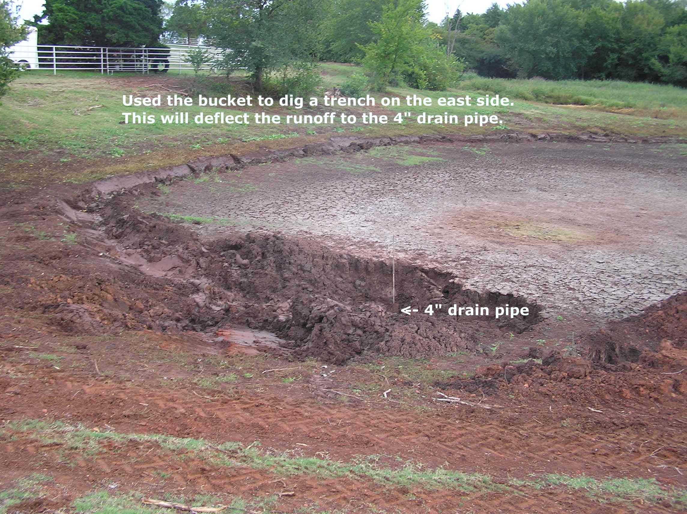

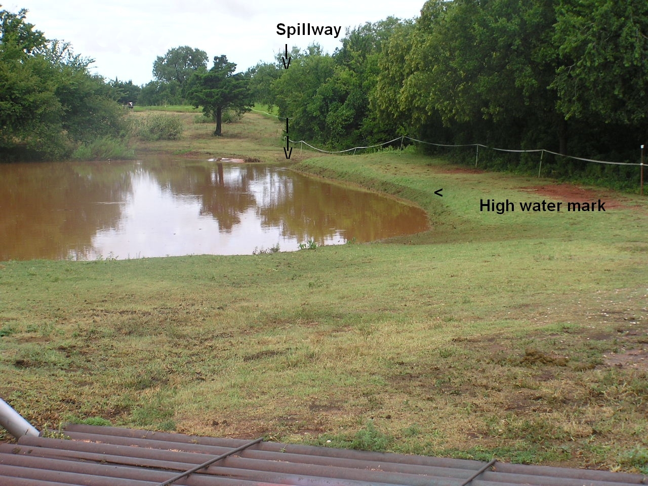

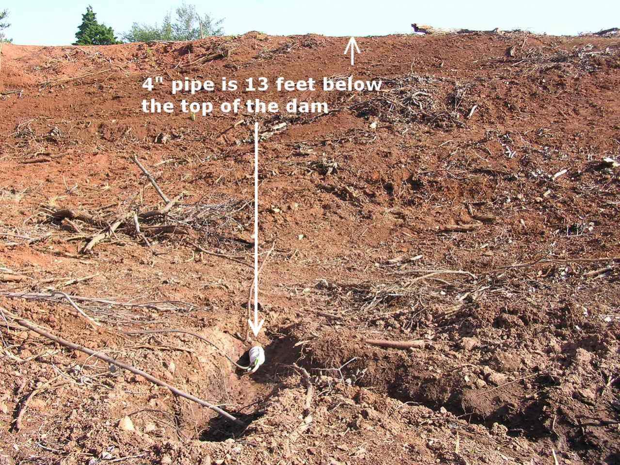

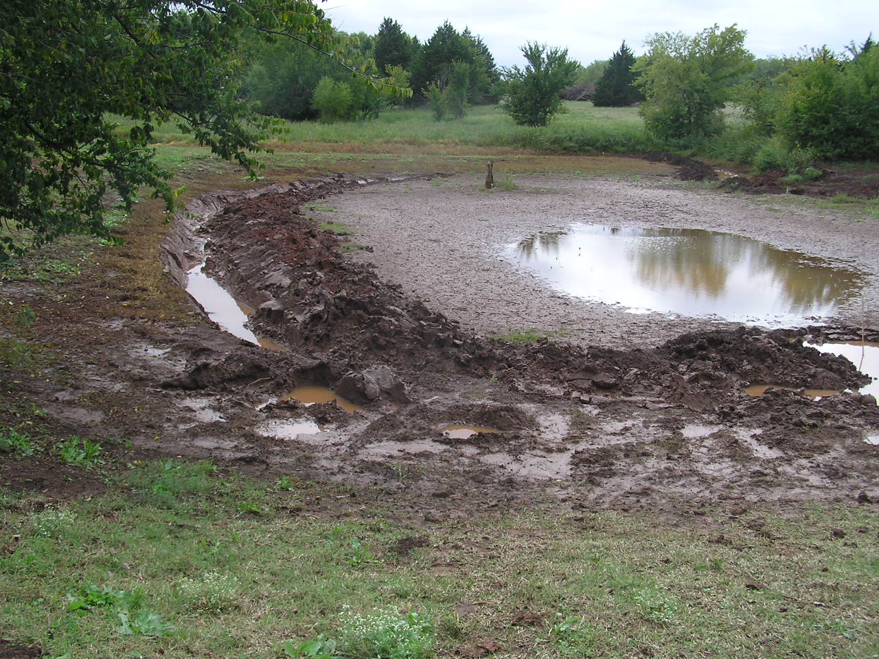

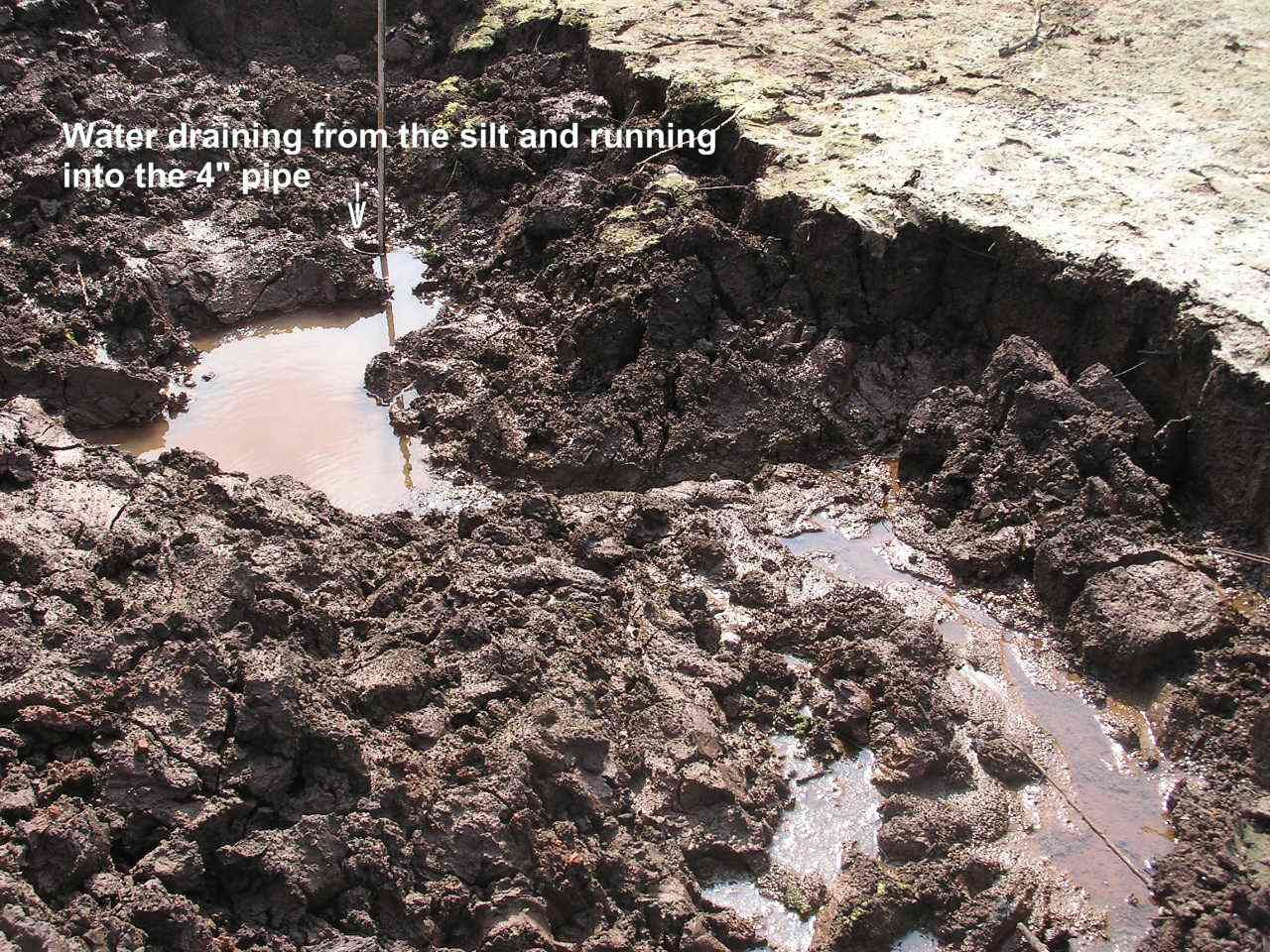

How are you going to keep the water out of the area that you are removing dirt from?
I removed silt from an old pond, but it had a drain pipe installed under the dam.
Read #307, down to post #313: What's the MOST FUN Thing to Do on Your Tractor? - Page 31

Thanks for your input. Those pictures are helping keep me working out my approach. I have been thinking of whether to cut the bank, a project in itself, or plug in a couple of sump pumps. I believe the sump pump can handle the task during the drier months. The idea of digging or ditching around the muck to keep it high and dry was also creeping into my thinking. One thing I have wondered is how a cut in the bank will work out. I am sure there would have to be some careful packing or else it might just soften and blow out if the pond fills very fast such as in a major rain season.
Did you put the drain in after the fact or was it already in the pond as constructed originally. Maybe you answered that already. I will take another look.
Your project looks pretty exciting but I have to temper my ambitions a bit from what could happen with those impressive machines. But the technique could well be the same. My key, I believe, is to get it dry some way and then just dig, dig dig. :laughing:
