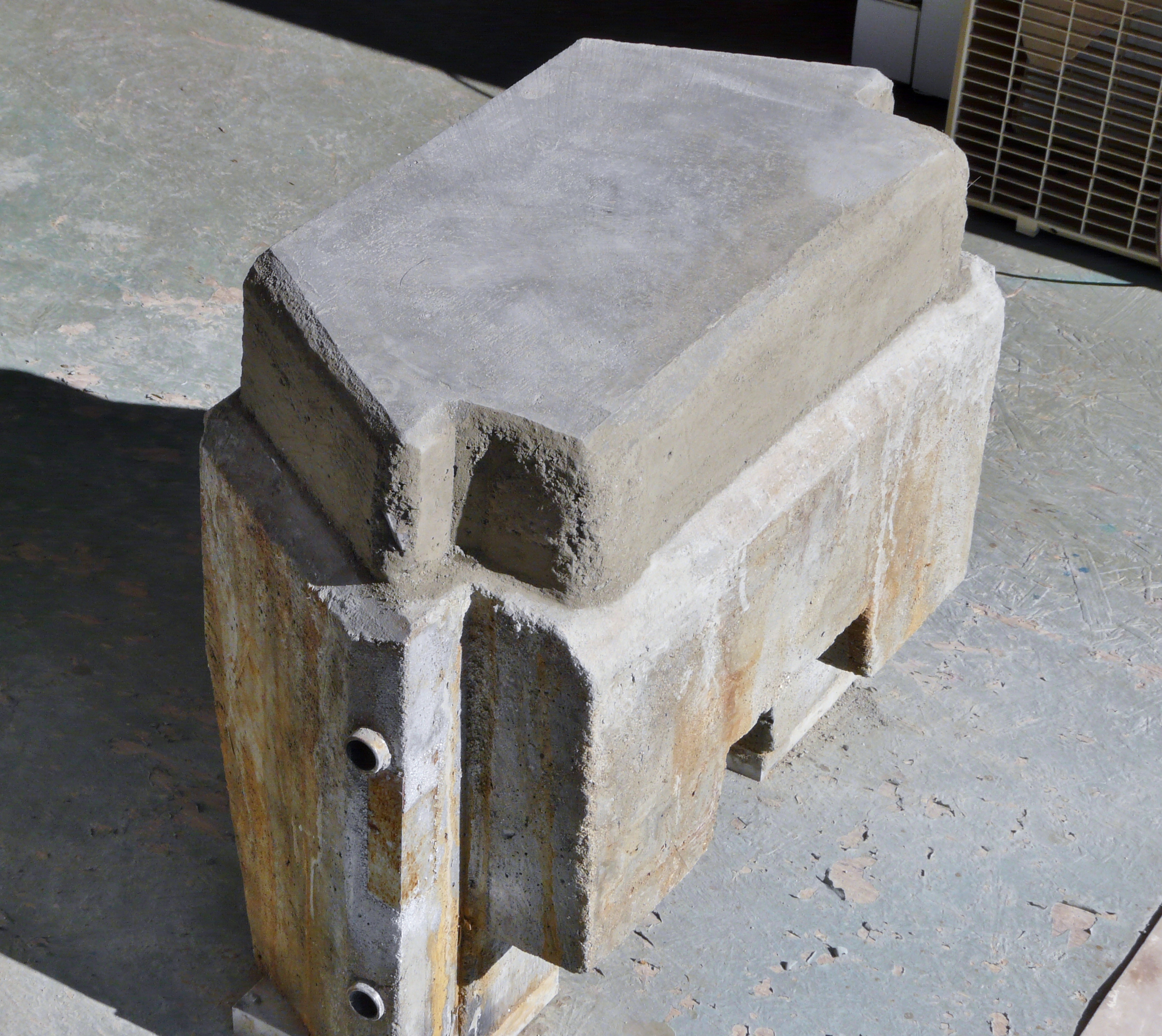

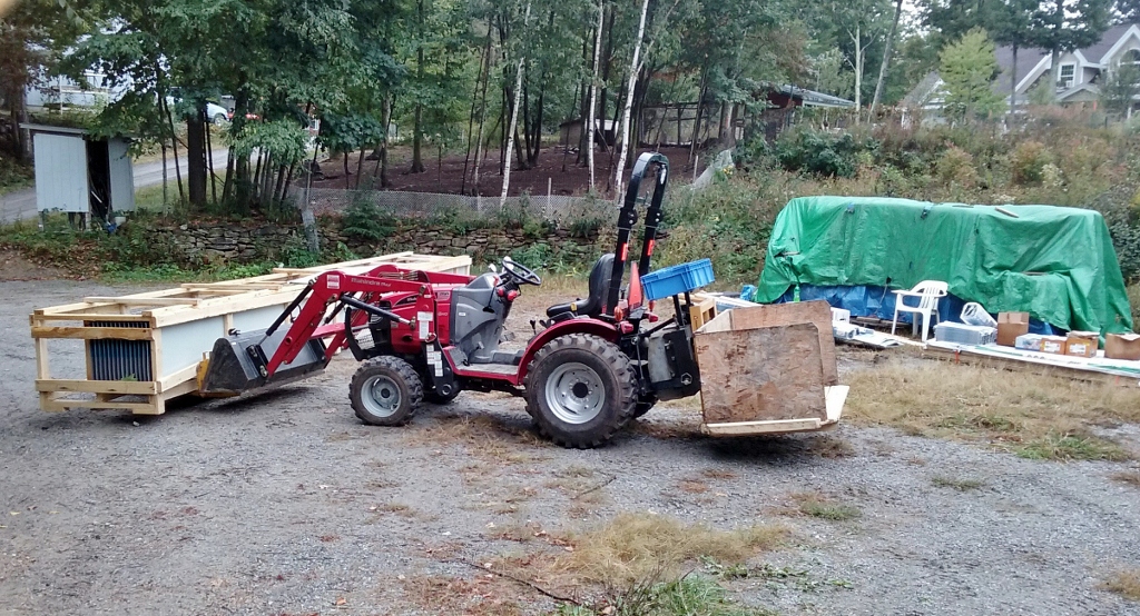

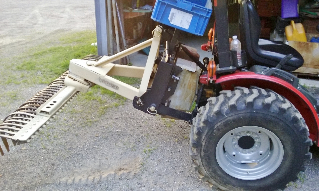

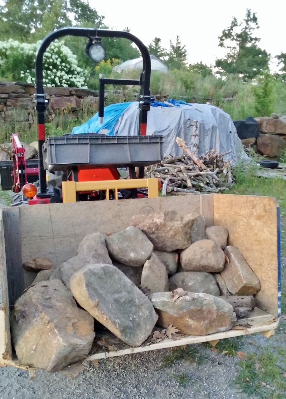

Except when I need PTO this never comes off, filled with steel, about 700 Lbs.
