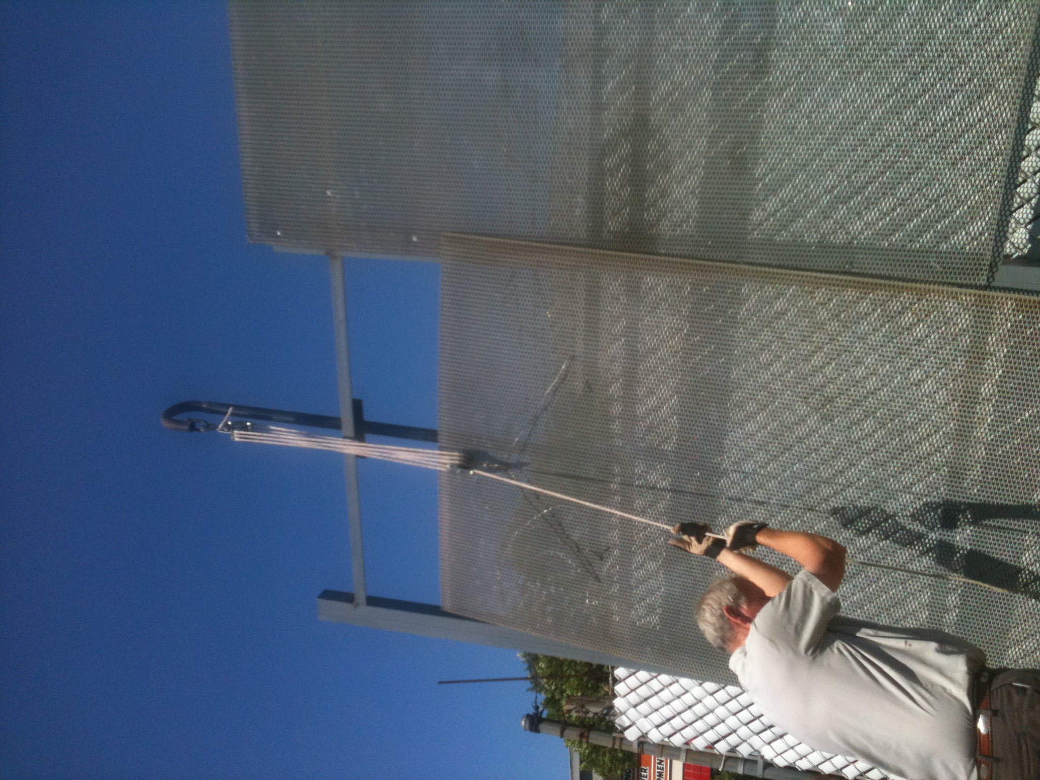

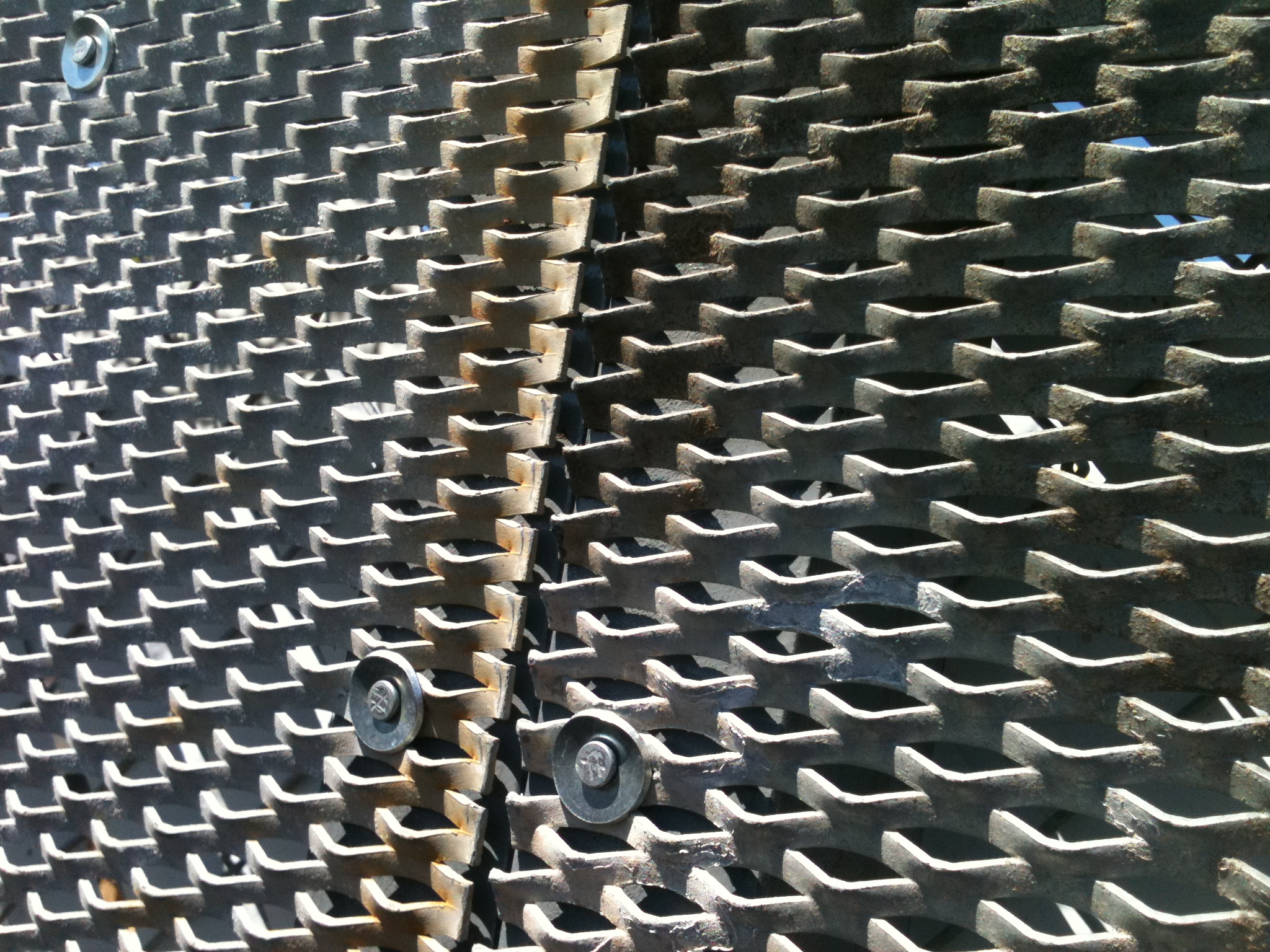

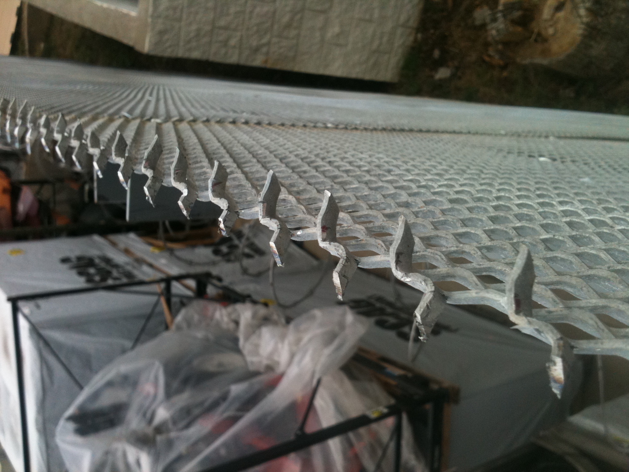

Some years ago I built a wall around the storage area of a lawnmower shop. Bad guys had cut the nine gauge chainlink and walked off with some equipment, chainsaws mostly.
This was my solution. And as of the other day, seven years later, bad guys haven稚 returned.
Expanded metal. What痴 neat about this particular pattern is you can稚 really see inside if the openings are angled up.
Powder actuated fasteners to steel framework does a couple of things, one the only way through is with a cutting method and itç—´ faster than drilling and bolting or using tek screws.
The top edge was a personal statement from me to the bad guys.
Oh, 11 feet high using 2 X 4 X 1/4 inch angle framework, never an issue in the wind, got lucky I guess.
