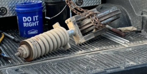

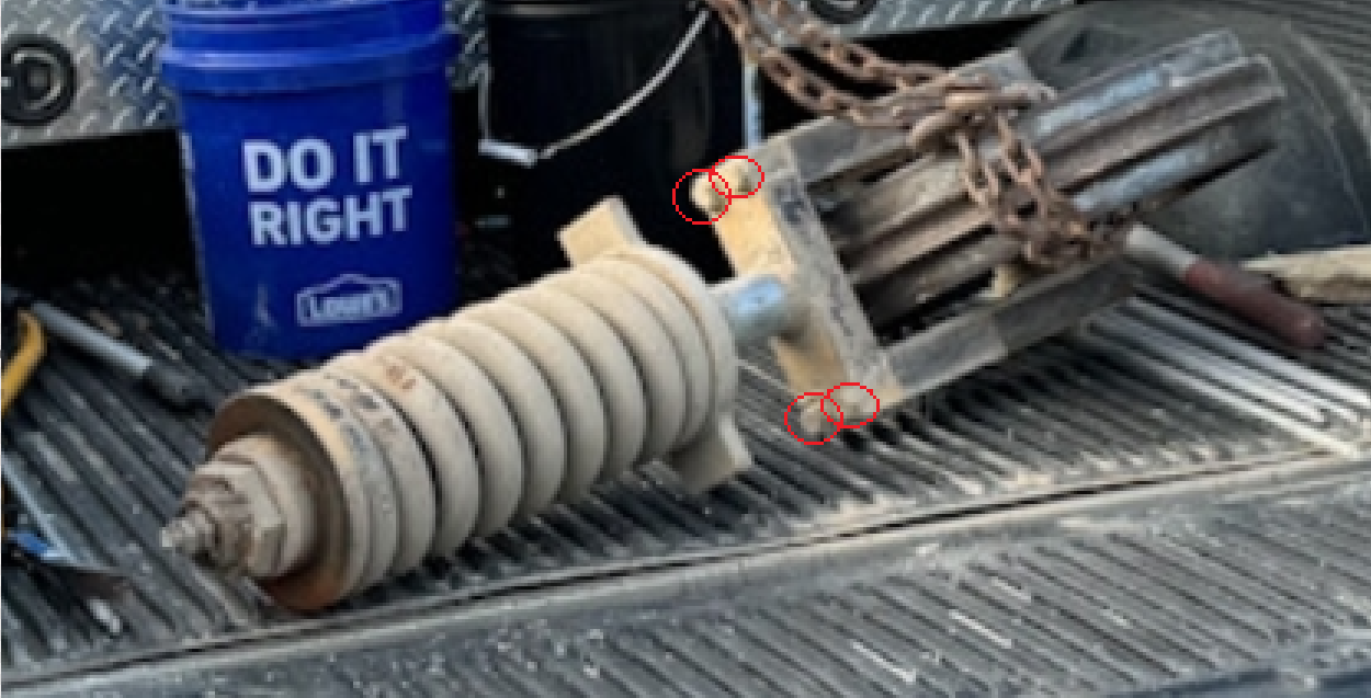

I lost the track on my Komatsu. How do I fix this?
   / I lost the track on my Komatsu. How do I fix this? #31
Does that mean you took the big nut off?
#32
Big nut is undisturbed. I’m not trying to get hurt. I have a short list of shops to call tomorrow to try to find one to handle it.

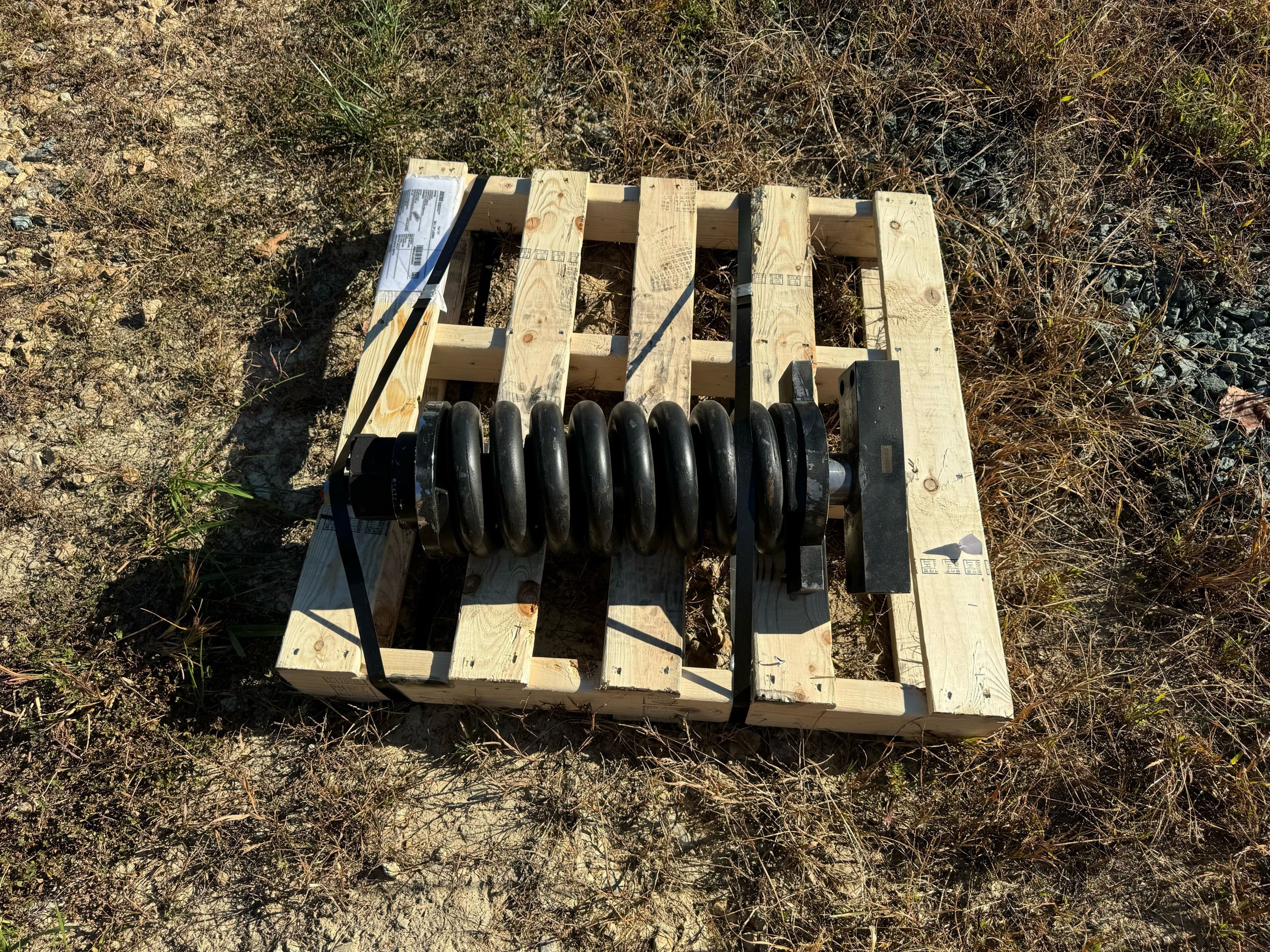

#33
I surfed around and found Conequip.com. Called them and they had the part for $850. Free shipping. Estes truck just left. I have fence to build this weekend so I will probably be picking at this here and there truing to get the nuts loose and separate the old one. Then next weekend, go after the rebuild.
   / I lost the track on my Komatsu. How do I fix this? #34
Good luck with these nuts
   / I lost the track on my Komatsu. How do I fix this? #36
I feel your frustration every time the pry bar slips, or doesn't move the track as intended.
