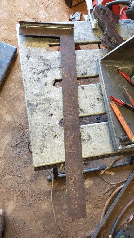

I made this simple guide for cutting straight. It was just a builders square.

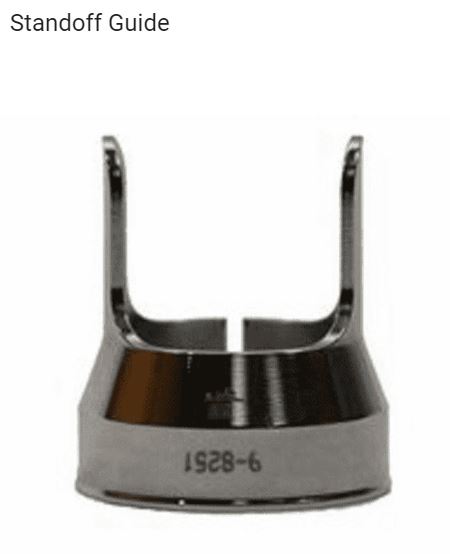

Team it up with this stand off guide it worked pretty good.

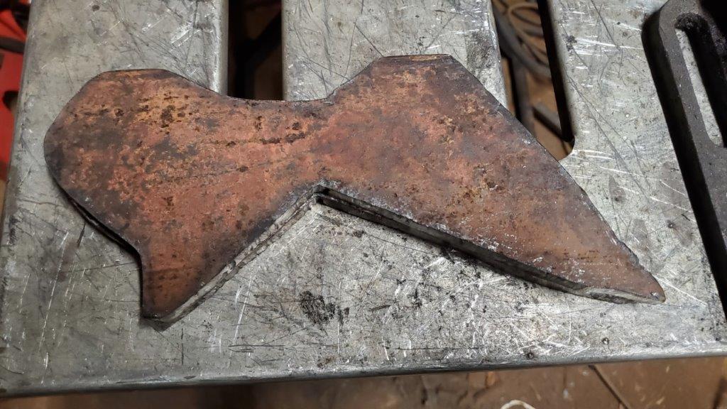

I cut these brackets free hand they cleaned up well. This is the first thing I have cutout free hand.
