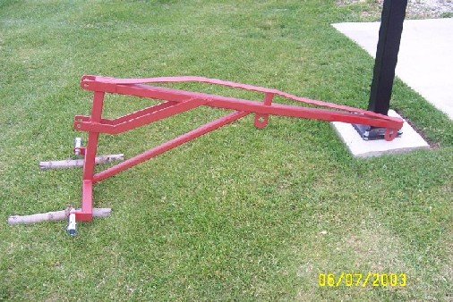

I also modified my boom pole to make it iMatch compatible.

Good looking boom pole. Would you mind sharing where you purchased it and how you made it I-match compatible?
   / I-Match Quick Hitch Pallet Forks #14
Sure Bebster, I bought the boom pole at Tractor Supply
in Galesburg, Illinois for $70. Of course I put quick hitch
adapters on the lower pins which I also bought at TSC
I think they were about $15-$20. The boom pole
came with just the upper link attaching point. I bought
some flat 1/4 inch steel at a local steel shop. We heated
the two flat pieces with a torch, bent them and then
welded them in place to make the upper connection point
fit the iMatch. Oh yes, I think the boom pole is a Wallace
brand ( I don't know if I spelled that right though)
