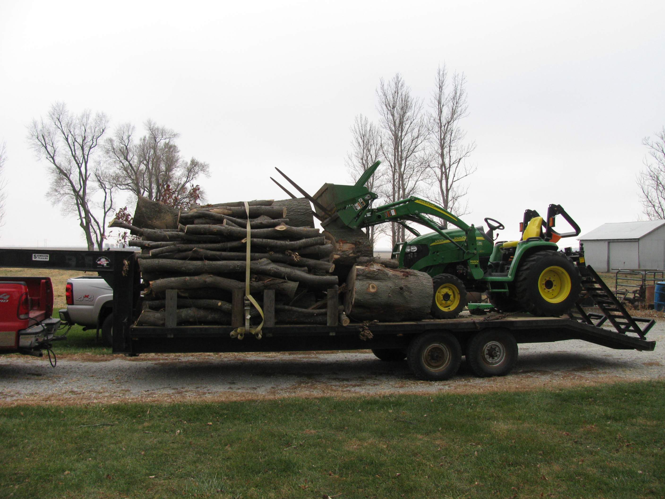

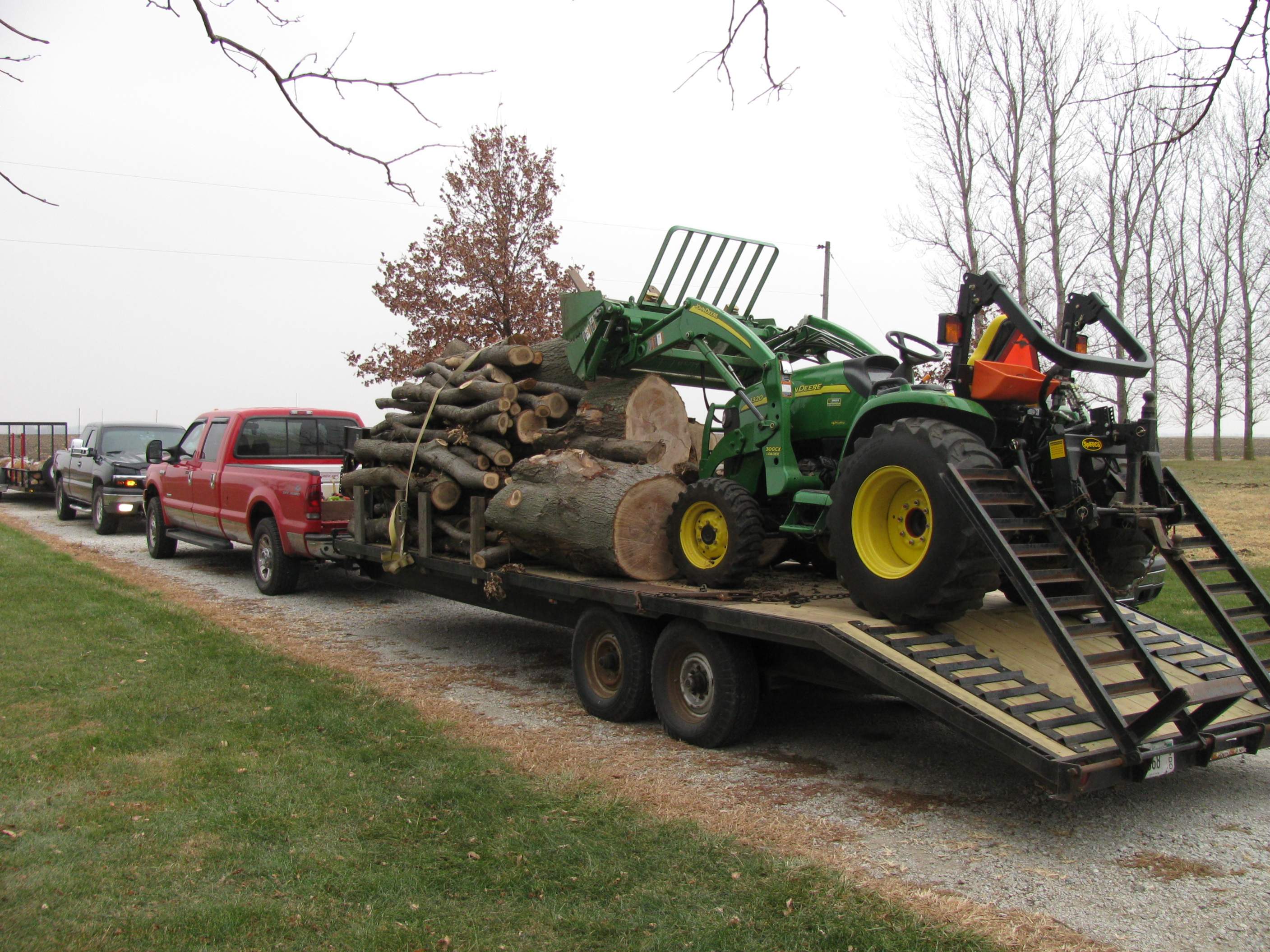

I have had a Frontier 5' 4in1 on my 3320 for a couple of years. I would no get a 6'. It is great for picking up that last little bit of rock or dirt and moving brush and limbs. I would not use it to pull stumps or pick up loads sticking out the front. I take great care not to do stupid things that might spring the bucket but I don't baby it. I have never owned a grapple so I can't advise on that. Everything loaded on my trailer was put on with the 4in1.
Dan
