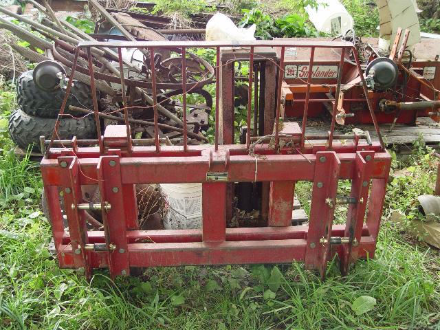

In response to my original post:
I stopped at TSC today (Tractor Supply Co.) and looked at their carryall attachments. They have the usual King Kutter brand which is rated for 1,000 lbs. Well, I already bent up one of those, so thats no good. Then I saw something else. They have a 3 pt square bale carrier that looks just like a carryall except the arms are 40 in apart as opposed to 25 in apart like on the carryall. It's rated for 2,000 lbs. This would work great if the arms were'nt so far apart.

Jerry,
I haven't actually tested them side by side, but I would think that you gain some strength from the round tubing (if the wall thickness is comparable to that of the angle). However, the attachment method of the cat1 lift pins looks to add more strength than that of the tubing itself. Not only is there no hole through the frame to compromise the integrity of the frame, but the mounting tab for the cat1 lift pin actually reinforces the frame. This seems to be one of the major failure points from the picture you posted. Keep in mind that the tab does nothing to strengthen the angle stock forks, so you still need to keep the center of gravity of the load as close to the frame as possible to shorten the torque arm that your load uses to stress the implement. For seriously heavy loads, solid lift truck type forks would be much preferred.
Jeff
   / I need a bigger 'you know what' #46
Re: I need a bigger \'you know what\'
That looks like it will work, Jerry, but what's the maximum lift of your 3PH? I think you would want a carry-all that's rated for several hundred pounds above your lift capacity. I'm guessing that the TC30's lift is about 1500#, so that might be the perfect carry-all for you. /forums/images/graemlins/cool.gif

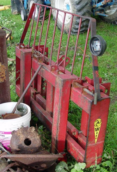

#49
Hey, it looks like the solution was being hammered out right in front of my nose in the attachments forum. 3 pt Pallet Mover .
King Kutter DOES make a heavier carryall called a 'Pallet Mover', its rated for 2,000 lbs as opposed to 1,000 lbs for their carryall. My store does'nt have one in stock, but that's what special orders are for /forums/images/graemlins/laugh.gif
#51
Mike, I cut out the bent up section and patched in a new piece of the same material. I'm not going to reinforce it, I'm just going to relegate it to lighter duty chores. I have the heavy duty pallet mover on order. Pallet mover (2,000 lb capacity), shown below.
