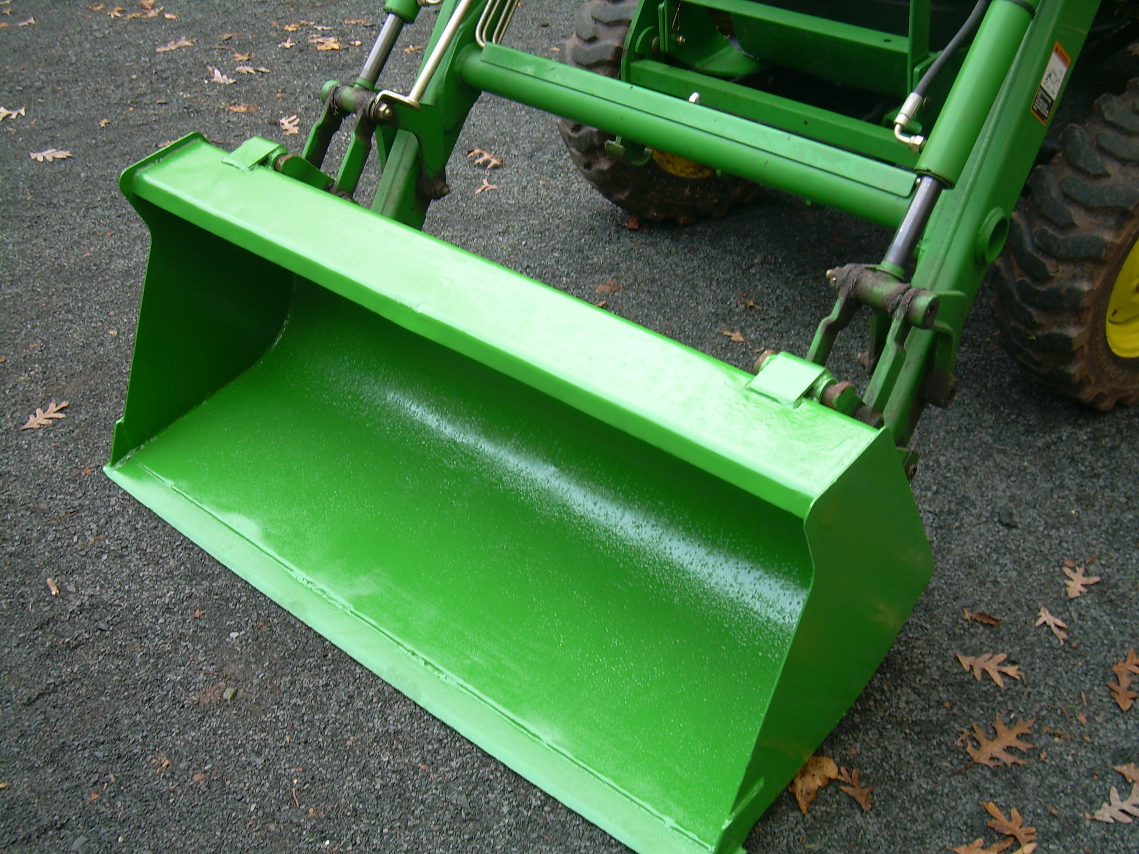

out of curiosity... what loader & bucket does your 790 have?
My 790 has the 300 loader and the 61" HD bucket with cutting edge,
   / I need a bucket!
#12
Nice looking steel and stick machine :)
2 buckets are better than one, if you can afford it, each for it's specific task, but....
How about bringing to a welding shop and have them widen it to the happy medium between high volume snow work and heavy dirt work.
Just a little bigger to cover your track, that would solve some of the PITN problems, like converting to QA or trying to sell your old bucket, trying to locate a bigger bucket etc.
Cost would probably not be to bad??? I've cut buckets and plows down with no problem, making them bigger will be more work but should be doable at a reasonable price, at the same time you can reinforce the top of the bucket.
Just a thought, worth a stop at a welding shop to ask, Good luck!
JB.
Hmm...i'm liking this idea.
Thanks everyone for all the input! I'm not 100% what the next step will be, but maybe the universe will maybe show me the next step.
FWIW, i did actually put a tape on the bucket last night....not 54".....48" !!!!:ashamed:
   / I need a bucket! #13
48" is pretty much worthless for your loader.
I made a 48 out of a beat up 60 because I thought I might use it for something, but so far in 3 years have not.
Just call every dealer you can find and ask them if they have any older buckets, if you can find one cheap enough, would be easier than widening it.
I got the 60" bucket I mentioned above for $100. like I said it's easier to shorten them than to lengthen them though.
JB

Exactly! i'm glad someone else sees that too...48" was a stock item though i just learned...(lame)....
i cannot believe you scored a bucket for $100....holy heck
   / I need a bucket! #15
Well it was a beat up light duty bucket, and this was a dealer that caters to to a white collar market so they probably figured it wasn't gonna be very much in demand.
To bad I didn't save the pieces I cut off, that would of made it easier if you did bring it to a welder to widen.
JB
