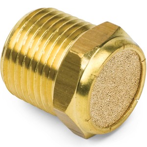

Sorry to resurrect such an old post, I was wondering, LBrown59, could you point me to some detailed pictures of your vent setup? I see a short pipe and two 90s, what's on the very end? Thank you.
Looks like a brass vent plug, there are several different styles.

Where can I find these vent Looking for an online supplier as I need a few 1/2 & 3/4 inch NPT for some of my equipt Thanks in advance..........bill
