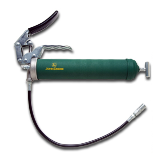

Nothing too expensive I hope, just a manual grease gun should do.
I had one before I owned the tractor and it would ooze oil anytime I stored it. Grease is designed to stay put and is easily sealed with o-rings so even though it felt heavy and solid I suppose it was cheap?

Ive been using a Lincoln 1134 for years now. Great gun.

Yes. But it is a grease gun after all;)
It doesnt ooze or leak when you pump it or store it if thats what you mean.
The type of grease used can make a difference too. Some grease really sheds oil in the summer heat, while others hold their oils in suspension just fine, others act like lard on a stove and go right to a liquid state. A grease gun's seals are designed for thick grease not thin oil and even the best gun can leak oil out the tube if the weather gets hot enough and the grease releases it s oil. Better quality grease usually doesnt go as oily as the cheap stuff.
What type of grease are you using? I usually use this Lubex EP Gr.2 :Irving Quality Lubricants & Specialty Fluids :: Grease Bearings Its not that expensive, nor is it some fancy "boutique" grease made by a specialty refiner, but is a decent grease used by probably 60% (likely even more) of the heavy equipment operators in this area.

I use the pistol grip gun from JD. I think it runs about $25-30. I have two of them and I've used them for years.

Lots of good points on grease above, but consider this. Some grease is designed to "bleed". they work well in sealed bearings. Some are not, they work well in pin joints. Grease is a combination of an oil (wich can have a thick or thin viscosity) and a "soap" base. The base is normally lithium, most common, or calcium for higher temps. Sometime other additives are added like graphite or moly. For sealed bearings a #1 consistancy grease should be used. For not well sealed bearings a #2 with a heavier base oil should be used. For pin joints a #2 or 3 with a heavy base oil and possibly graphite or moly.
OK, so now how do I get by with one grease ? If you are running heavy equipment a lot, you don't. Use the right grease for the right part. For me running a JD on a part time basis and some other small equipment, I use a #2 grease recommended for auto chasis lube. (today these greases provide excellent lubrication in lots of applications). If you use this for pin joints, grease often.
Even a good grease gun will bleed some greases through the nozel, especially in warm weather. The most important consideration is how much pressure can the gun produce to free up and clean up tough joints. A lever gun is better than a pistol grip and should put out 3-5,000 psi. (You can check with a grease fitting attached to a pressure gage.)
