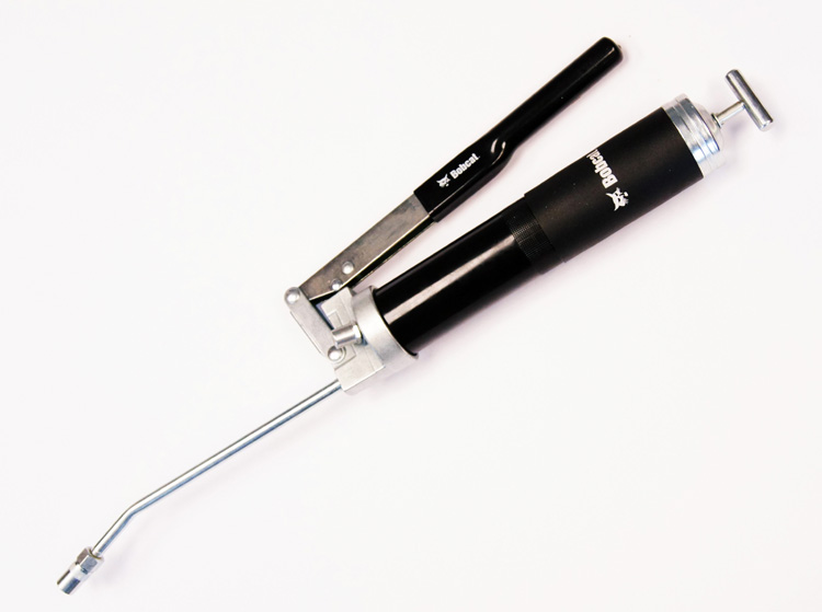

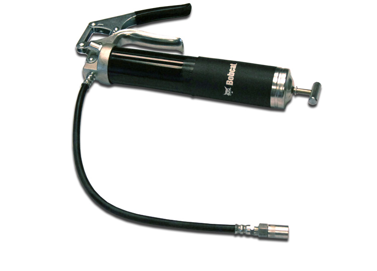

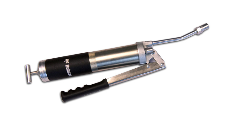

For $9.95 each, I got this one hand GG2.jpg, and this 10" long grease pipe GG3.jpg, from the online Bobcat Store clearance page.
Bobcat Store: *CLEARANCE!*
They also have the short stroke, short pipe model GG1.jpg, for $9.95.
No leaks so far. :thumbsup:
