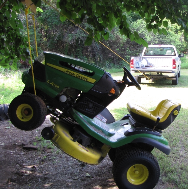

For an authentic shade tree approach this works for any mower and there isn't a storage problem with another piece of bulky equipment in the way the remainder of your life.
I'd sure want the wheels chocked and a couple of jack stands under the deck. Without them, the strength and condition of the rope and the tree limp are the only things between you and a disaster.
