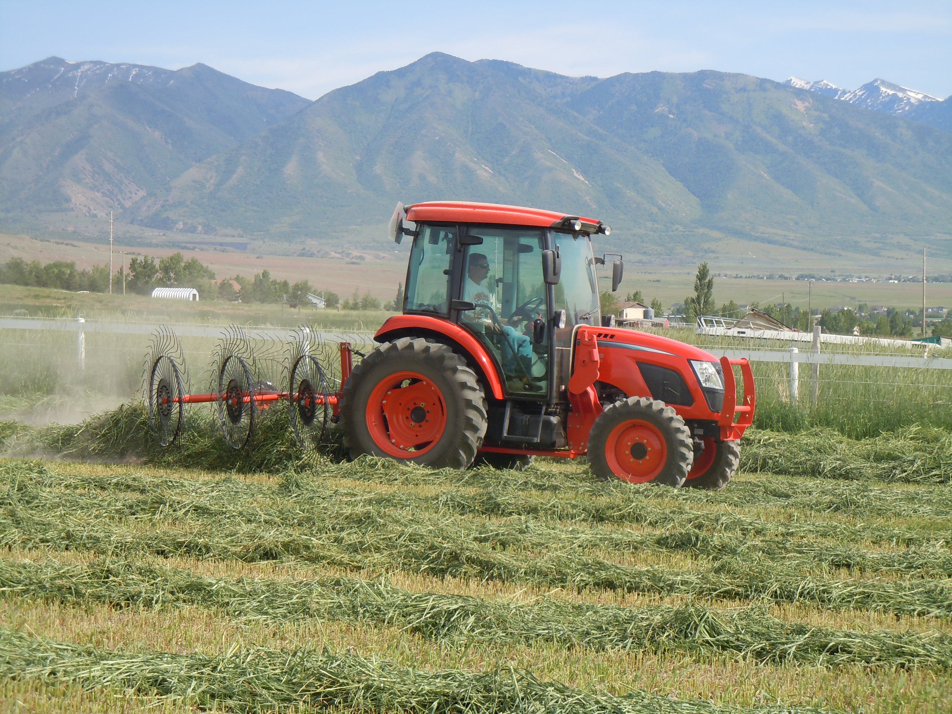

cat fever, what a great view you have there...
Thanks, I do enjoy the view especially in the winter.
