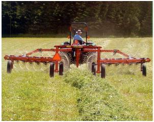

My H&S Hi-cap 14 wheel rake will leave a few stalks of Johnson grass if I have rake spread out to rake 28' but it leaves a lot less JG stalks when I pull it in to only rake 19' because when pulled in to 19' the angle of rake wheels is a lot less.

Looks like we are talking about the same type of critter. My thoughts are that my basket rake is made for light grasses which is where the JD parallel bar is most efficient.
However. After Tx. Jim's comments, pictures, and background deserves, the sharp angles he mentions is the secret to it handling heavy loads which means if you are going to do more than move over one WW, the width of 1 WW you need lots of baskets and run them at a sharp angle.
