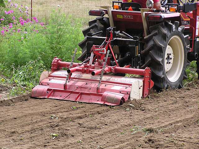

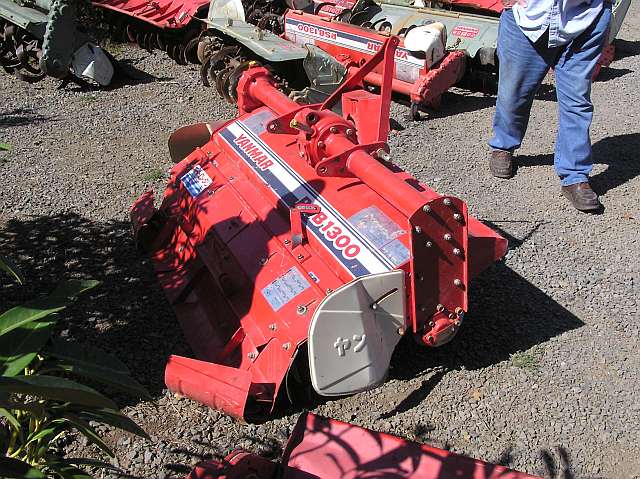

I've been very pleased with my Yanmar tiller. Was in very good condition and is so quite I sometimes have to turn around to make sure it is running. Since I also have a Yanmar tractor, I've got my tiller set-up to work with the UFO controls which auto control depth and tilt. I paid $600 a couple yrs ago. Oh, there are numerous variation of Yanmar tillers including a shuttle offset model. Many of the models have rear mounted adj guage wheels that can help control depth.
The pics: What it looked like as received from Japan, the tiller in action in the garden & what the UFO does to control out of level conditions. Will maintain level when ground is +/- 10ï½° off level.
