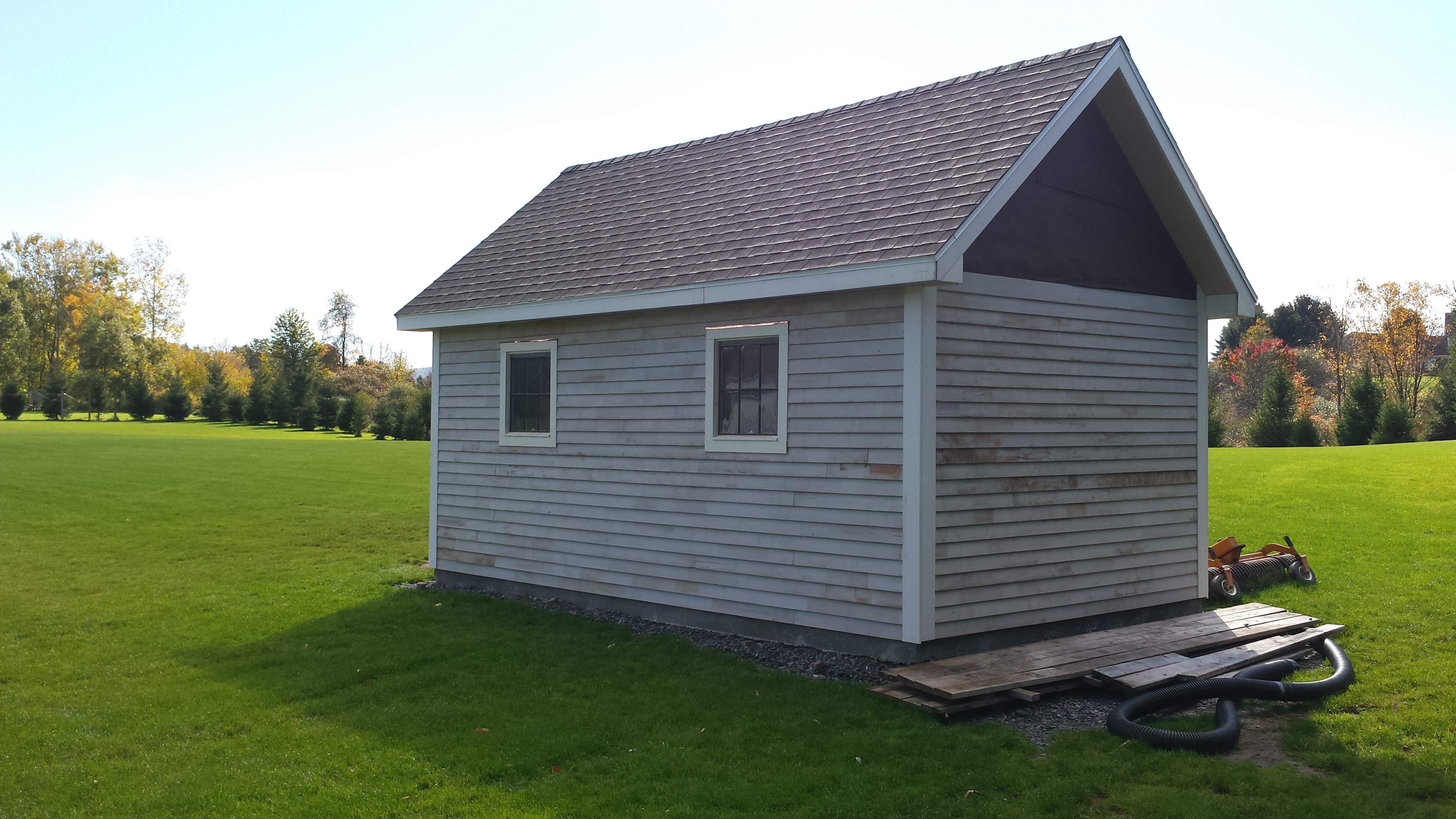

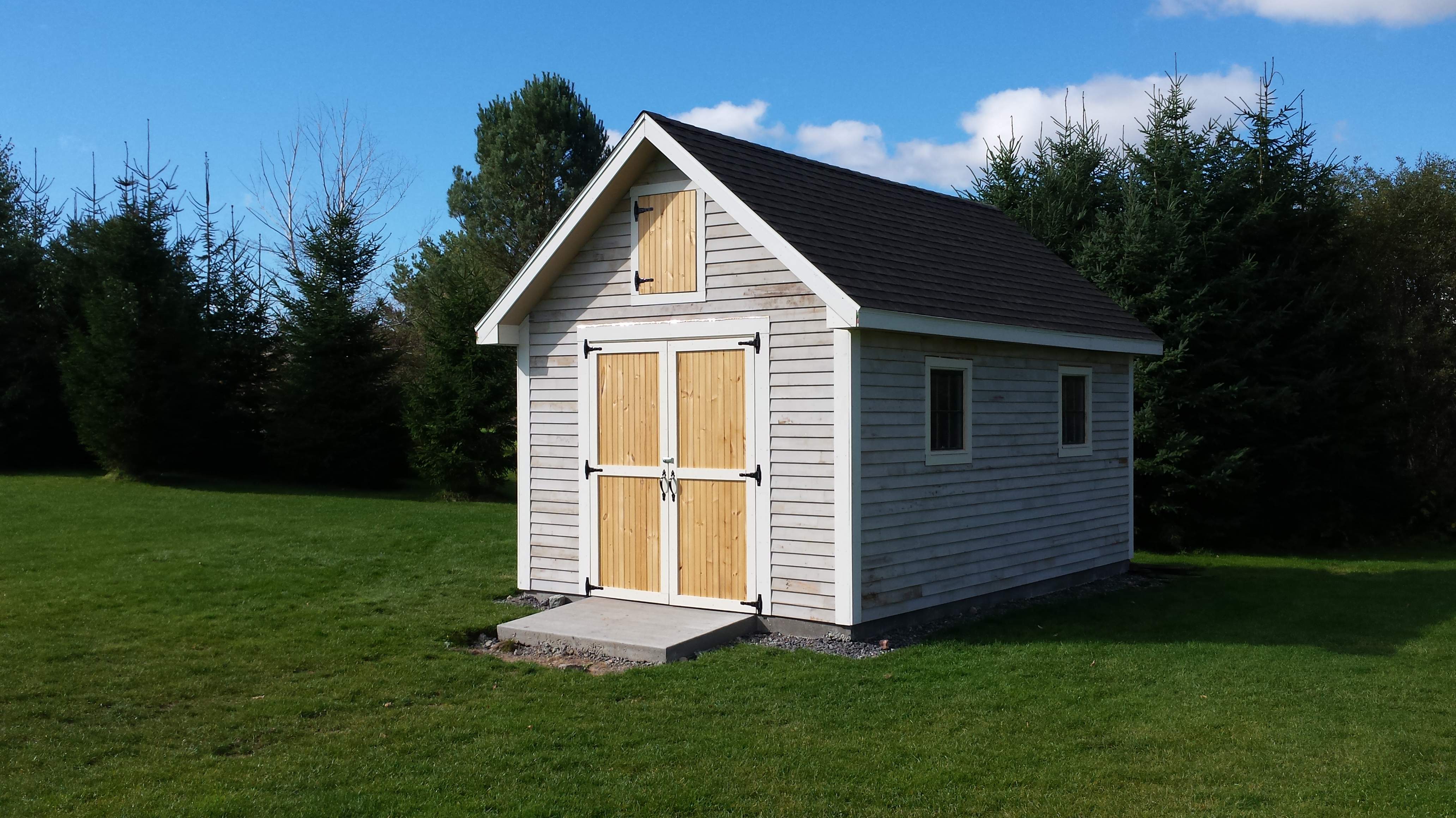

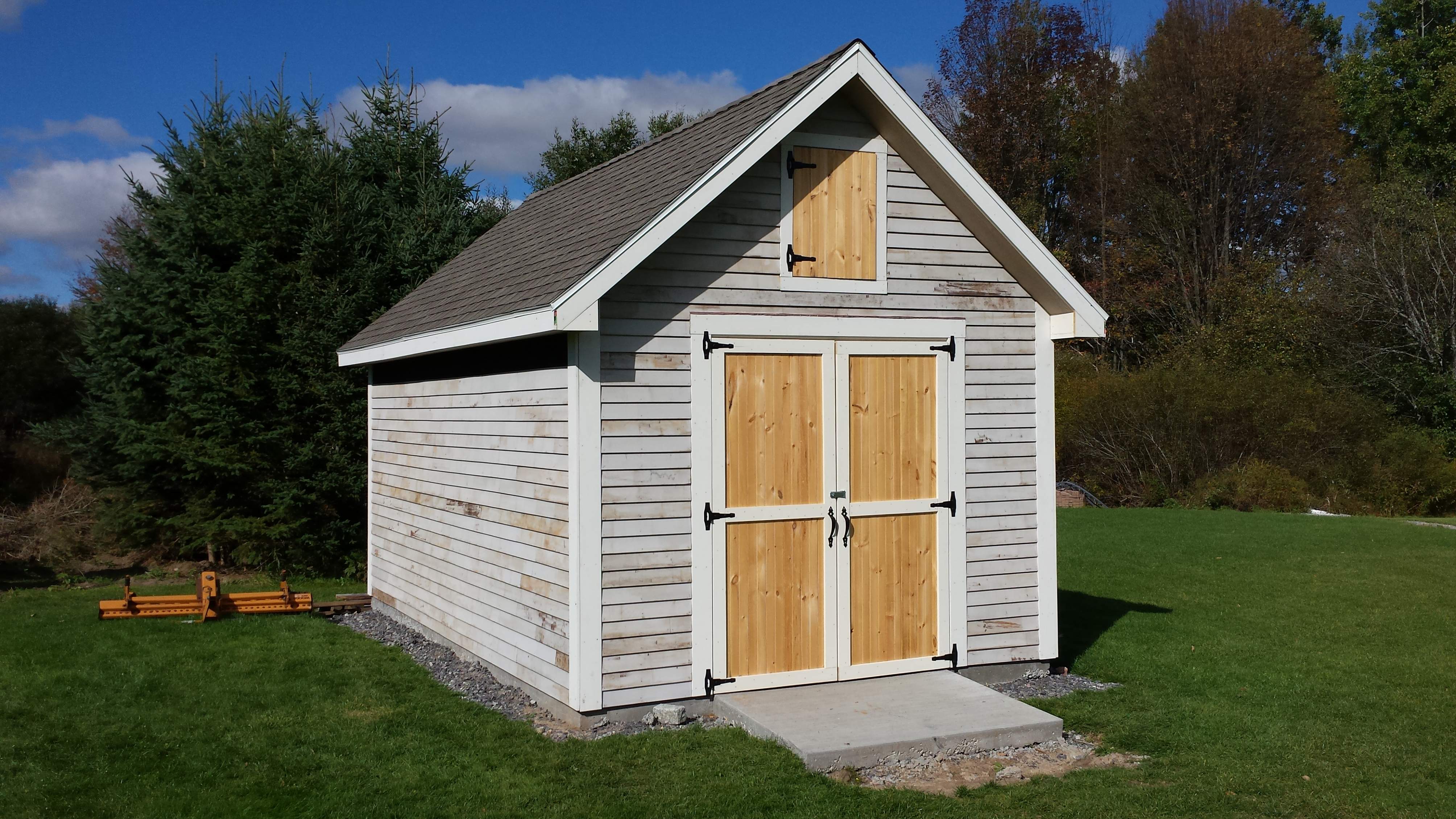

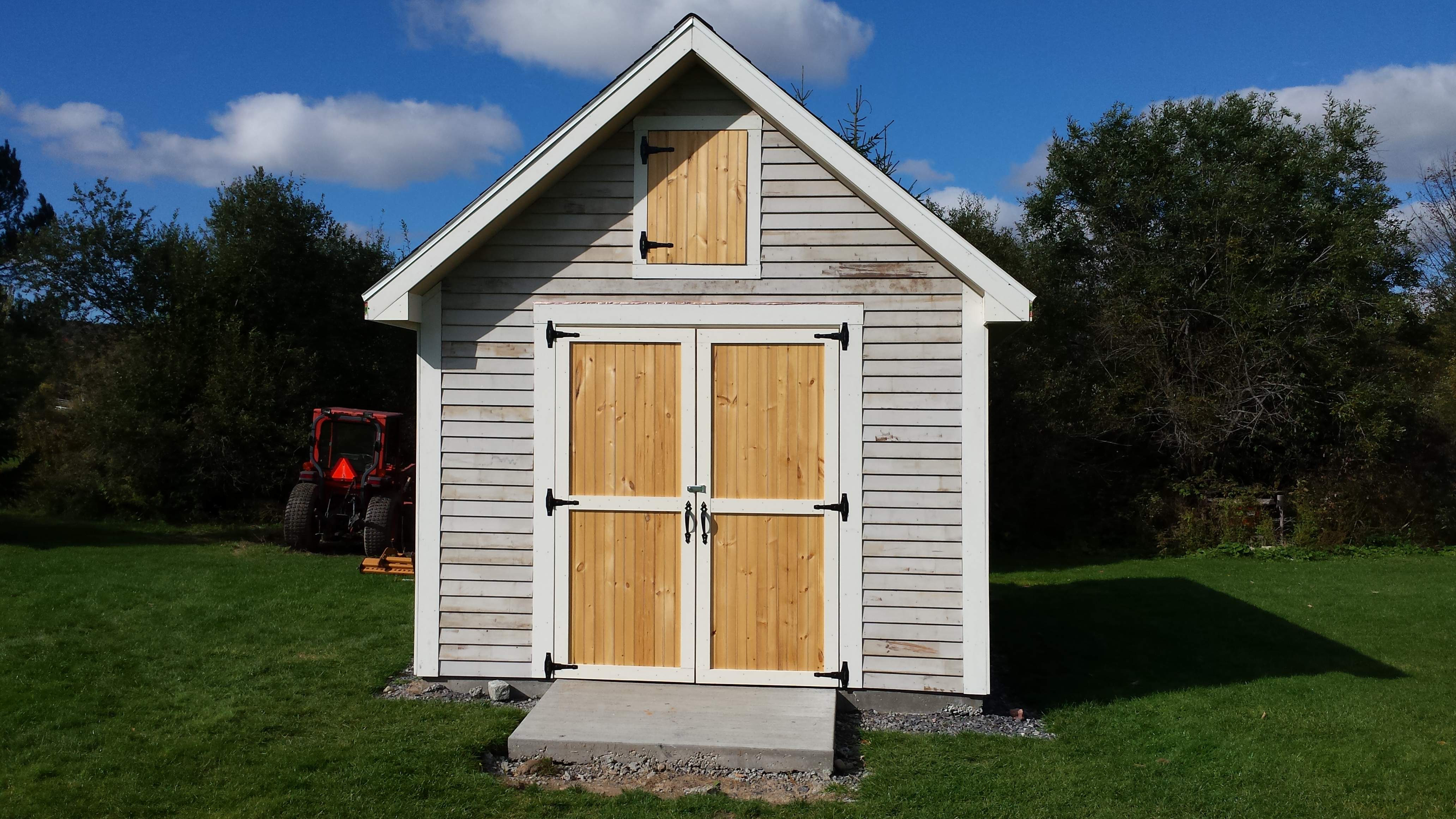

It has been a couple of weeks since I updated the thread so I thought I'd post a couple of pictures from this morning.
I found some cedar clapboards on craigslist, they are new but have been sitting around for a while as evident in the pictures. I knew I'd need a little more but buying the old material saved me about $1100. I'm probably not going to get around to painting until the Spring.
I have to wait until tomorrow to pick up the rest of the siding that i need.
Kevin

   / I need a shed. #56
It has been a couple of weeks since I updated the thread so I thought I'd post a couple of pictures from this morning. I found some cedar clapboards on craigslist, they are new but have been sitting around for a while as evident in the pictures. I knew I'd need a little more but buying the old material saved me about $1100. I'm probably not going to get around to painting until the Spring. I have to wait until tomorrow to pick up the rest of the siding that i need. Kevin
Looks great. Nice you were able to find the items on CL. :thumbsup:
   / I need a shed. #57
Looks awesome!
   / I need a shed. #58
Even if you aren't going to paint right now I would at least caulk the heck out of it to make it water tight.
   / I need a shed.
#59
That is a good point. It is supposed to be warm this week so I'll try to get that done by the end of the week.
