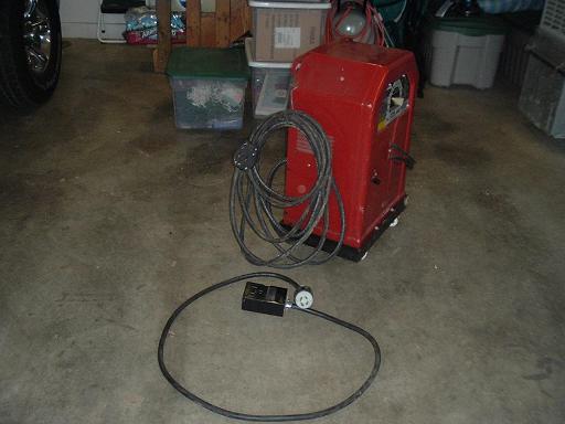

   / I need a welder.... #25
Cool, good price. You need to figure out which female plug your generator has and then which male plug your welder has. The wire between the two plugs needs to be capable of handling the amps of the generator. You will find the wire labeled as flexible extension cord. It only needs three conductors since that is all your welder needs but it will be confusing because your generator plug actually has 4 prongs. Get one of those electrical friends to make the adapter pigtail since you need to know which of the four wires to leave out.
I'll repost in a few with my adapter photos.
   / I need a welder.... #26
Here's the welder and cord.

   / I need a welder.... #28
I have new found respect for this thread today. I hooked my Lincoln AC225 (HD $240) to my Generac 7550EXL (13500 surge watts). I made an adapter cable using the receptable called out in the Lincoln manual and the plug identified in the Generac manual and 20 ft of 10/4 cable. I live off grid, so this is my only option. I suspect if I hadn't tripped the generator circuit breaker 1000 times, my project may have taken half as long /forums/images/graemlins/grin.gif
Actually, this was my first time ever using a stick, and if memory serves, my last welding experience was oxy/acet torch about 50 years ago when I was in 4th grade.
Can't say my welding is even close to your quality, but I think it improved over course of the day.
Tomorrow I will post pics of the completed project (paint is drying) probably Here
David
