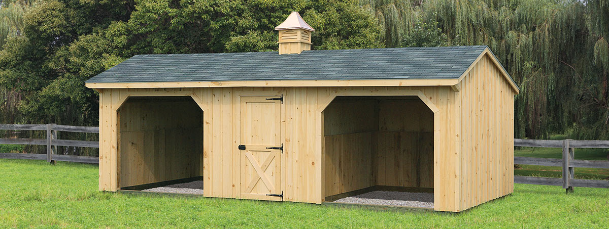

   / I need advice on building a horse barn/shelter
#9
This is similar to what I'm thinking if I go with the simple idea of just creating two open stalls and a storage room in the middle. I'll make the stalls bigger then show in the pics and change a few things around, but overall, this seems like a pretty good starting point.
Your thoughts?
Eddie
   / I need advice on building a horse barn/shelter #10
We keep three horses out year round with a three sided run-in shed. We also have a barn with stalls. As mentioned sometimes a horse may have to be stalled so they can't run for a brief amount of time do to lameness. We board horses. From time to time we will get a horse that doesn't like another horse and will not let it in the run-in shed. I have bolted gate hinges to the backside of the shed so that I can hang a gate in the shed as a divider and that has worked for us.
For the floor we filled with "chips and dust" gravel, ran a compactor over it, and carpeted it with TSC rubber horse mats. It makes cleaning the shed so much easier.
