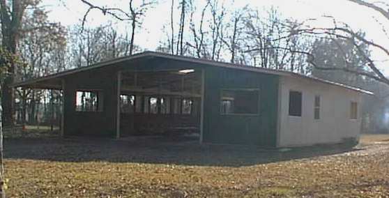

Eddie,

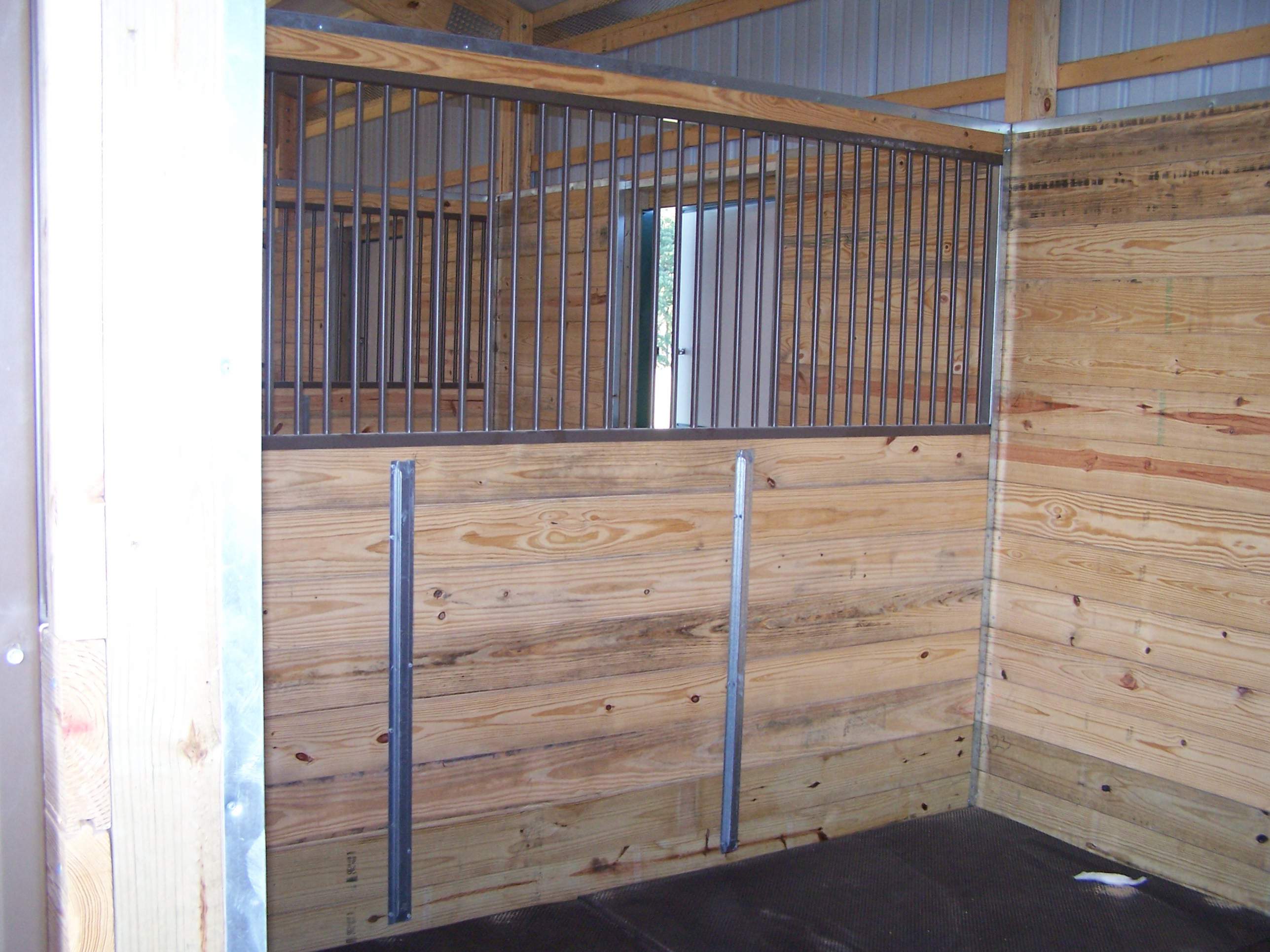

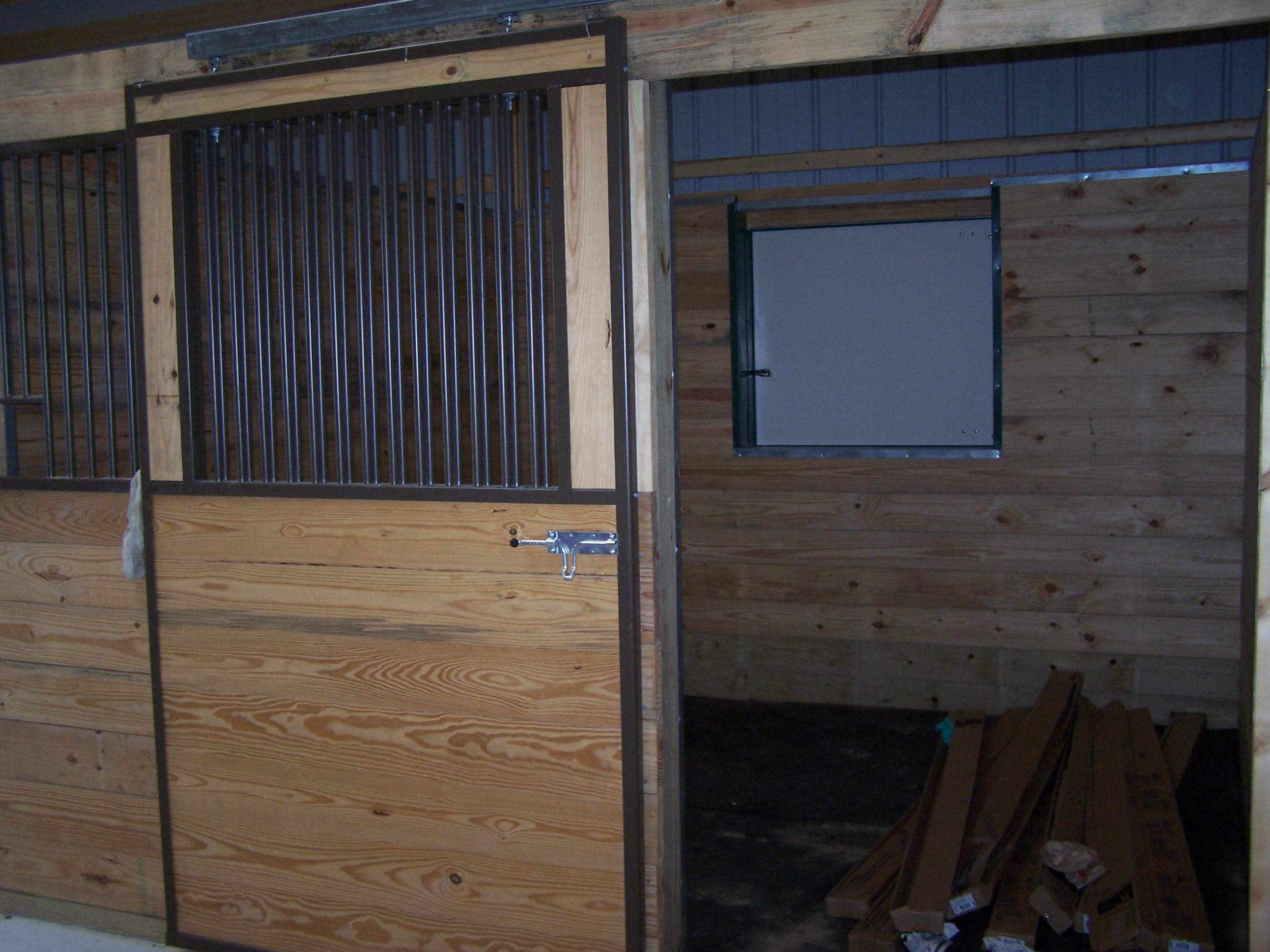

Size depends on how tall your horses will get and temperament. A grown horse can kick through plywood, especially a shod horse and after a few years of exposure to the weather. Then their leg is stuck and they can cut it to pieces thrashing about. Our 17 hand mare is a little claustrophobic and doesn't like narrow or low doors. Stalls and 3 sided loafing sheds are 12'X12' with 10' sidewalls. Stalls have doors that are 4' wide and 8' tall. Our stalls and loafing sheds interior walls are 2"X8" tongue and groove 8' tall. All corners are covered with metal trim to prevent cribbing or chewing on the wood. Stall floors have 6" of crushed rock covered with cushion sand and then rubber mats from TSC. Loafing sheds are bare dirt, the open side faces east. We used a 3:12 pitch so the front is 13' tall and provides good shade.

Randy does bring up a good point. All corners of our soft wood (the posts) are protected by aluminum angle to prevent chewing. They can gnaw through soft wood like a beaver. Our kick panels are oak and we have had no problems with them chewing the oak. Cribbing horses are rare for us although we have had some over the years.

This is similar to what I'm thinking if I go with the simple idea of just creating two open stalls and a storage room in the middle. I'll make the stalls bigger then show in the pics and change a few things around, but overall, this seems like a pretty good starting point.
For a run-in that is a good start. A previous poster said to position it properly. To me that is with weather and sun light in mind. If the horses take a liking to it, it may become a bathroom for them. And, I'd keep the stalls together. Horses like to see other horses. Ours when stalled, stand nose to nose. Put your store room on the end.

I would suggest at least one secure stall in case you have to keep one stalled due to an injury or illness. Line it with good solid boards (I use 1-1/4" rough sawn oak.) We use regular gates on the stalls. The only problem was the time a mare apparently panicked when ice slid off of the roof and she jumped over the gate! I now have a board up high above the gate :)

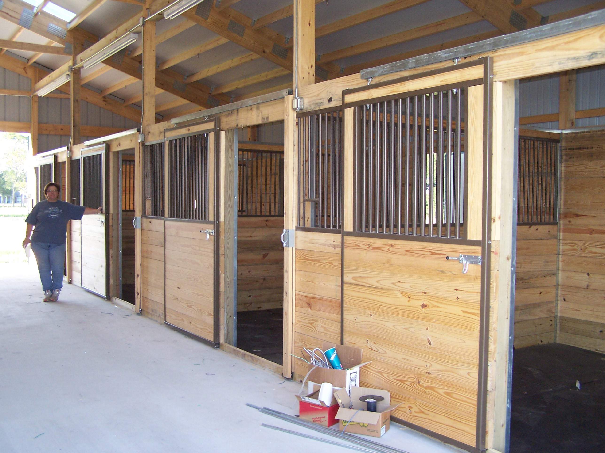

A barn is never big enough. First we built a barn with four 12X12' stalls and a 16' hallway. Three stalls were for our 3 horses that we keep inside at night and one stall for tack, hay etc. We give our horses a little feed each morning and each night so it is essential to keep them locked up individually when they eat so there are no fights over the food. Since we buy 120 bales of hay in the fall to last us through the winter when hay is hard to get and expensive, we had to build an additional 12X12' to keep the hay in.
Two horses will eventually require 2 saddles, at least 2 bridles, pads, blankets, a well stocked medicine cabinet, hoof equipment, brushes, buckets, wheelbarrow, manure forks and shovels, leg wraps, halters and lead ropes, fencing supplies, whips, and dozens of other necessary items, requiring you to add a 12X12' tack room sealed well enough to keep rodents and moisture out. Your 12X12' feed room will also have to be well sealed to keep out rodents and moisture.
Since we use shavings in the stalls we have to buy a trailer load at a time to keep the expense down and then we needed an additional 12X12' room for the shavings. Since horses are addictive we eventually wound up with 2 more requiring 2 more 12X12' stalls. We now have a 60' by 40' barn for the 5 stalls, tack room, hay room and shavings room and a 10'X60' overhang for the tractor, bush hog, box blade and disc all of which you will need to maintain your arena and pasture for the horses.
Yes, you will need an arena and round pen for training. Probably will need lights in them for training in the evenings in winter when it gets dark early. Young horses on pasture need even better fences than old horses so be prepared to do a lot of fence building and maintenance.
A covered hallway area in the barn is essential so the farrier has a place to work when it is raining or too sunny or cold and also needed when you saddle up or groom your horses. My first barn had a 12' wide hallway, my second barn a 14' one and my third barn a 16' wide one. I now wish I had a 20' wide one.
Cameras in the barn with a monitor in your house are nice to have especially when you have a pregnant mare which, for some reason, all women want after they have had their mare for a few years.
Then you need a few hours extra work each week to pay for everything mentioned plus the horse sitter that you will need when you go on a cruise. Is it worth it? Well, I wouldn't give up my horses for the world. :) barn122503A.jpg
