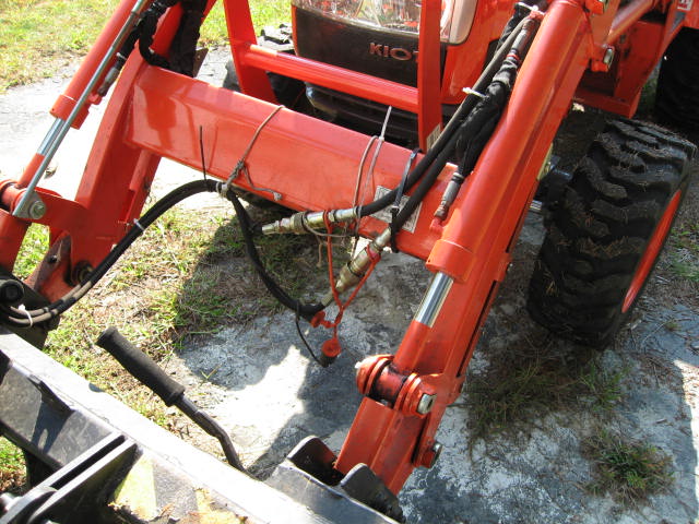

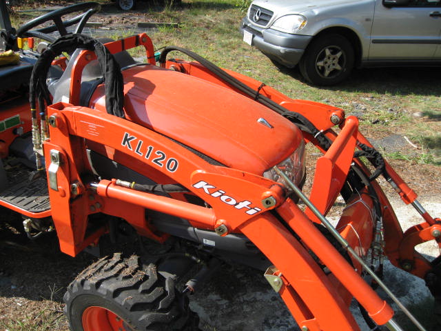

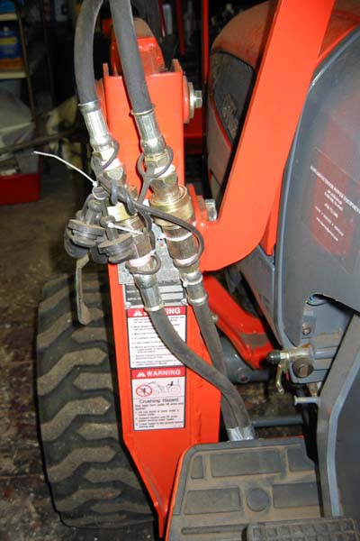

Here are some photos of my "temporary" set up. It works fine and I have done a ton of work with these lines just ziptied into place. What I intend(ed) to do was to put the protective sheathing on the lines and also to fabricate and attach (weld) some brackets to attach the couplers on the torque (cross) tube and also on the FEL post. Note that I have an extra set of couplers on the FEL post which I do not recommend as it is just not necessary unless you are removing your FEL all the time (I've never had to remove mine yet).
Photos might be useful to orient you. Don't be a slob like me and just zip tie the whole thing together (but do use zip ties to keep the hoses out of harms way). Put some brackets on and use the armour sheathing too.
