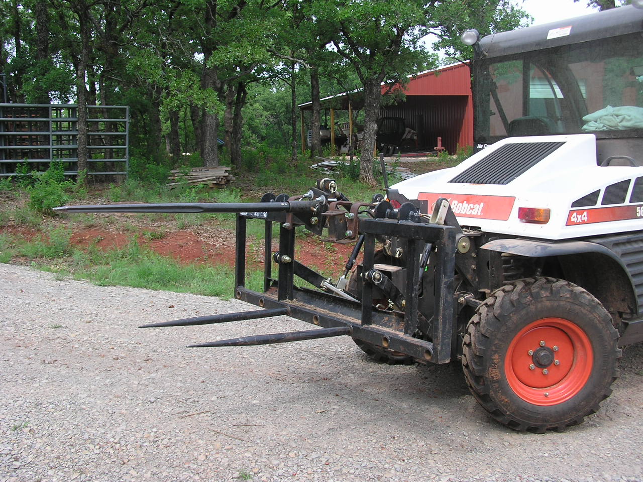

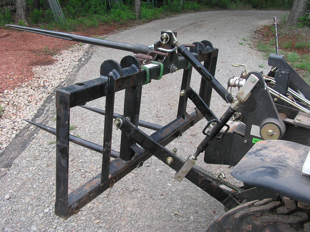

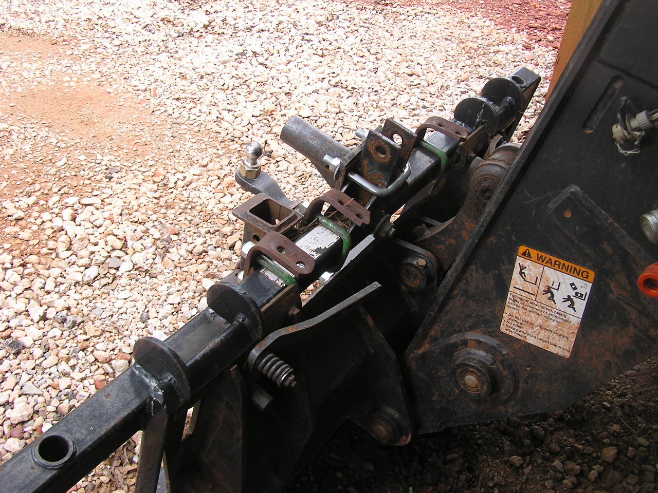

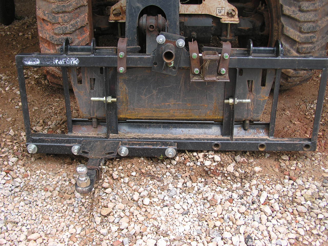

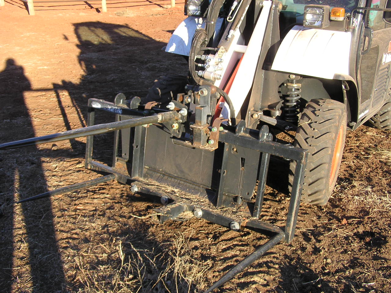

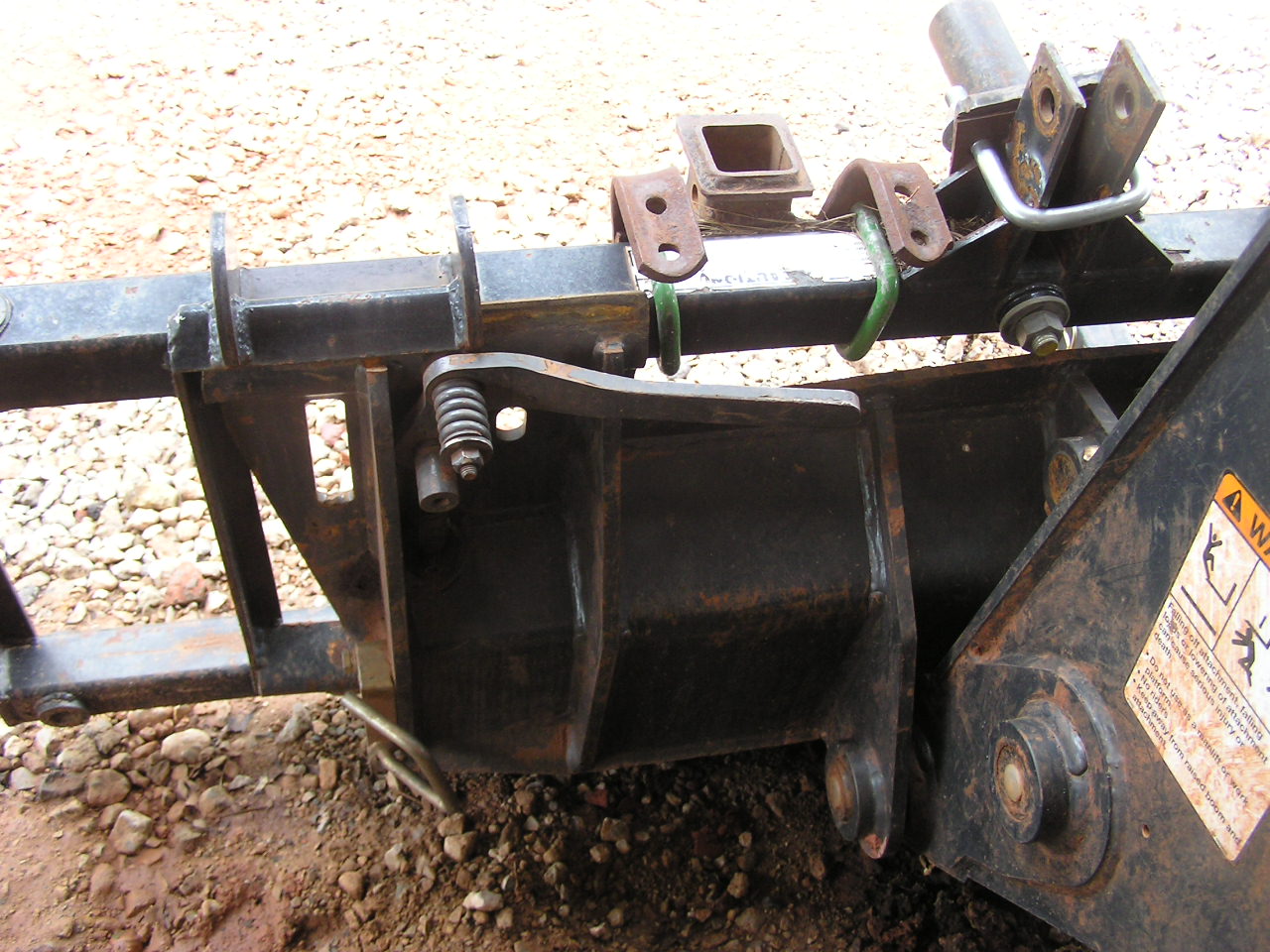

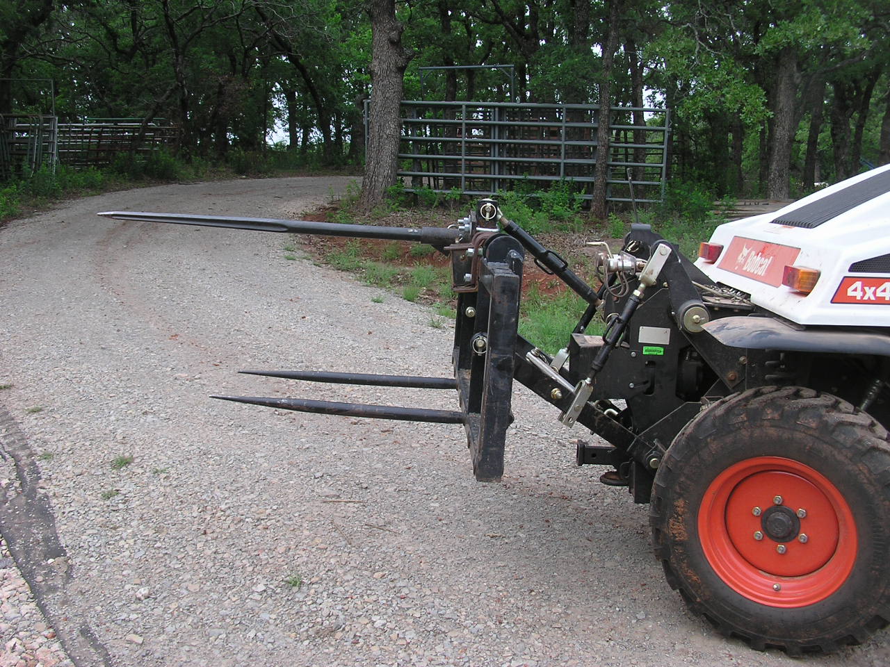

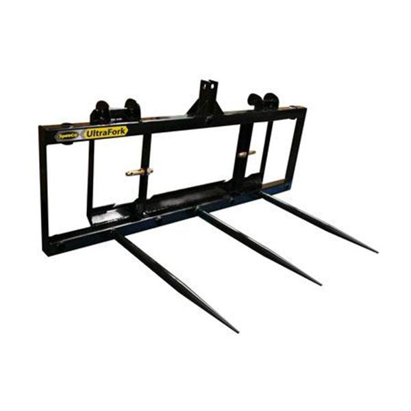

for future reference, anyway to modify my Land Pride forks to fit my Cat I 3ph?
You might be able to cut away some of the SSQA plate and copy this design from the Speeco Ultra Fork.
Mounted on the quick attach.
Mounted on the 3 point.
[snip]
That's what I'm thinking!

I would get a set of forks for the rear. it is handy at times having a set on the front and rear.
[snip]
Ok, for some reason I missed this the first time around.
Please say more why and under what circumstances that both front and rear forks would be handy, please.
Not a challenge question! This is strictly a "tractor newbie" question!
Thanks,
   / I need an expedient ballast weight on 3PH #34
Thanks,
That is easy... Bottom line is move more with less trips and ballast. You can carry logs & brush for example front and back, ballast on the back when working heavy on the front and ballast can be anything you can pick up with forks. Baled hay on pallets front and rear cut down on the mileage also.
   / I need an expedient ballast weight on 3PH #35
Thanks,
I agree with what MorningViewStables said.
Since I made my 3PH pallet mover I started putting everything on pallets. I have firewood, mulch, bricks, blocks, scrap metal etc on pallets. Sometimes I need to move multiple pallets and it is handy being able to move 2. I have a QH and with the 3PH mover I don't even get off the tractor to hookup or unhook from it. When you lift something with the front forks you have to hook up to the forks and then put something on the 3PH to counterweight. With a set of 3PH forks you don't have to worry about adding a counterweight if you have your loader on so they are faster to use in a way. You can also lift more on the 3PH.
