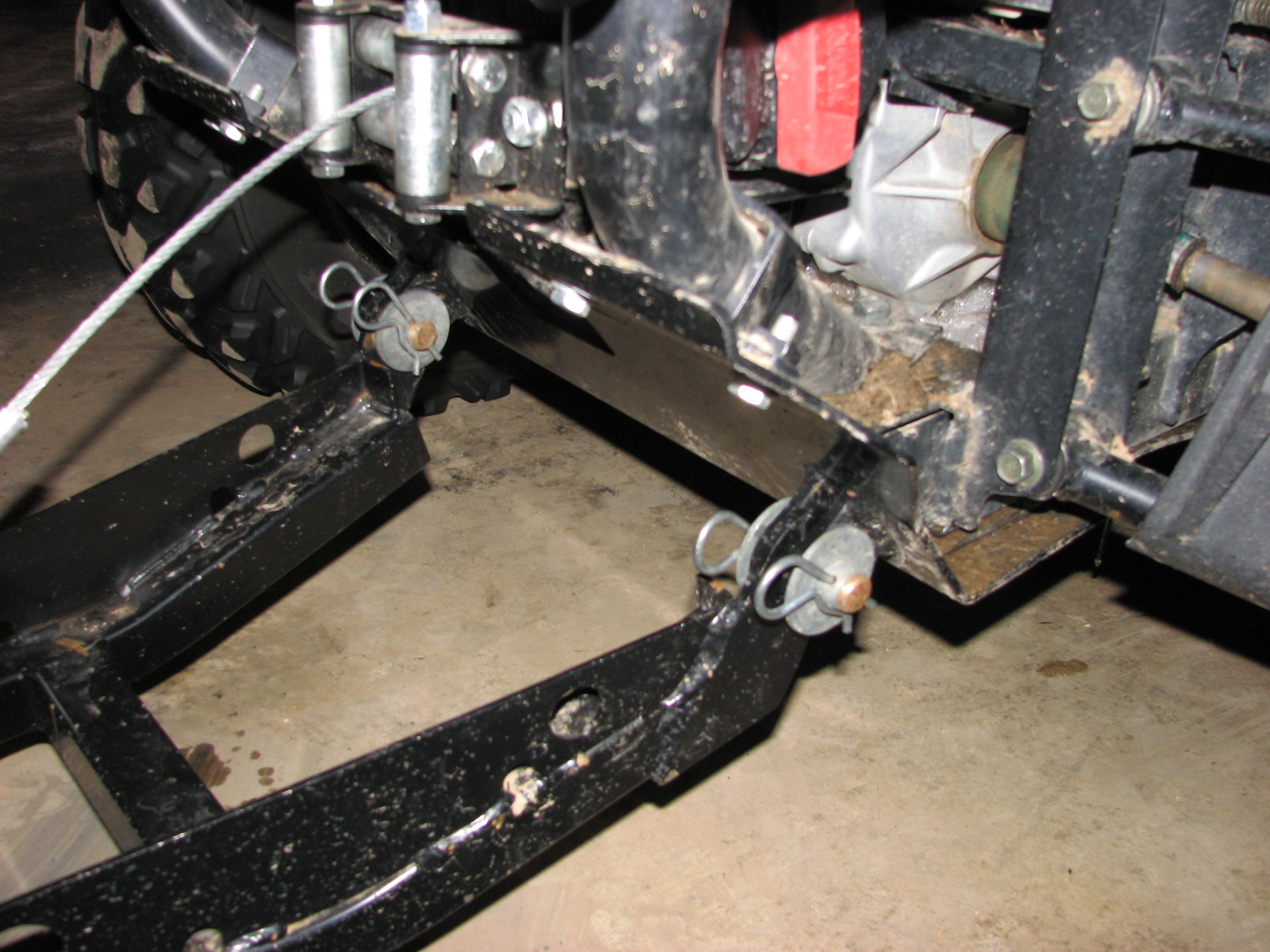

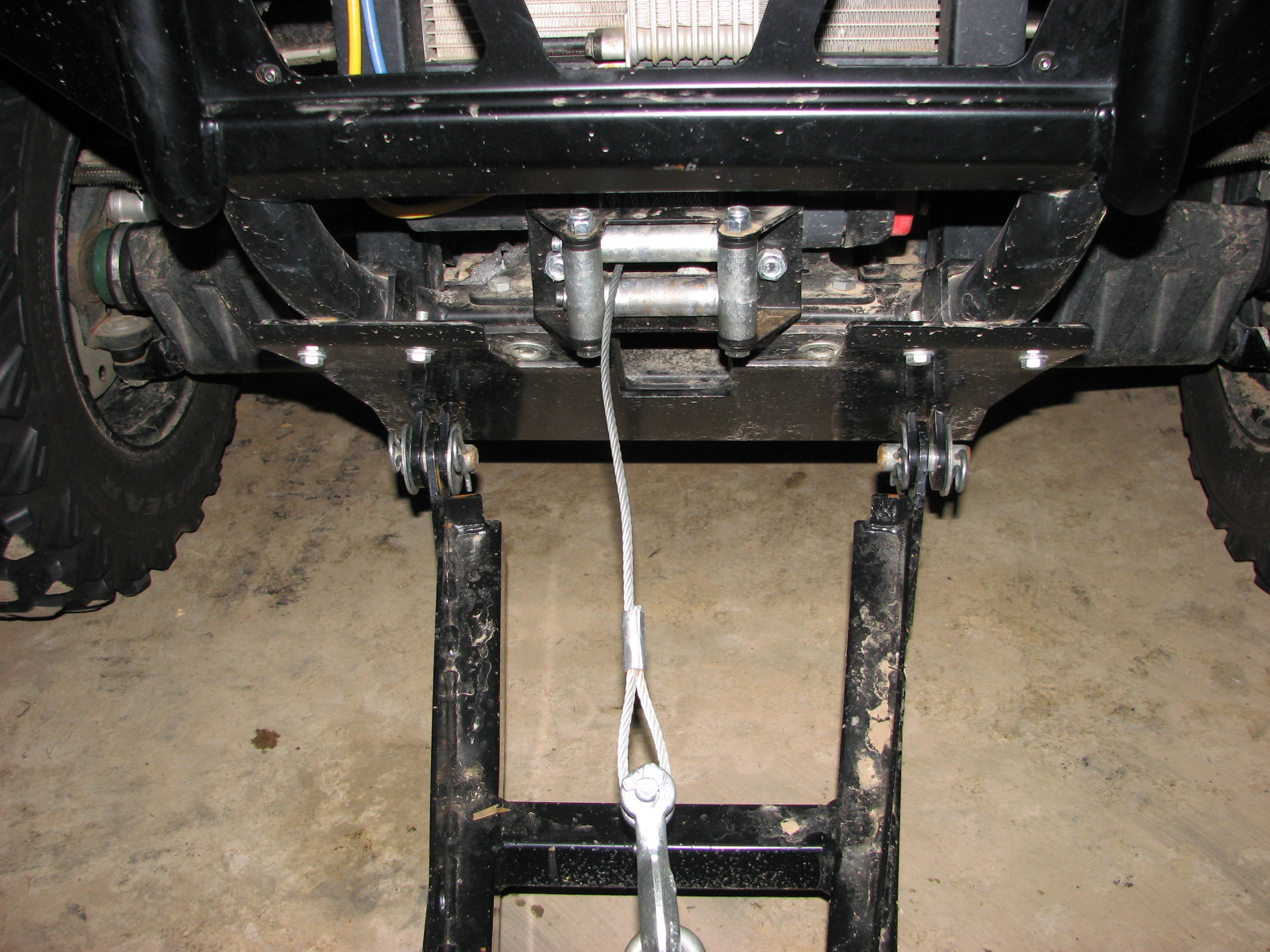

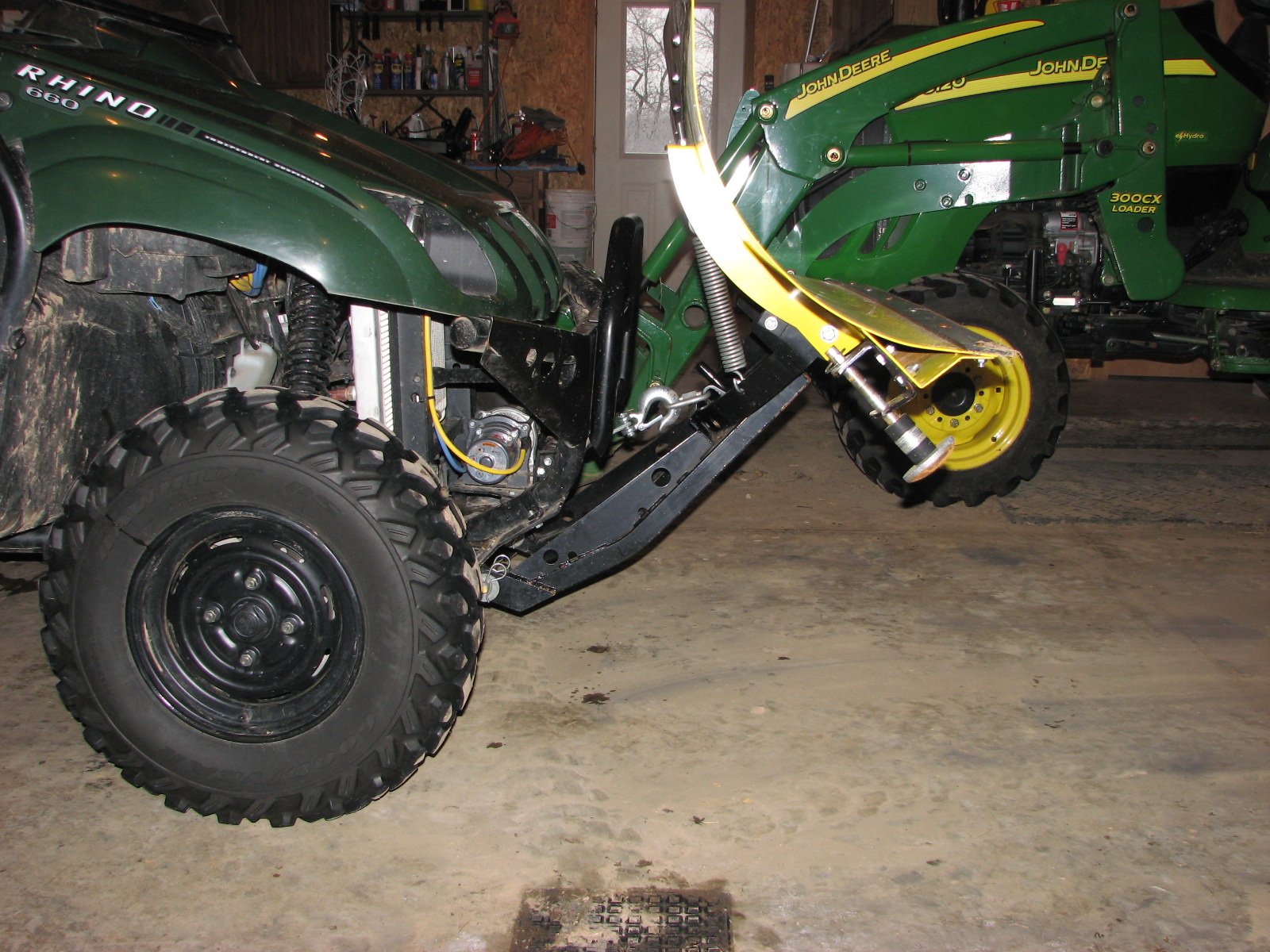

I'll take some photos of the system I have, I can lift the plow better than 12".
Malvern
   / I need new ideas for lifting my plow blade...I'm going through winches #14
kvrdave,
This is the set up I'm using, lift height is 28"
Hope this helps
Malvern

That looks nice, and would definately raise enough. What type is it? The other thing I wonder is whether or not the mounting brace would get in the way of the the hitch mount I have for my winch. Any idea? I can ask whoever sells them. Thanks much. I look forward to looking into that....along with the whippy plow markers.
The plow markers might be the cheapest thing to try. I suppose if I kill my current winch, I'm not out much. It's a crap one that I should replace (Gorilla).
   / I need new ideas for lifting my plow blade...I'm going through winches #16
kvrdave,
This is an American Eagle plow, the brace has a 2" x 2" cut out for the hitch mount.
If you still going to use your hitch mount winch set up, I think you'll have the same problem. This plow works the best with the set up I have now.
If you want more pictures let me know.
Malvern

kvrdave,
That makes sense given that you are winching the unit straight up, but more "pulling it back and up." Would that be a fair description of how it works?
I take it that you can then see the blade raise slightly above the hood of the rhino and that is how you see when to stop?
Also, looking around, I see several different types of system from American Eagle. Could you link to a product page that has the specific type you use (if it isn't too much trouble, and thanks much for all the help). Also, is the blade, etc. heavy enough with this system to not have much bounce to it? I have bounce on my quad with 48" blade be zero problems with the 72" on the rhino because it is a heavy dude. It is a cycle country one.
   / I need new ideas for lifting my plow blade...I'm going through winches #19
kvrdave
That is correct.
The mounting plate I have is not shown on AE's web sight.
Since this blade is taller than your I don't have any problem seeing what position it's in.
haven't had any problems with bounce so far, this is a very heavy blade.
You up position is going to be best guess unless you put something in the system to stop it like the other posters suggested.
Malvern
