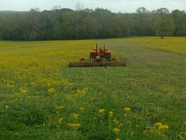

I can pull a 15t batwing over 80ac.and spend cple days(16hrs) and have it cleaned up. mowing.JPGrear view of mowing with batwing.JPG

You're in my "wheelhouse" on this question....I own a commercial mowing company. We mow large acreage for a living. You're grossly UNDERsized for mowing that sort of acreage.
A flail mower would "allow" you to cut significantly SLOWER than a comparable width rotary cutter.
Skip the haybine idea....Will slow you down in the long run.
Either that ground is EXTREMELY rough, or you're going WAY too slow....I'd think you should be able to mow quite a bit more acreage in 400 hours.
That tractor is borderline in regards to using anything bigger than 5'er. And with that, just adding 1' to the mower won't significantly alter your acres per hour.
You need to address the issue of ground speed as much (or more) than mower width if you want to increase productivity. Or get an army of goats to turn loose.....lol!

I can pull a 15t batwing over 80ac.and spend cple days(16hrs) and have it cleaned up.View attachment 258351View attachment 258352
Here we go. I try to bushhog my fields twice a year. 7ft hog i can do a little better than an 1 and 1/2 acres an hour. This is thick stuff. just grass. If i only bushhog it once a year, usually late summer, i can do just an acre an hour.
What you show in these pictures, is easy mowing. Light stuff, thin. Probably pretty smooth too.I don't think i could run a 15ft batwing on any moderate growth, and have any ground speed up here. 15ft batwings up here are powered by 110hp on up. usually run by 125hp units.
why i'm pointing this out is because each region has such a variety of materials to mow. Hard to give good advice.
