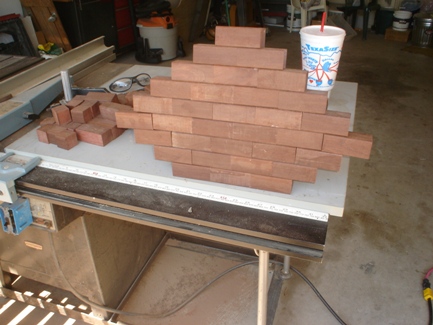

I made that one big board into a bunch of small ones that a kid can build things.

I made dimension blocks out of the teak. He'll be able to build like a brick mason with them.
But I will build the unique shaped blocks with the stainless pins down the road. And the only limitations they will have will be the builder's imagination.

Harvey, the blocks will look great and your grandson will really enjoy them. Kids like the darndest things. We all know they will walk past an expensive toy to play with a cardboard box. /forums/images/graemlins/smirk.gif The thing about toys is making something that doesn't become too big a pain for Mom to pick up. If Mom gets too frustrated picking stuff up, it goes into a box on the top shelf of the closet. Just a thought.... /forums/images/graemlins/smile.gif

Very nice lookin walnut! Just another point for you to consider. Hopefully you cut this stuff thick enough to allow it to adapt to the prevailing humidity conditions. Even if its dry it will move around some, like twist and warp etc. I dont know what your time frame is on the toy project, but it needs some time to adapt after being cut. I realize that the toys your making will be smaller in size, so twisting and warping shouldnt pose to much of a problem. Just a note of caution more than anything else.

I think it's a good thing you plan to put off the pins-in-blocks for a while. I can see a two year old falling onto a pin-in-a-block and hurting himself. On the other hand, a somewhat older kid could have a ball making thingies out of such materials.
Somewhere around here (looking around my rather cluttered office) I think I've got a collection of wooden geometric shapes. I used to have it anyway. It was used for teaching an aspect of inorganic chemistry, or group theory or something. Cubes, pyramids, icosahedra, dodecahedrons, etc. I bet you could figure a way to make some of those out of some walnut. They'd be fun to play with and just plain decorative, too.
