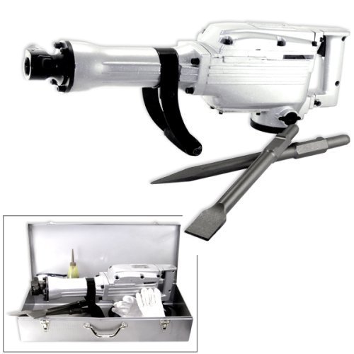

Just an update of how I chose to go about getting these posts into the rock.
I bought this electric jackhammer and it went through layer after layer or dense rock like it was peanut brittle. The price of renting a gas powered unit was 150/day. This one cost me $175. It weighs in at about 50 lbs and can be beast to handle but it does what it says it will.
