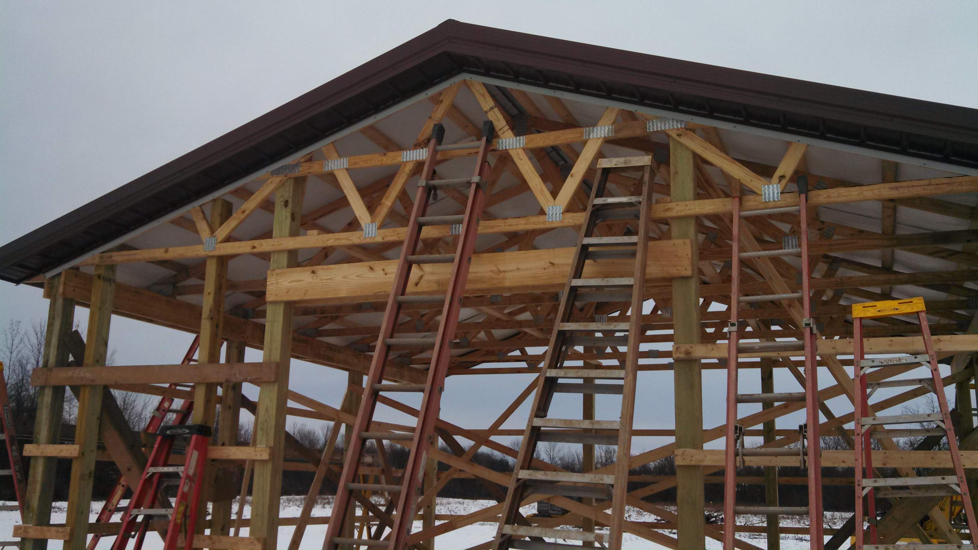

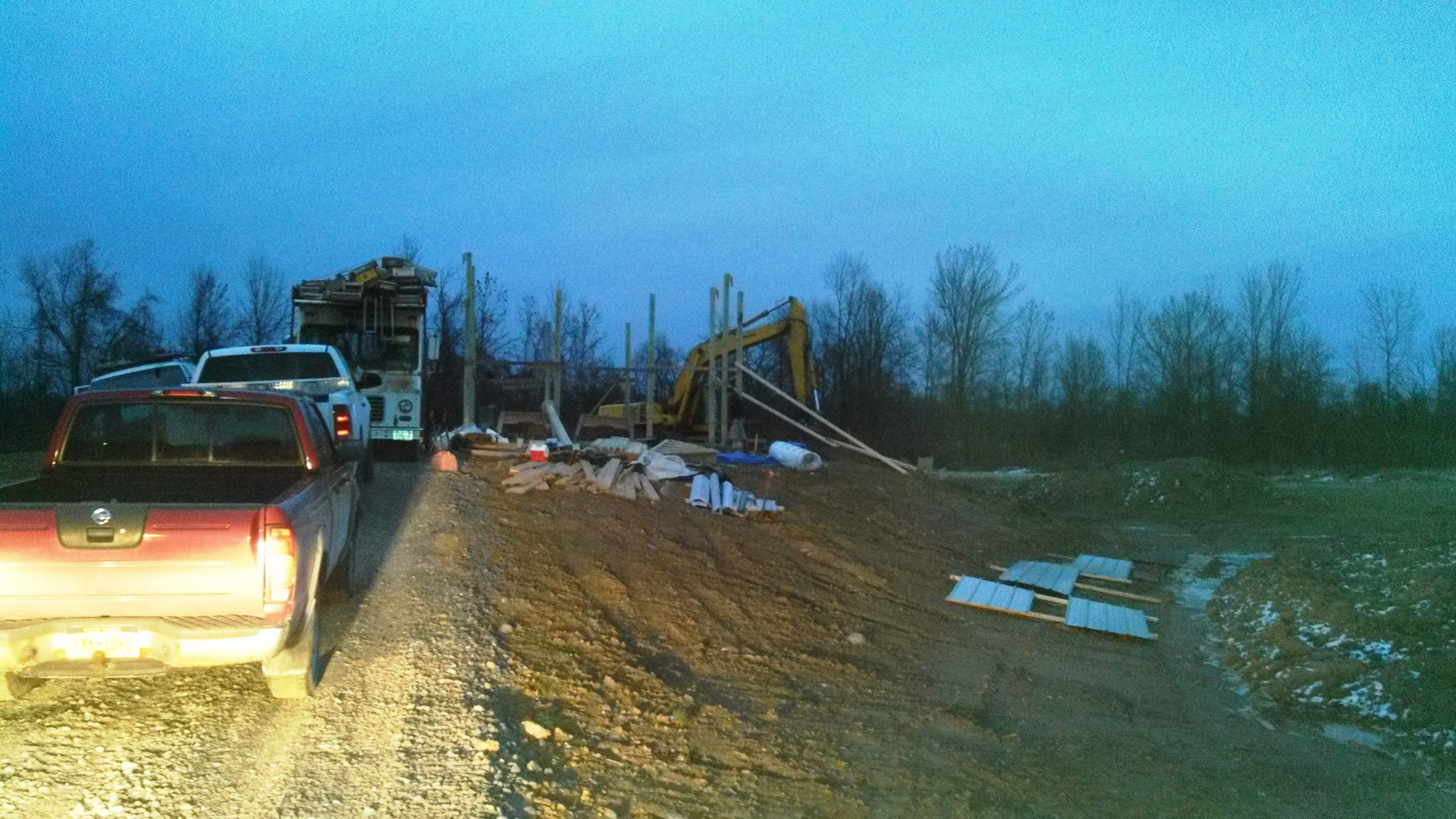

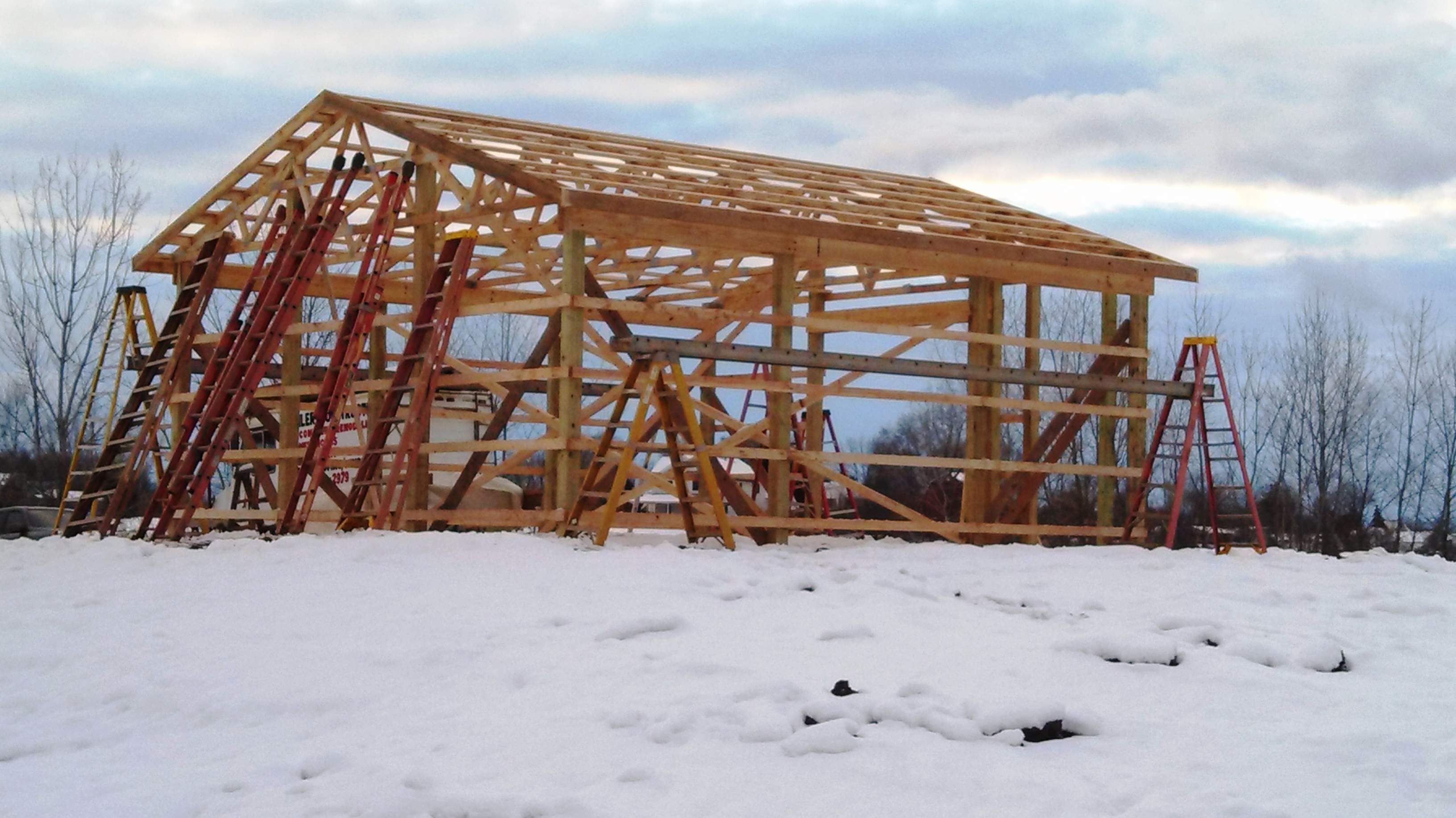

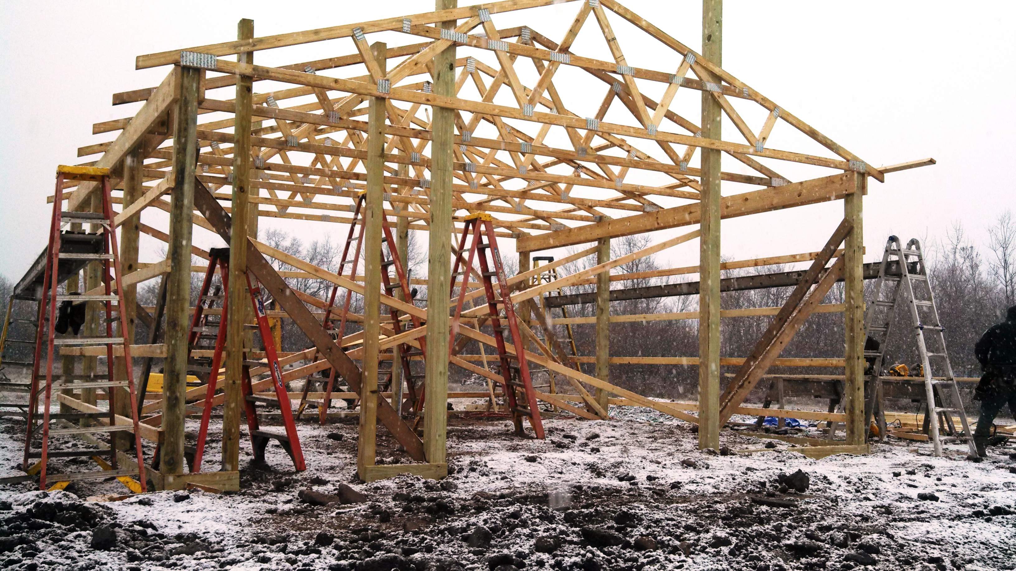

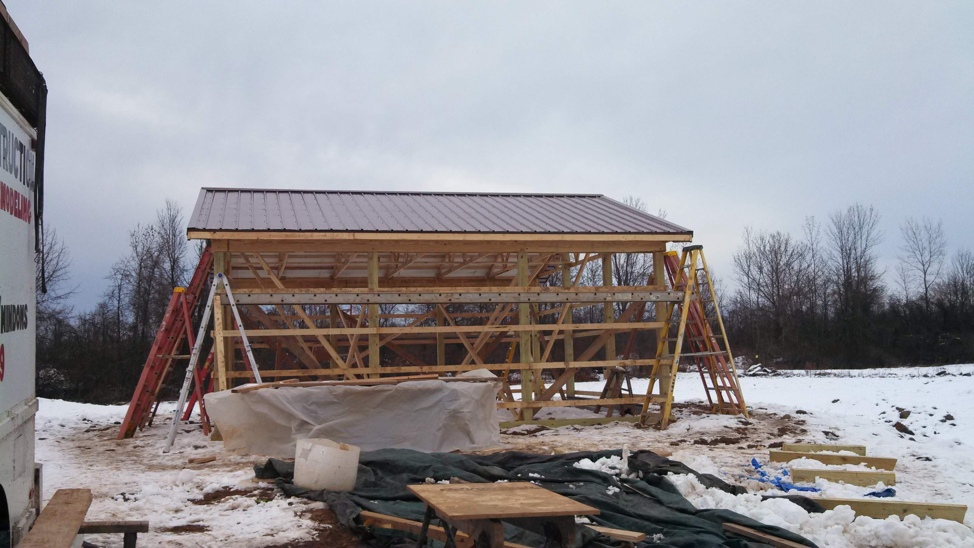

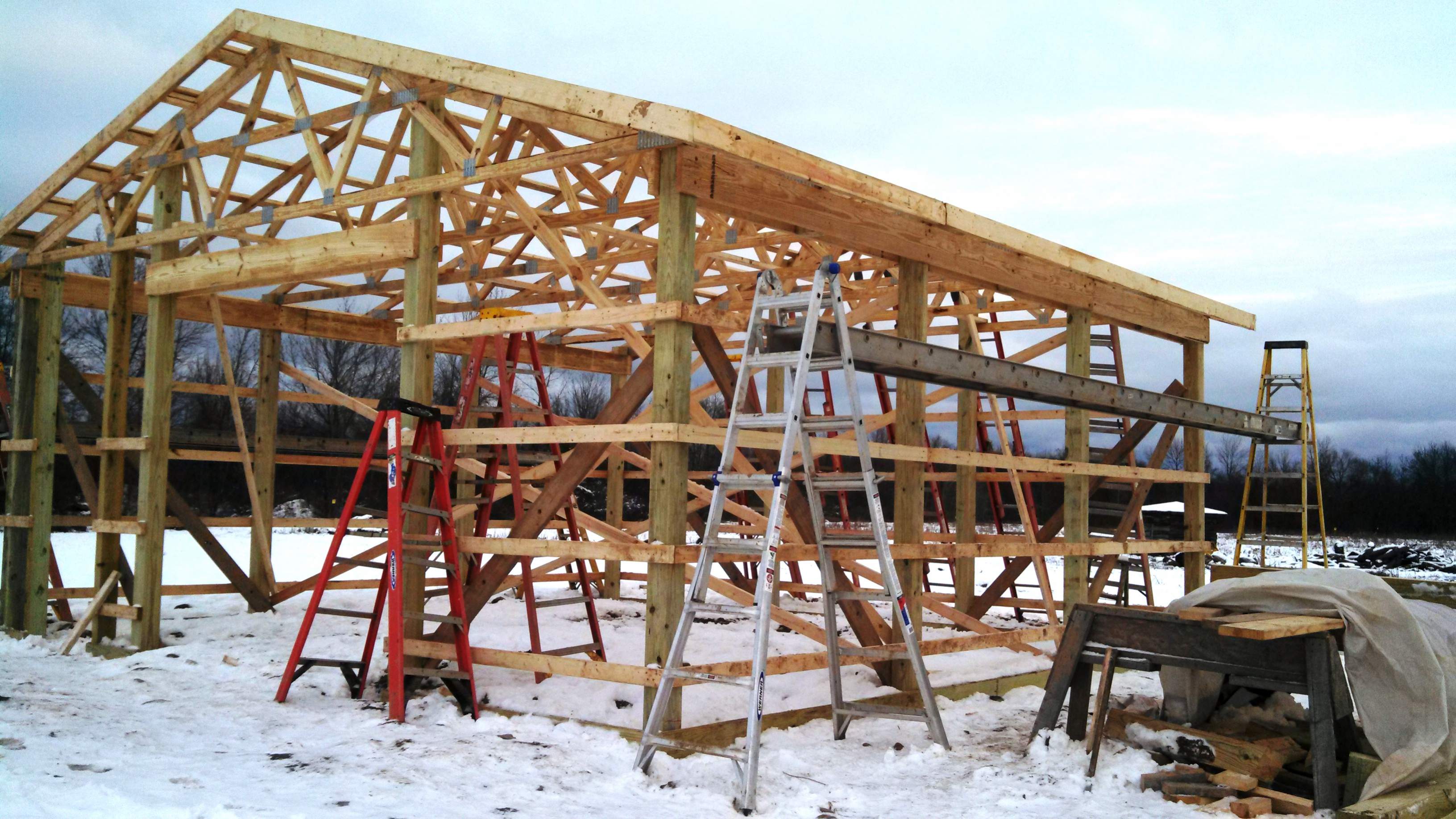

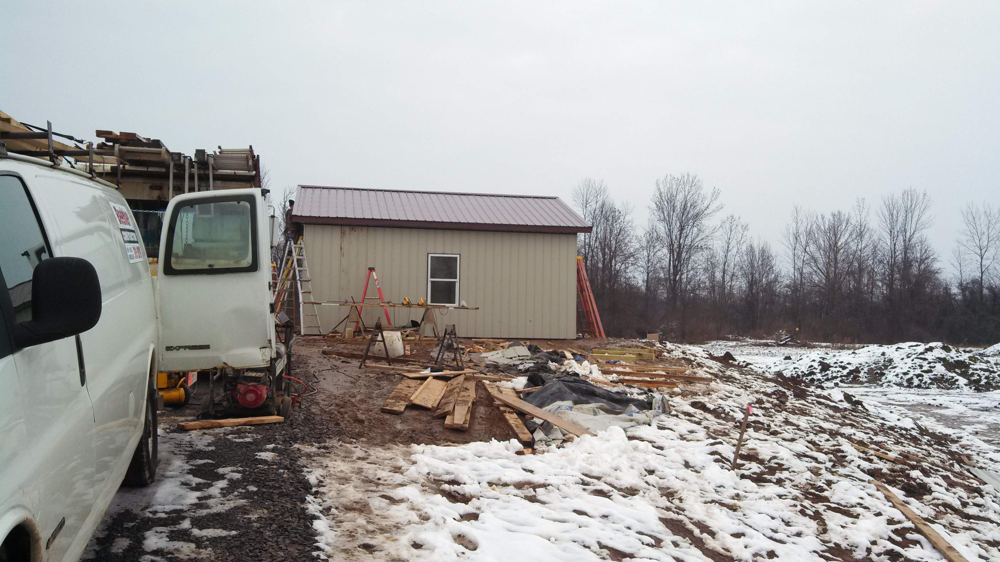

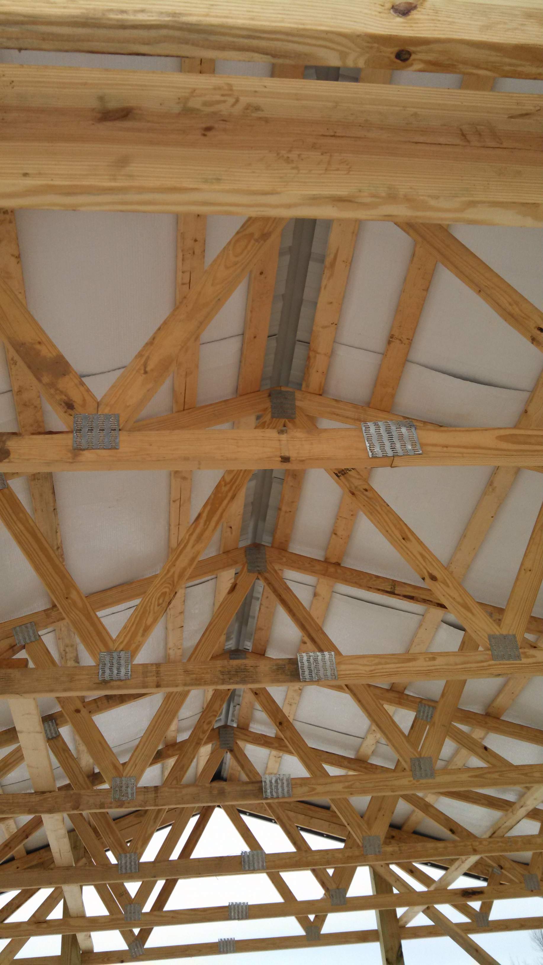

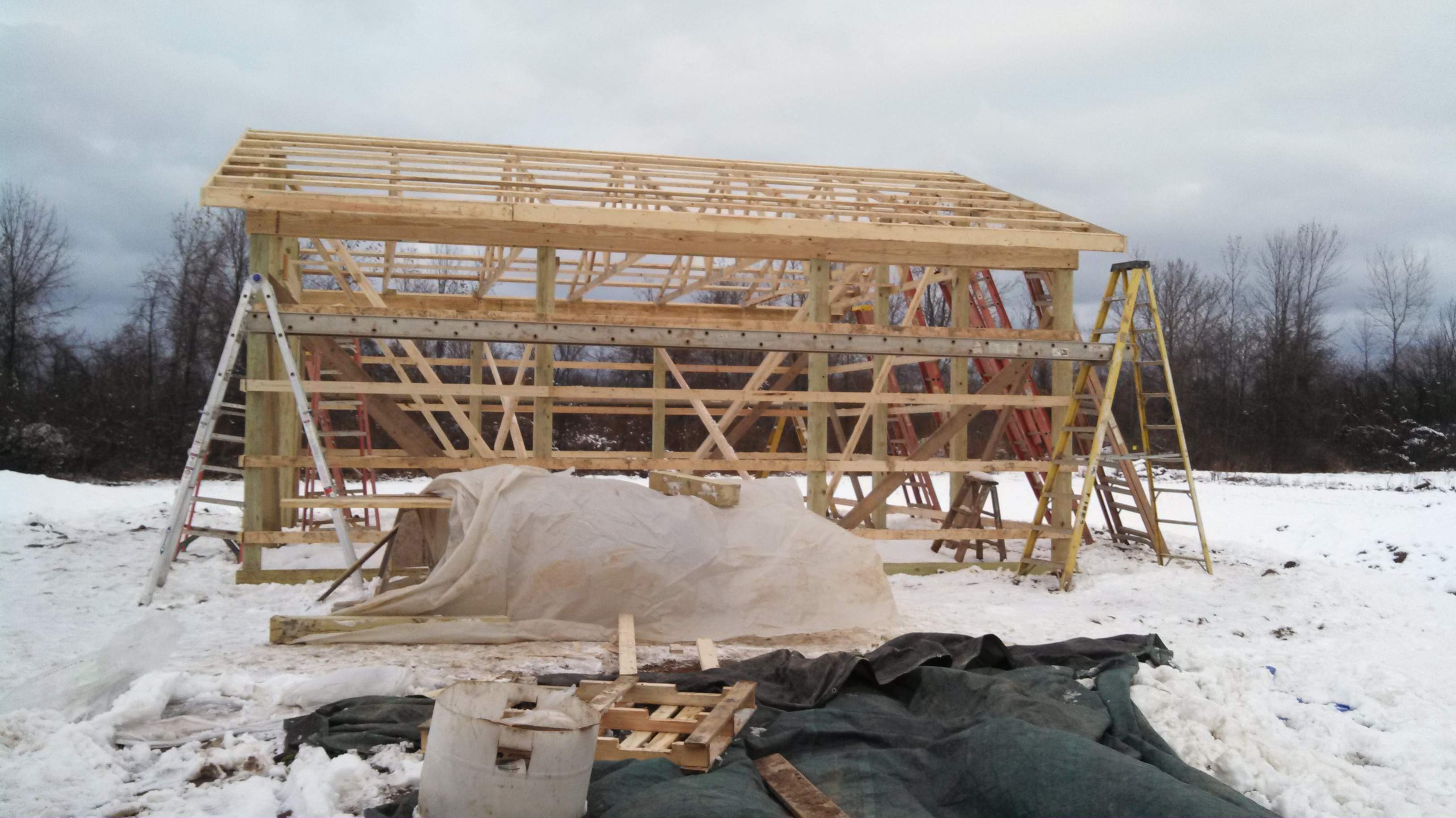

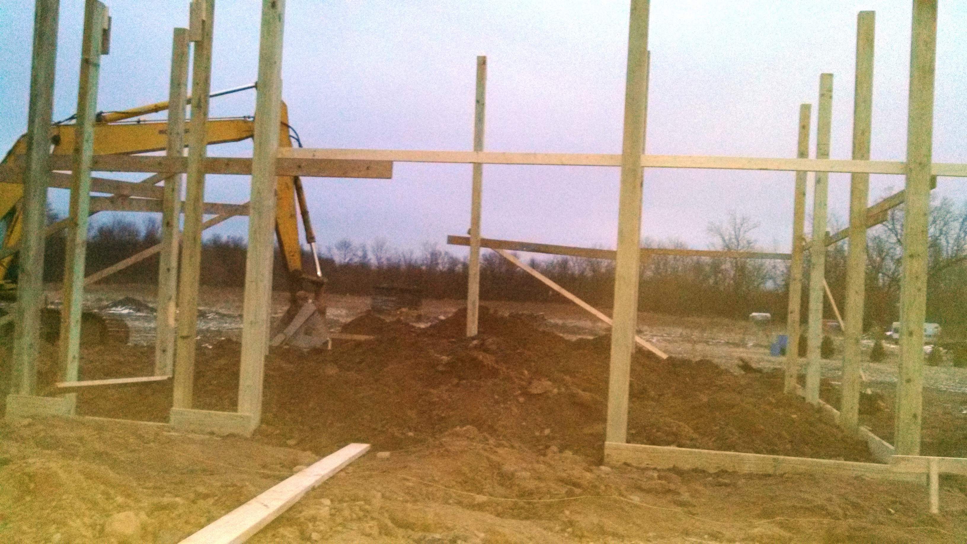

So here is the pictures from the building process. I did not build this myself as i was too busy hunting :) I hired a local contractor and he did a very good job for someone who builds houses all the time. The pole barn was ordered from polebarnsdirect.com very good customer service! IMG_20131125_165600_484.jpgIMG_20131125_165705_249.jpgIMG_20131127_162424_810.jpgIMG_20131126_152640_172.jpgIMG_20131127_162357_519.jpgIMG_20131127_162303_350.jpgIMG_20131127_162331_192.jpgIMG_20131130_144640_704-1.jpgIMG_20131130_144706_843-1.jpgIMG_20131130_144717_933-1.jpgIMG_20131202_153342_845.jpg530505_10152073921388685_1452179746_n.jpg1480607_10152073921968685_457635393_n.jpg1472915_10152073921713685_730946855_n.jpg
