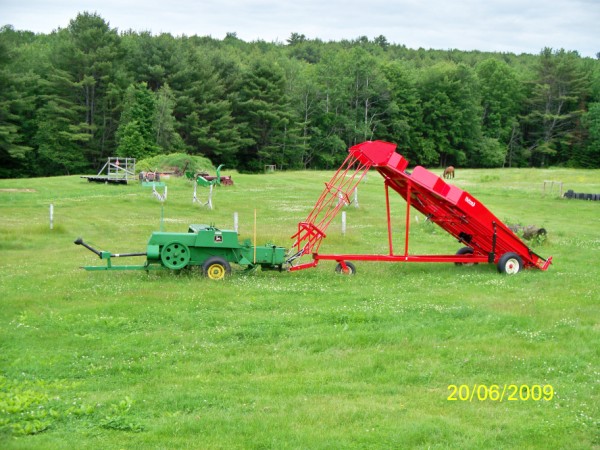

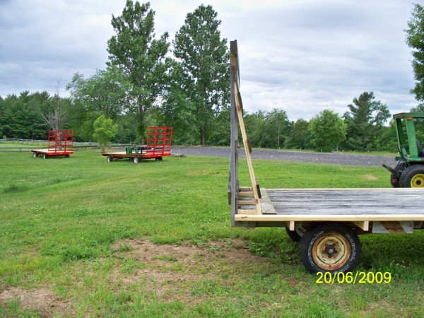

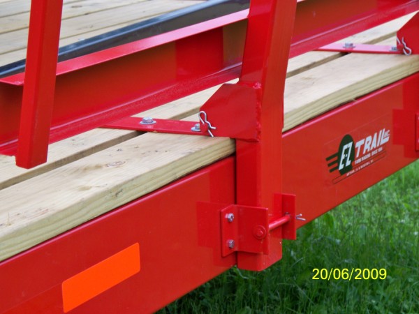

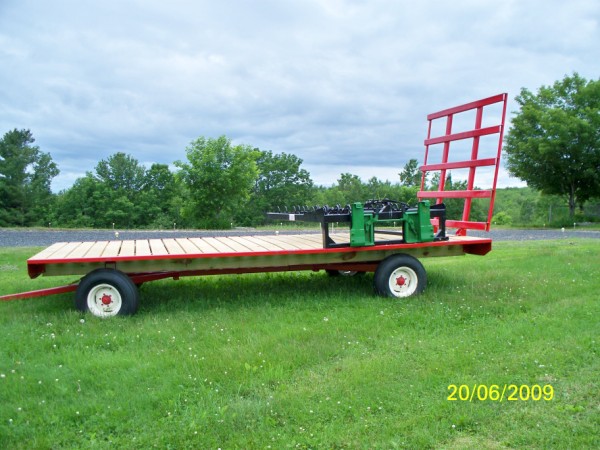

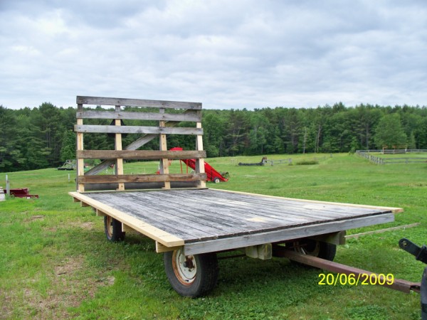

I just got a camera so here are some pics of the new equipment and hay wagon mods.
I made the wagon 1' wider, removed the braces that were on the sides and added a slanted back so the hay will stack better.
Greg
