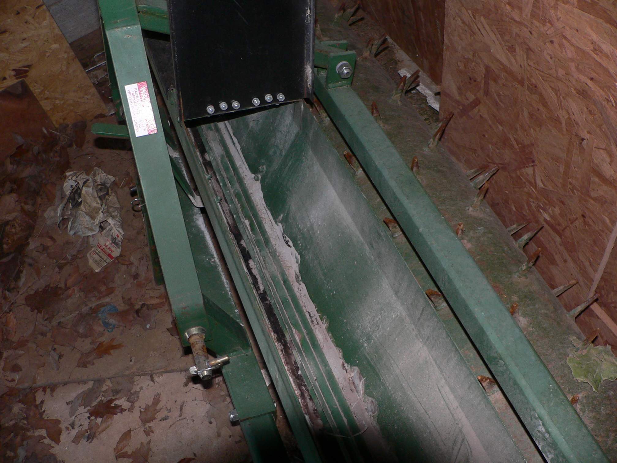

I have a Ferguson overseeder. It does not pull plugs and is not sold as a aerator but it cuts holes in the ground as well as serves other purposes. Look at picture and decide for yourself. It will lay down fertilizer and/or grass seed. Fill the drum with water for a deeper penetration of the soil. I use it every year to over seed and to also seed bare patches. Was well under $1000 from Barlows. I've pulled this with my BX1500, B7800, BX2350 and BX3200. Also order some QA 3ph arms, they'll be the best dollars spent

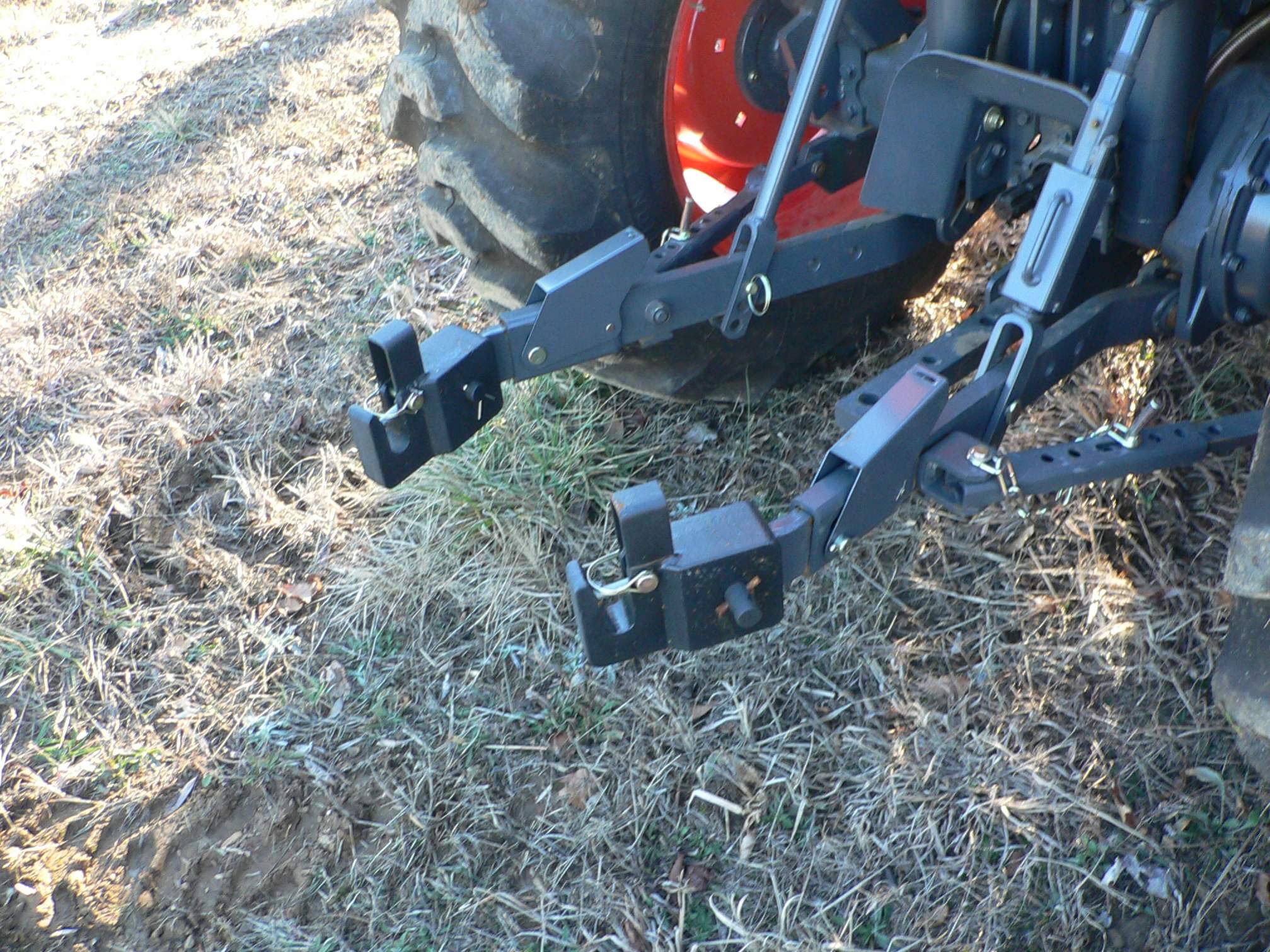

John.....which quick attach kit did you use?
   / I need your input on implements before my 3200 ships.... #10
I have Pat's plus the one in the picture that I ordered off Ebay for under $85. I've had Pat's since first tractor of 5 years ago and a couple of years ago I ordered these cast ones for my other tractor. For me the 3 most used implements are, landscape rake, Ferguson over seeder and a boxblade. I do no farming or commercial work, just my home stuff.
