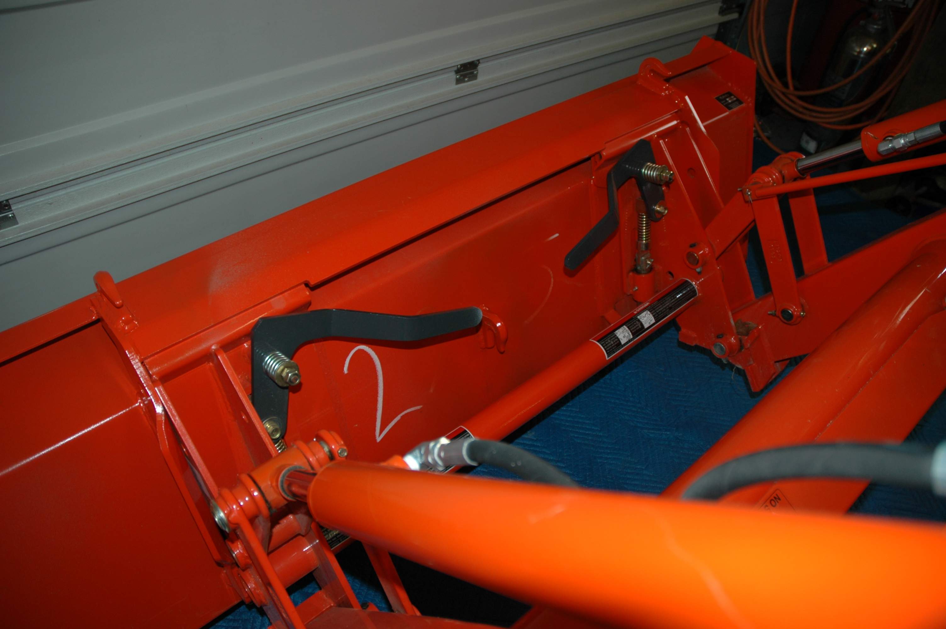

I sent you a pm to answer some of your questions. Does your Quick Attach look like this? if so it's universal skid steer.

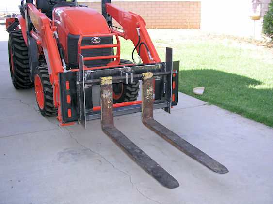

I agree with Charles about bucket forks stealing load capacity because they are so far in front of the loader pivot point. There is another issue that I came across last night while trying to unload a 5x3' concrete slab from the bed of my pickup...using bucket forks. You cannot see through the bucket and, as such, you cannot see the forks. Someone has to guide you. For that reason alone, I am going to get a set of pallet forks that attach to my loader QA and get rid of the bucket forks.

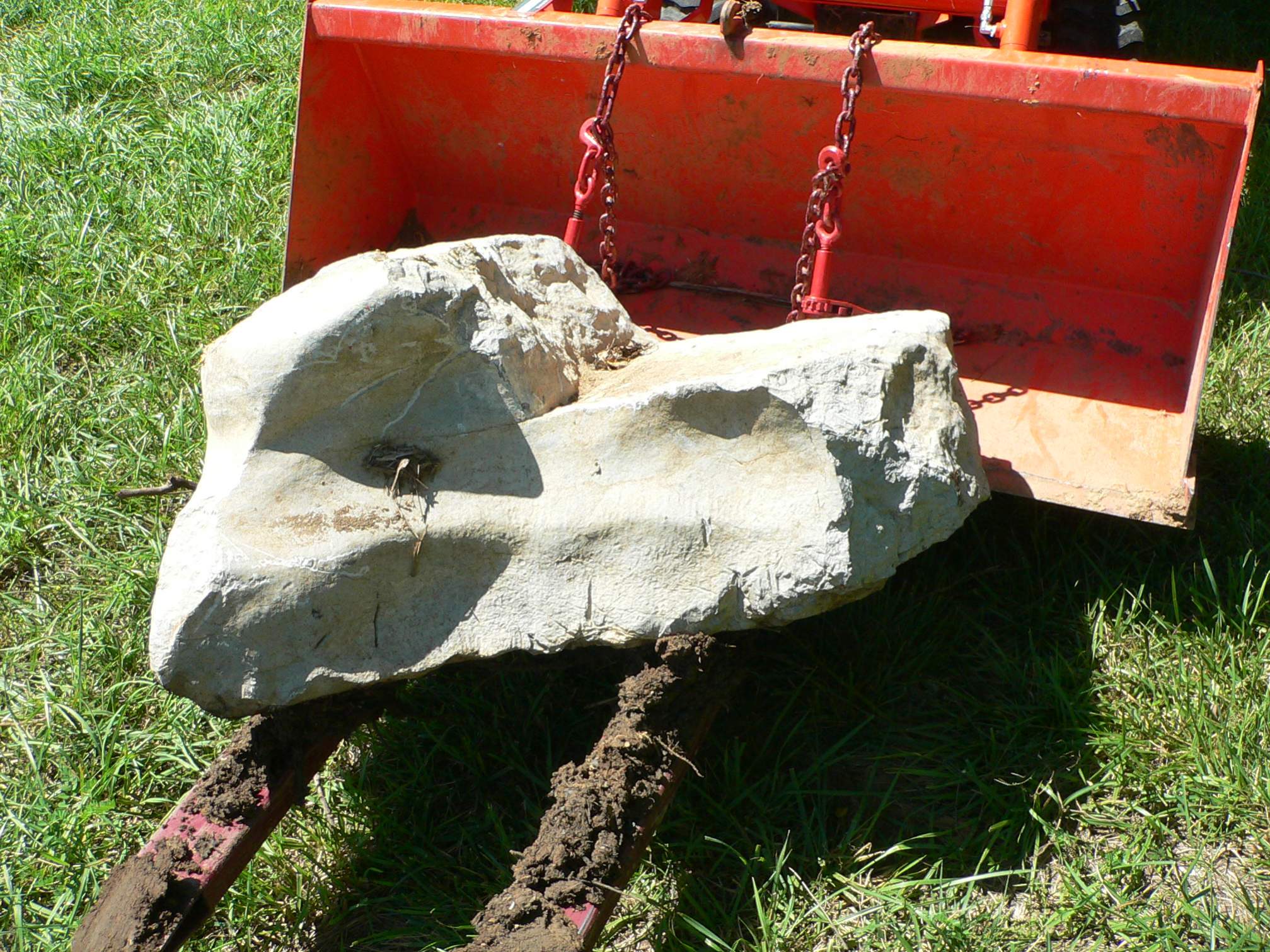

As with most purchases it depends on money and what you plan to do with your forks as to whether the hook on to buckets or attach to fel arms are needed/better. I had the attach to SSQA fel arms on my L3240. They were quick and easy to attach/unattach but I only used them once to move a hugh rock. Sold that tractor with SSQA and current tractors do not have SSQA so I now have the hook to bucket which I can use on my B3200 or BX2660. I rarely use pallet forks and when I do it will not be moving stuff that's to heavy for my hook ons. I know, what's to heavy. That's a roll of generic house wrap and probably 400' to 600' left on roll.
If money is no object and you have SSQA then that's the way to go and especially if you'll use them alot picking up heavy stuff.

Thanks for all of the advice. Based on the picture I guess I have the standard Quick attach for implements. While shopping I noticed the weight of various forks were pretty heavy which would take away from my lift capacity. I decided that for my needs a lighter capacity/lighter weight was a better way to go.

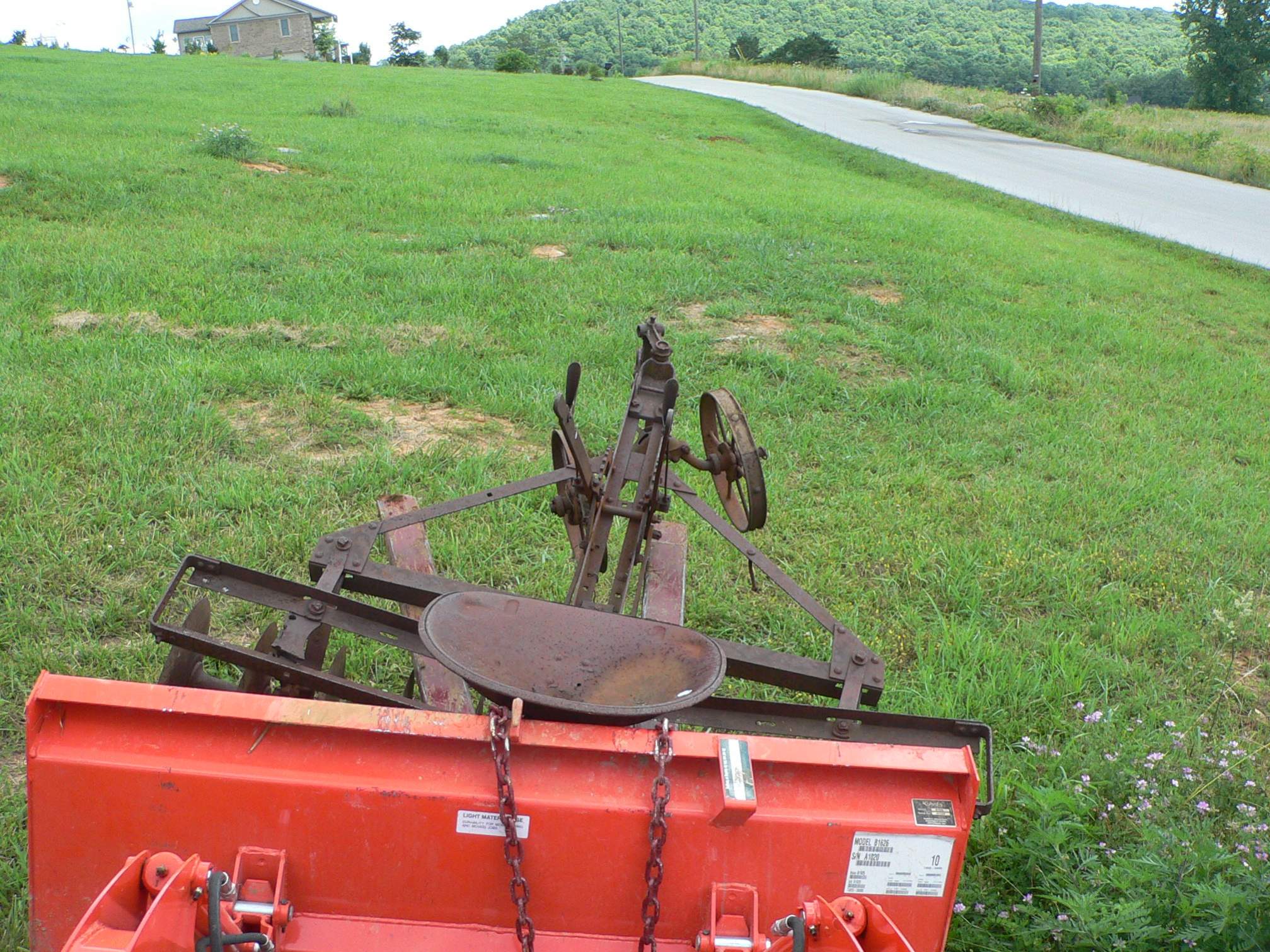

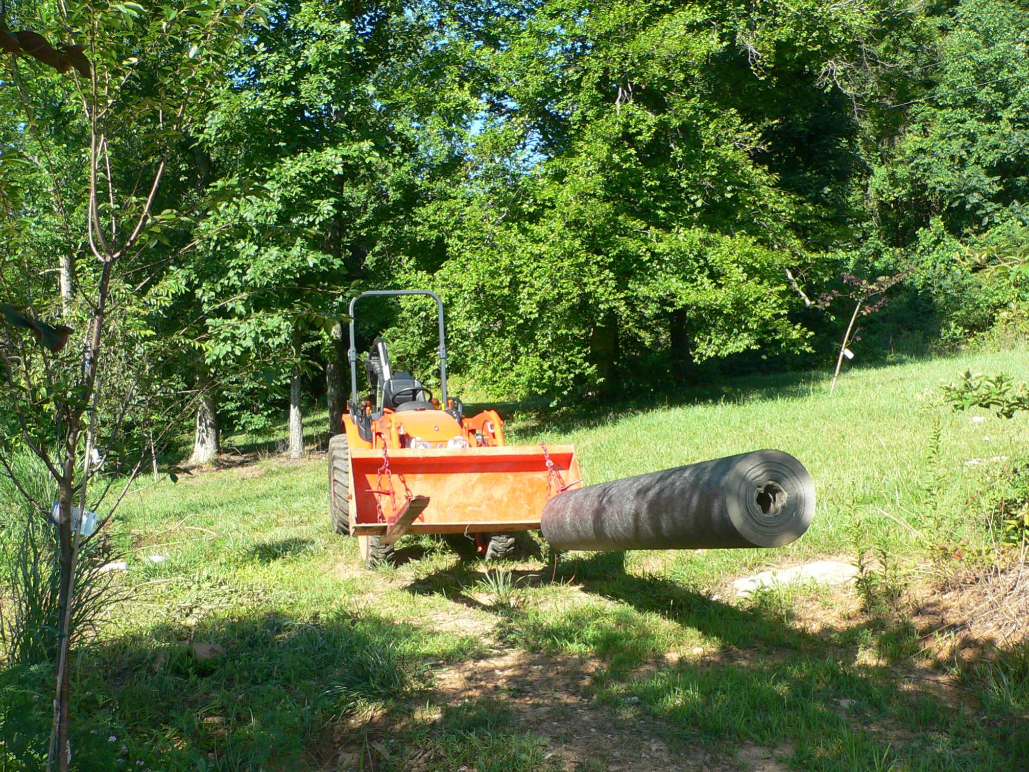

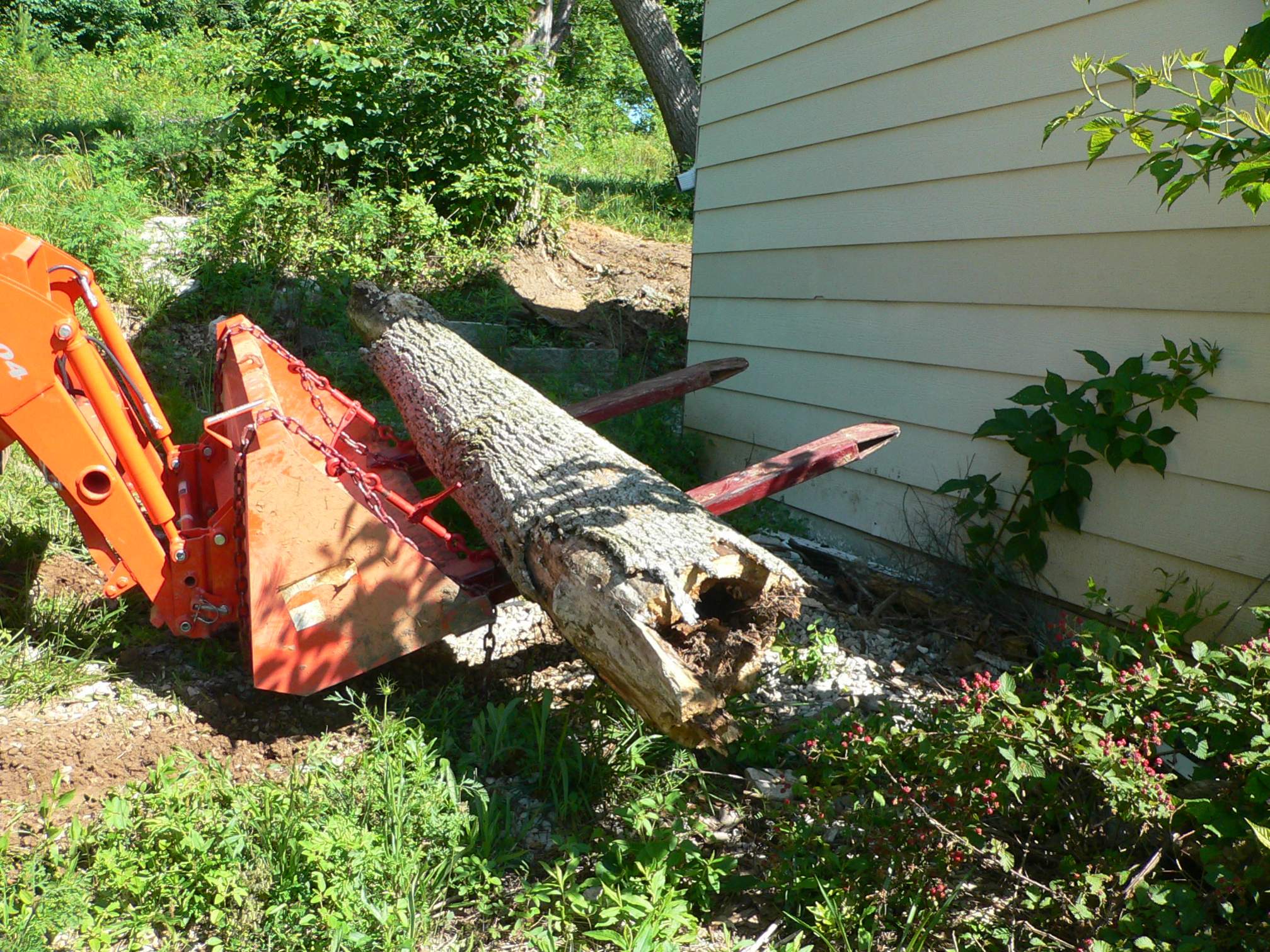

Johnthomas,
I like the mounting of your forks. Are they home made? Do you mind posting some images of the forks and how and where you attach the chains? Those tie downs can sure serve another purpose in this case. It seems they may even transfer some of the load onto the top of the bucket.

Johnthomas,
Got them from Barlows. I traded my L3240 with SSQA to a B3200 with not SS QA so old forks wouldn't work. Traded my old forks to these. As you can see from attached pictures, I hope, the forks slide over the end of the bucket, wrap chain around the bucket and then tighten down. One end of the chain comes attached to the forks and then the other end hooks to the ratchet and you tighten. It all comes with the forks. Really easy off and on and easy adjustment to width. The ends will turn if you bump something on their sides but that hasn't been a problem for me. Just don't bump them on their sides.:) They are heavy but not to heavy for one person to pick up and install. Zoom on picture to see how they're attached. You may be able to see some more detail where they are in bucket at zoom. If you need more pictures let me know.

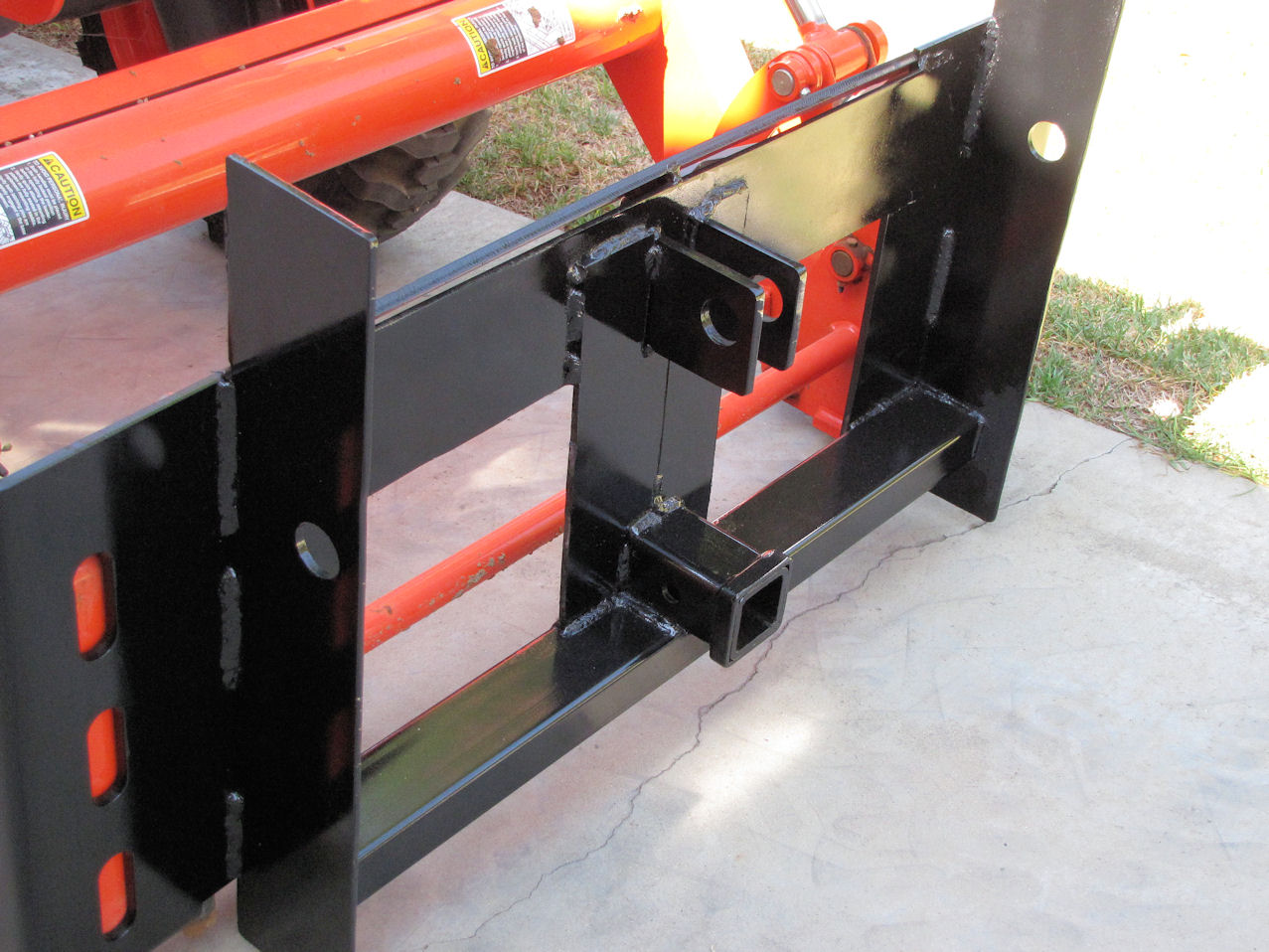

I got a nice QA plate from a fellow on ebay, $75. I don't think he sells them anymore - shame it was a great deal. Found a pair of forks at local forklift boneyard for $75. He threw in the bar for free. I've got some 1/4" plate laying around, so after a little welding, presto, B26 QA forklift attachment.
I added a box received to the frame with some added reinforcement, used to move around my 12K boat/trailer.

Hi guys
I've just bought a Kubota 60 with a detachable bucket. I want to build a set of pallet forks. This set up looks perfect. I was wondering if you could post some more pics of the construction...especially from the front angle. I don't think I'll be able to get hold of some second hand tynes, so will have to construct them as well.
Cheers Nick
