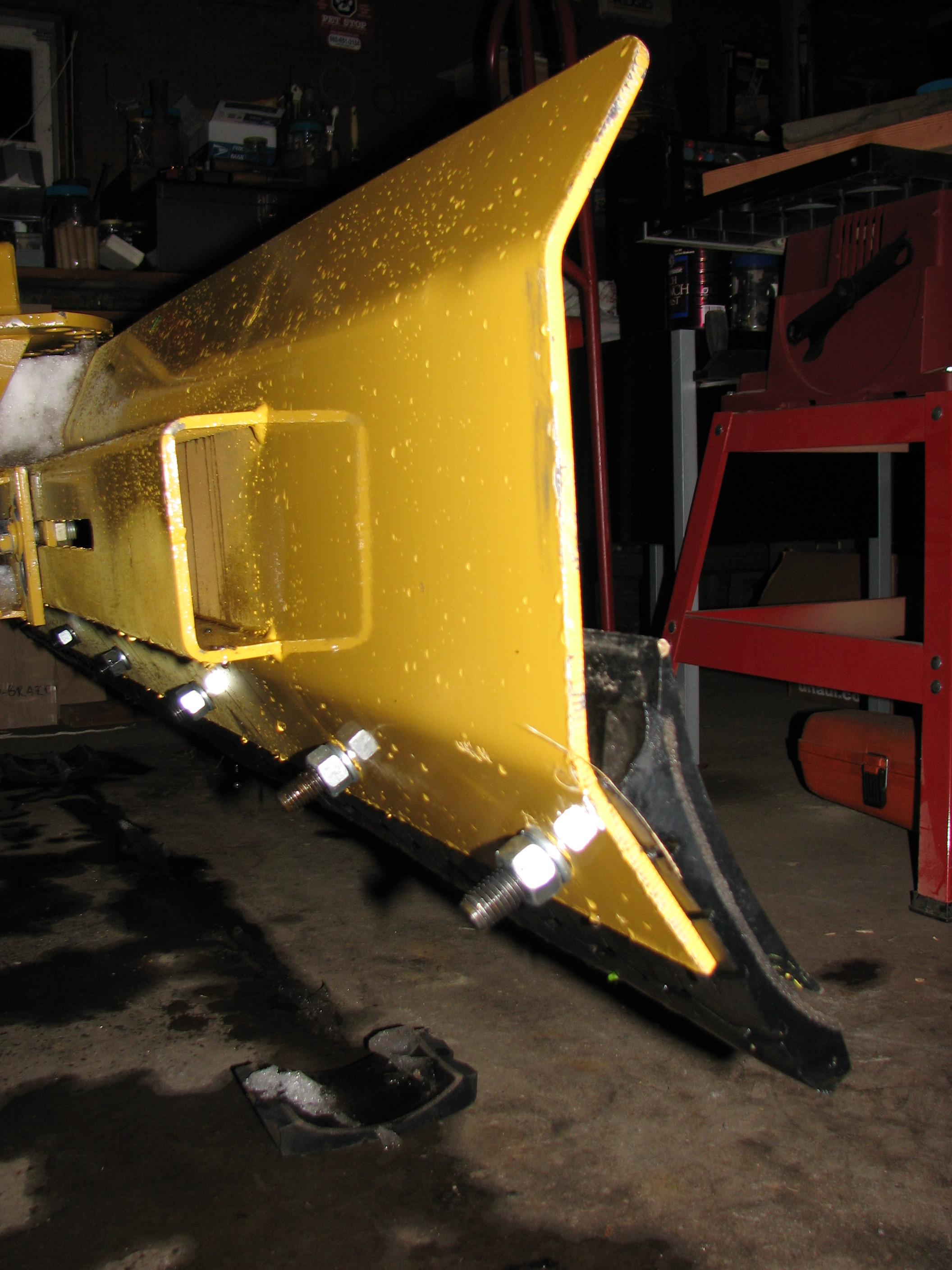

I found a sweet piece if semi truck retread on my way to work today. I figured I could mount it on the bottom of the cutting edge of my snow blade, the question is...How do I cut it? I was thinking sawzall because of the steel belting, but what do you guys think?

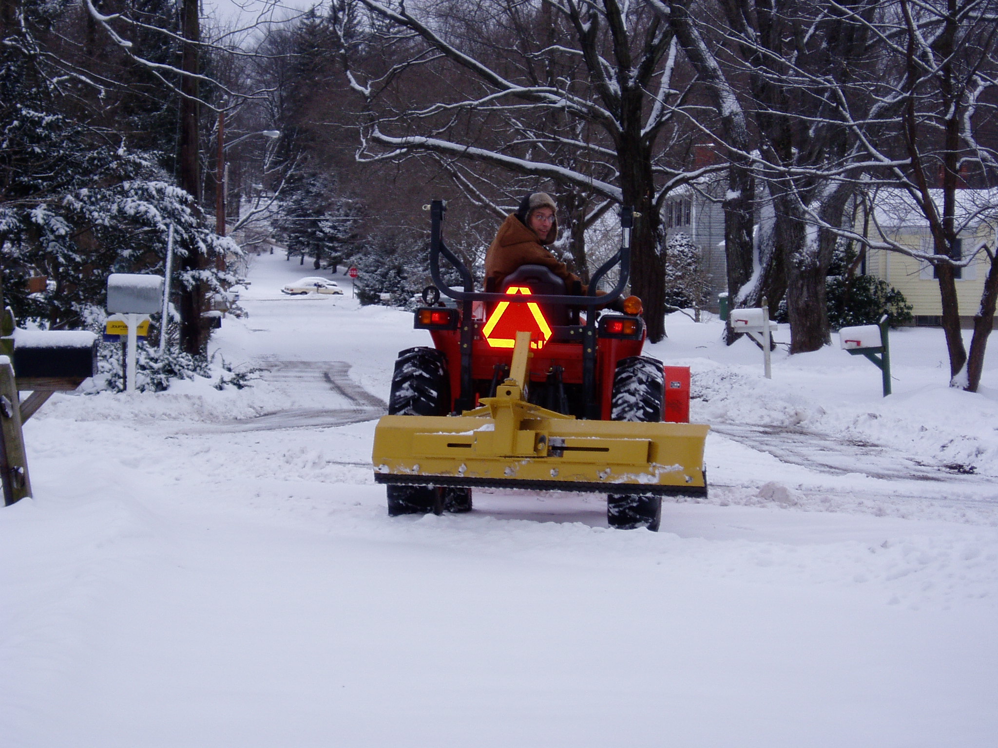

I did this 2 years ago and it works nicely for my purposes - I have grass, gravel and blacktop areas that I need to clear without ripping them up. I used a reciprocating saw (Milwaukee) with a hacksaw blade. It cut like buddah. You will need to get longer plow bolts to put the cutting edge back on. Measure the tread thickness and add that to the length of your present bolts. Luckily a local hardware store had some in stock. I used a brace & bit to cut the bolt holes, which worked surprisingly well.

Jig saw will work but U need to lube to prevent binding.
WD-40 makes good lube as will liquid soap.
I have also used sharp box cutters with a helper pulling sideways.
Forget using a skill saw, it binds.
The recap would not have the wire as that is in the carcass, so you should be OK.
