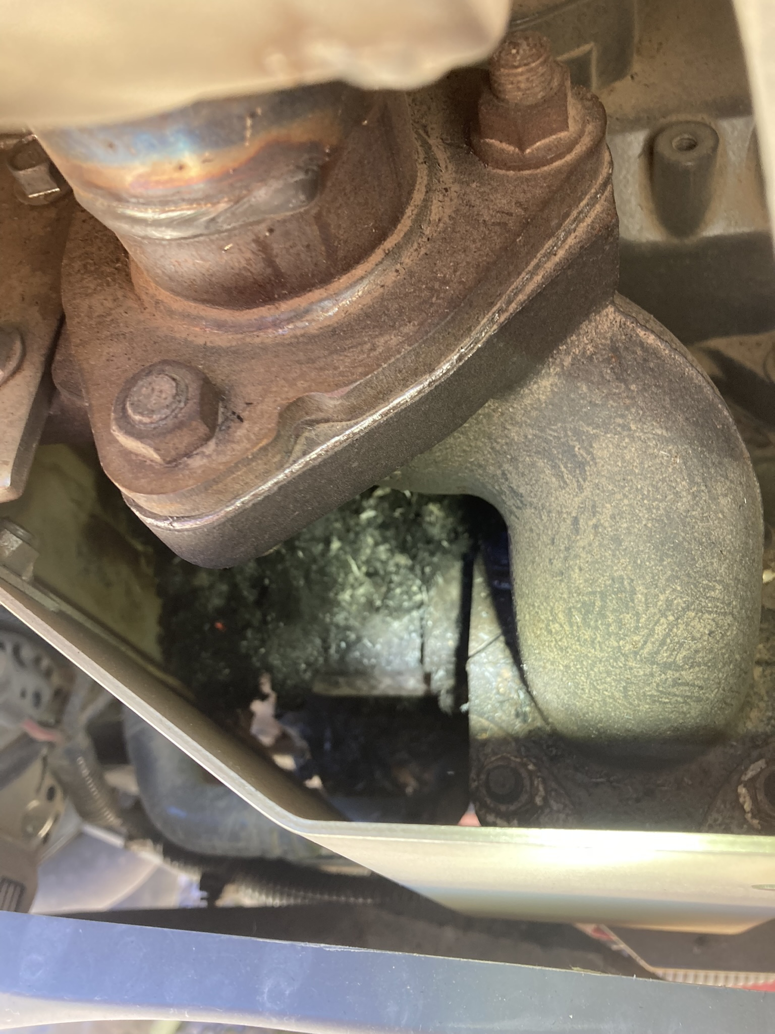

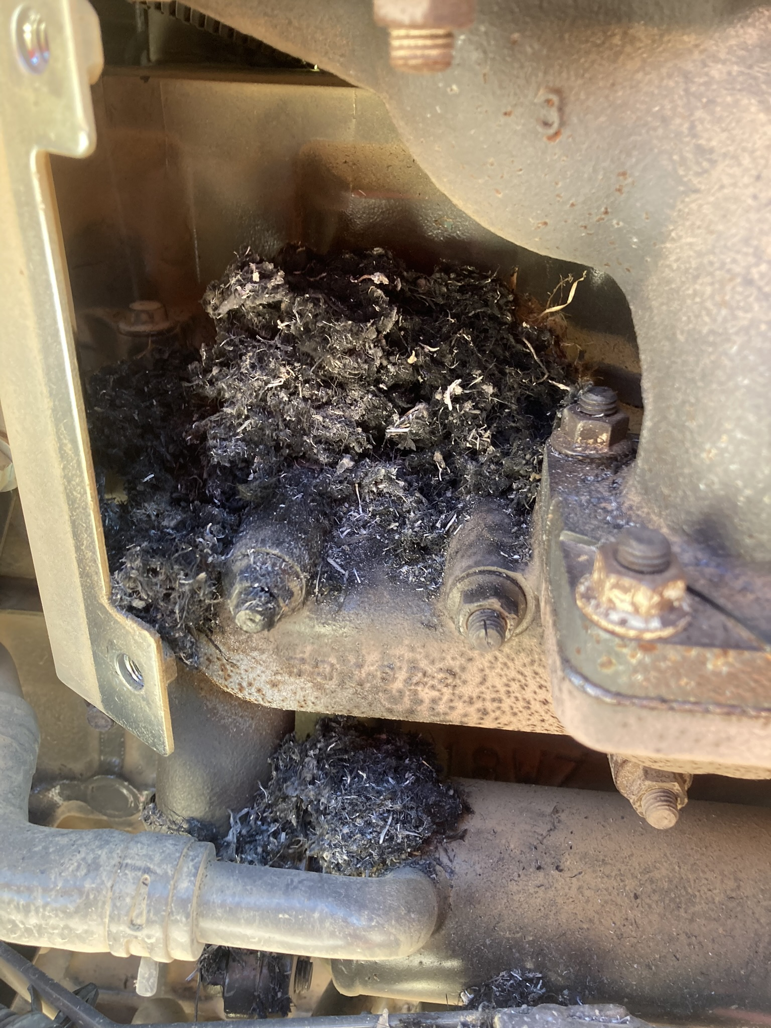

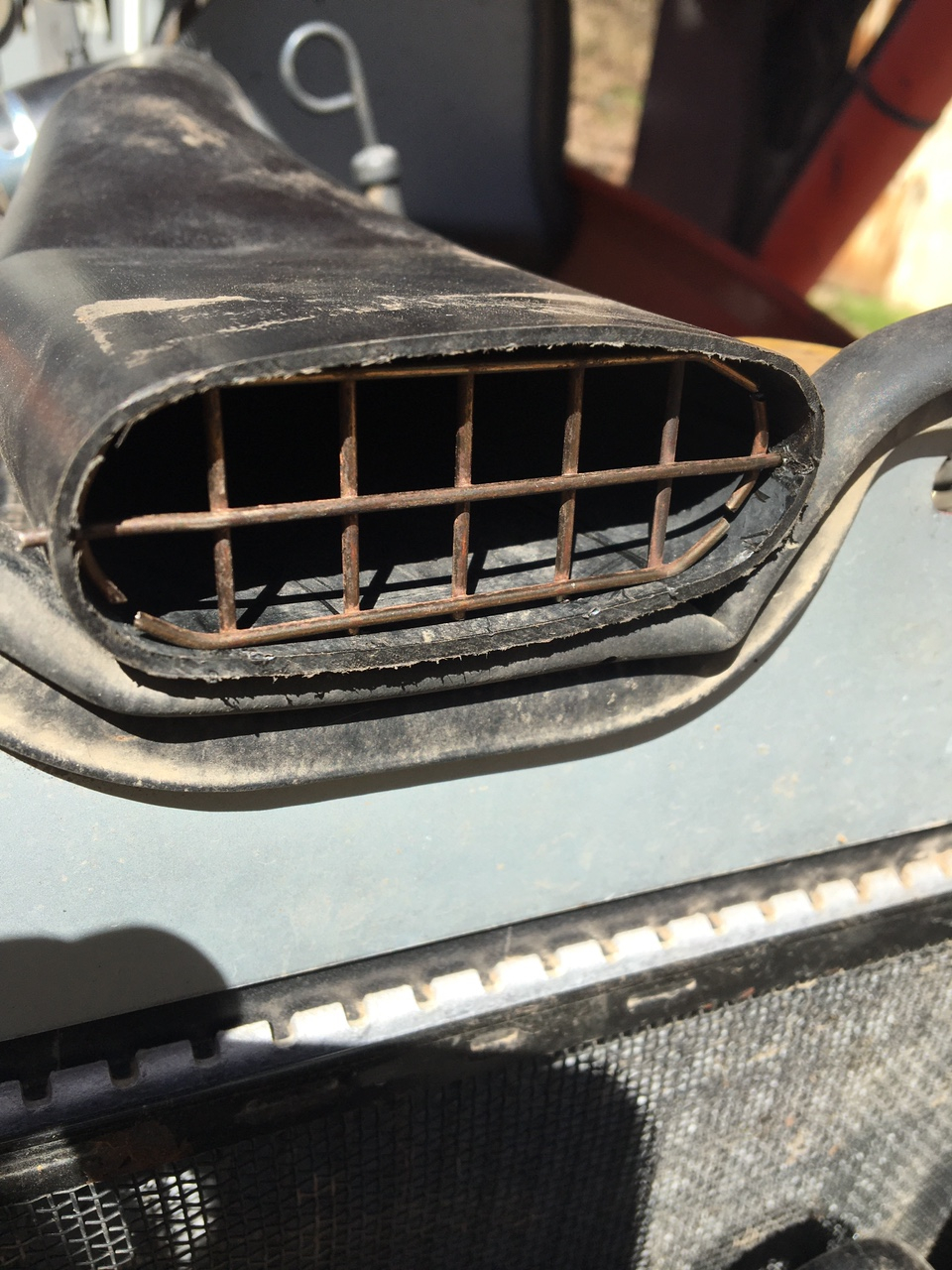

I had a scare while using the L3901 today, I started smelling a burning odor while using the tractor today. The next thing I noticed was light smoke from the left side of the engine. I was in tall grass/weeds about 500 feet from the house and water if I needed it. I decided to hightail it to the house and shut down quickly. The smoke faded away quickly, upon inspection it looked like burnt grass near the exhaust manifold. I removed the plastic left side cover then the heat shield manifold cover. Darn mice, built a nest on top of the exhaust manifold. Glad it wasn’t worse.

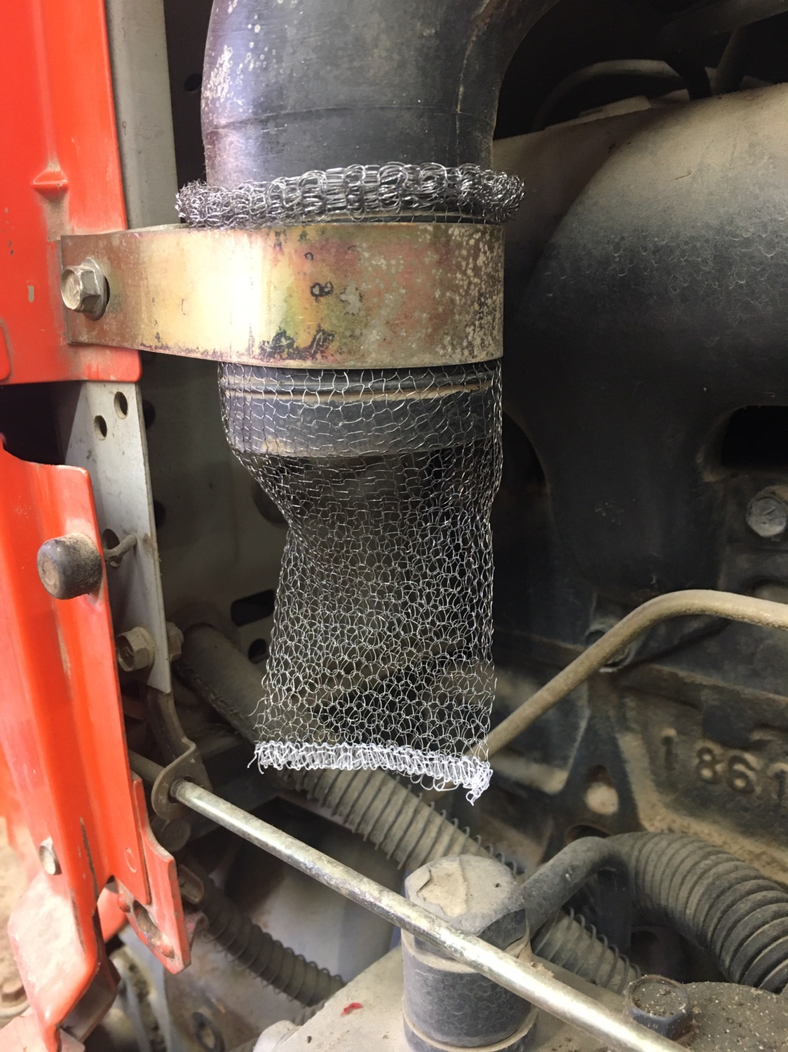

I used a lint catcher on my air intake to limit critter access.

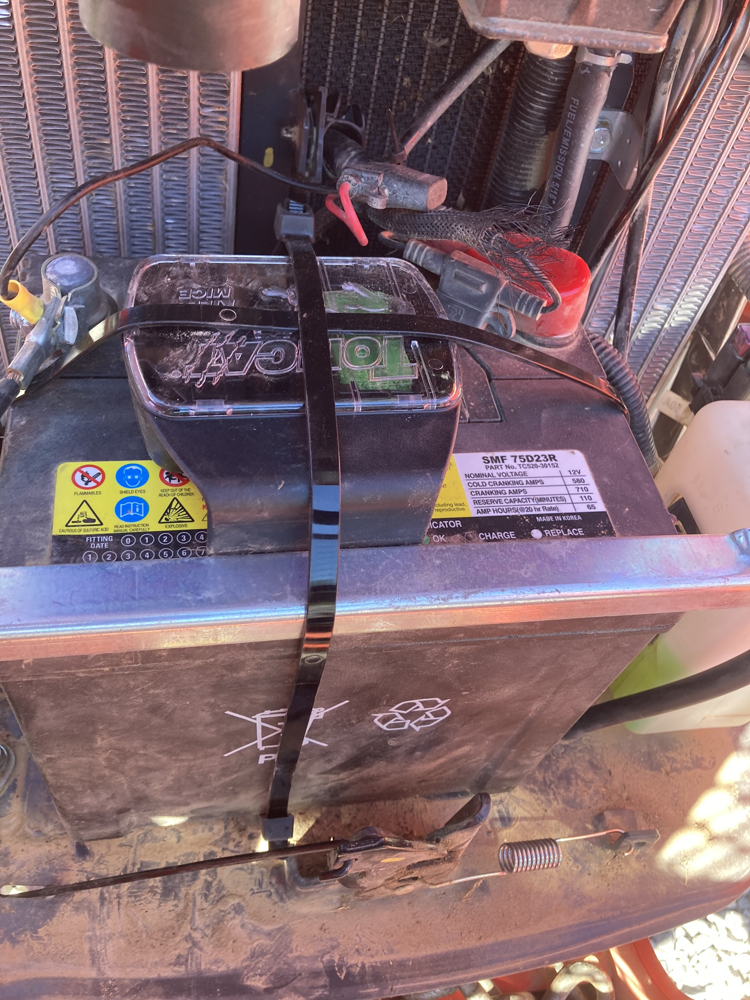

I plan to go over the tractor today and try to “Think like a mouse” picking up some D-Con, and going to inspect air intake. I appreciate all the suggestions.
Mike
/ I smell smoke!
Not my best work but passed the “That’s not going anywhere”
tug test. There just isnt much available space on this tractor.
Mike
