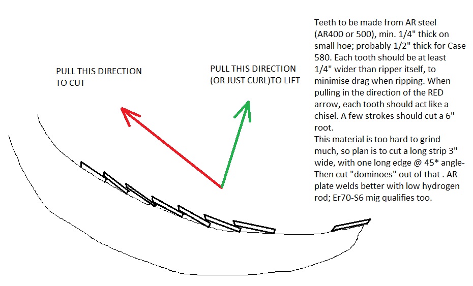

My 580B came with a 24" bucket; I built a 6" "ditching bucket" using 6" channel for a spine, made it long enough so I could get 3' deep without the dipper tryin' to widen the ditch to 12" (sorry, no pics ATM) -
Tthen I lucked out on CL, found a 4' wide loader bucket - it's sitting there til I find that round "tuit", at which time I'll trace out the ends and plasma cut a couple more ends, then cut the 4' into a 1' and 3', or (more likely) a 16" and a 32", both of which will have smooth mouths;
the 16" will be mainly for digging footer trench, but I might make a pin-on tooth bar for it (clay soil, yuk) - The 32" will be mainly a grading bucket.
Your QA helped keep those projects in my mind :D ... Steve
