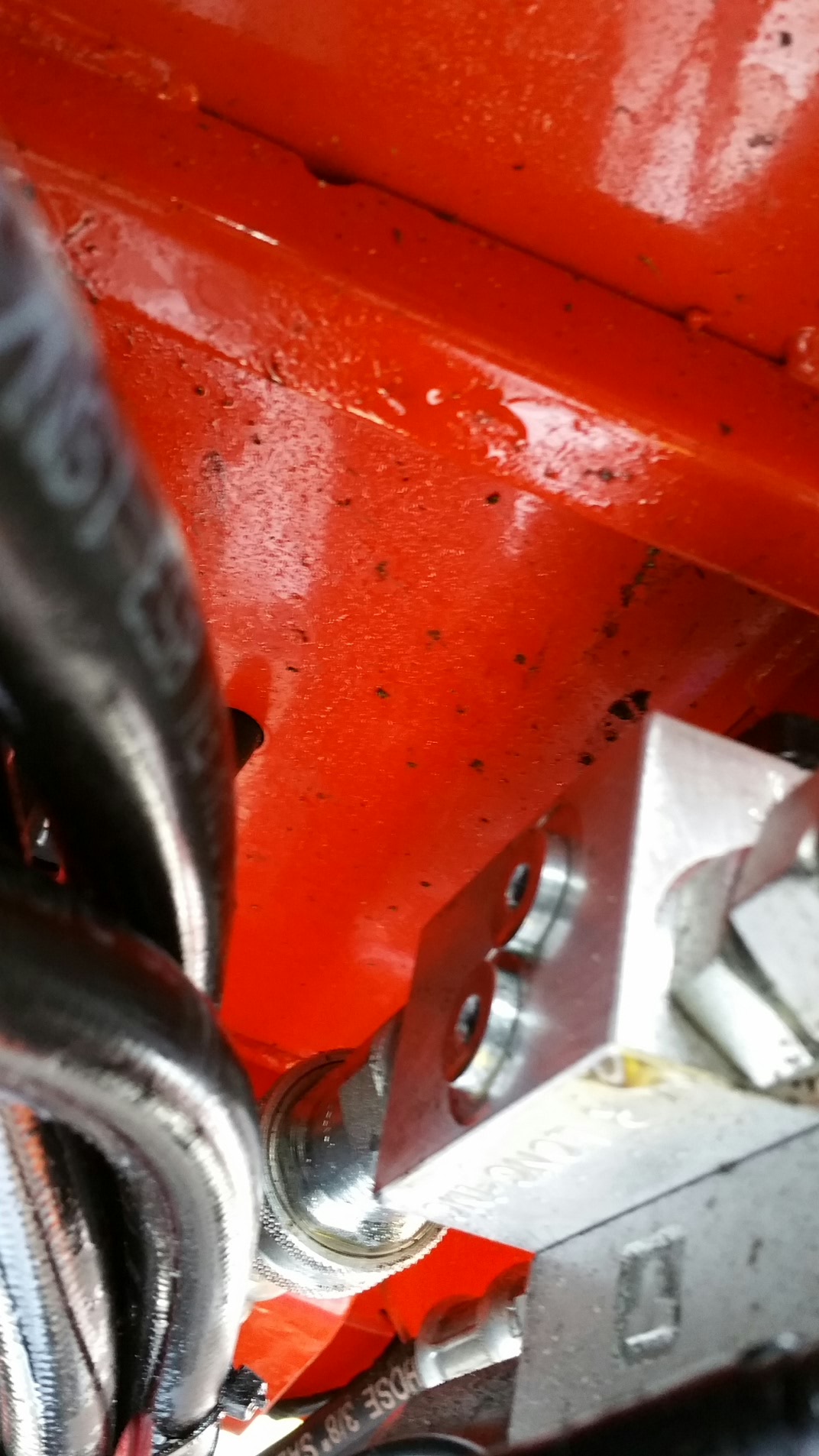

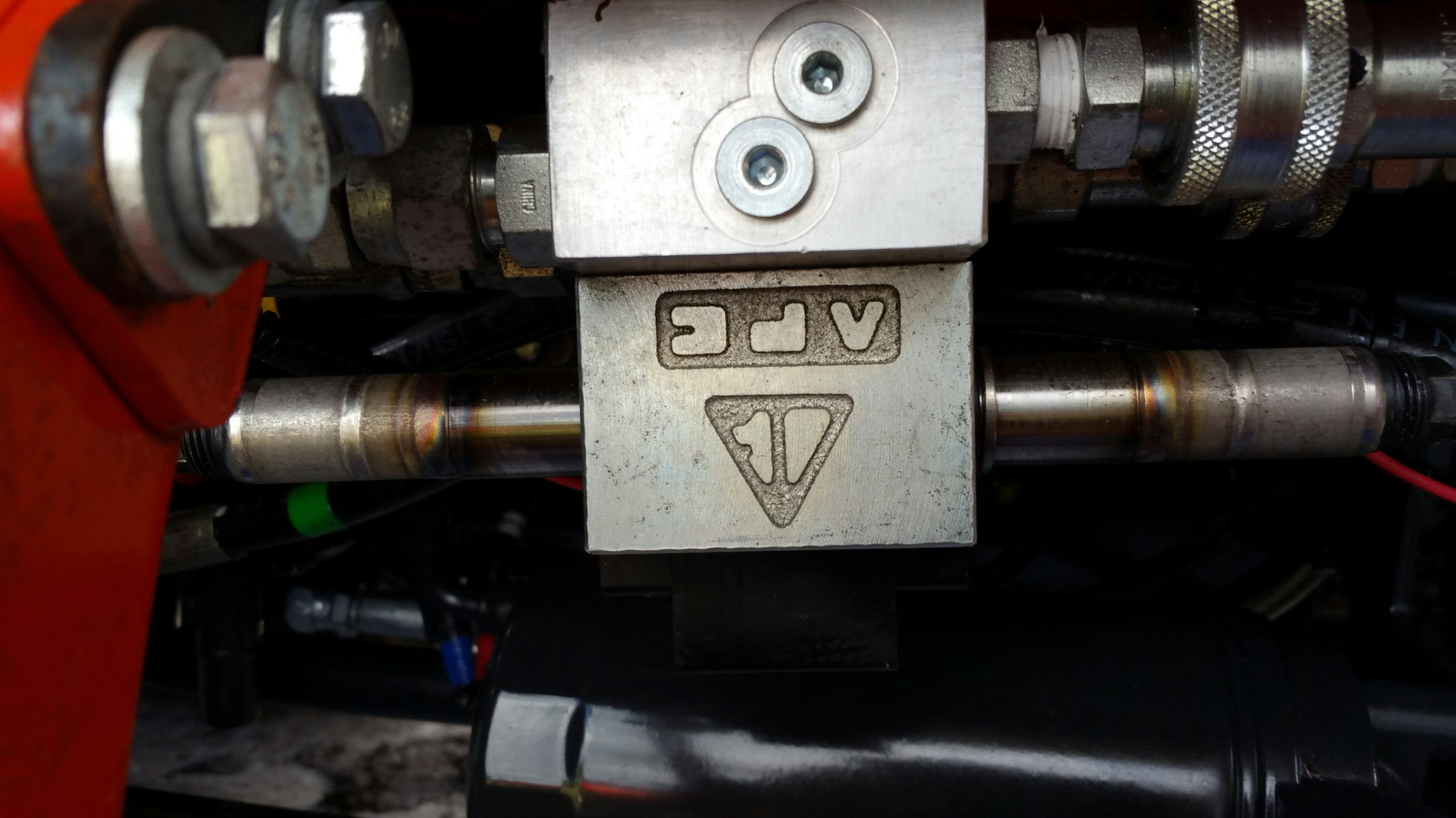

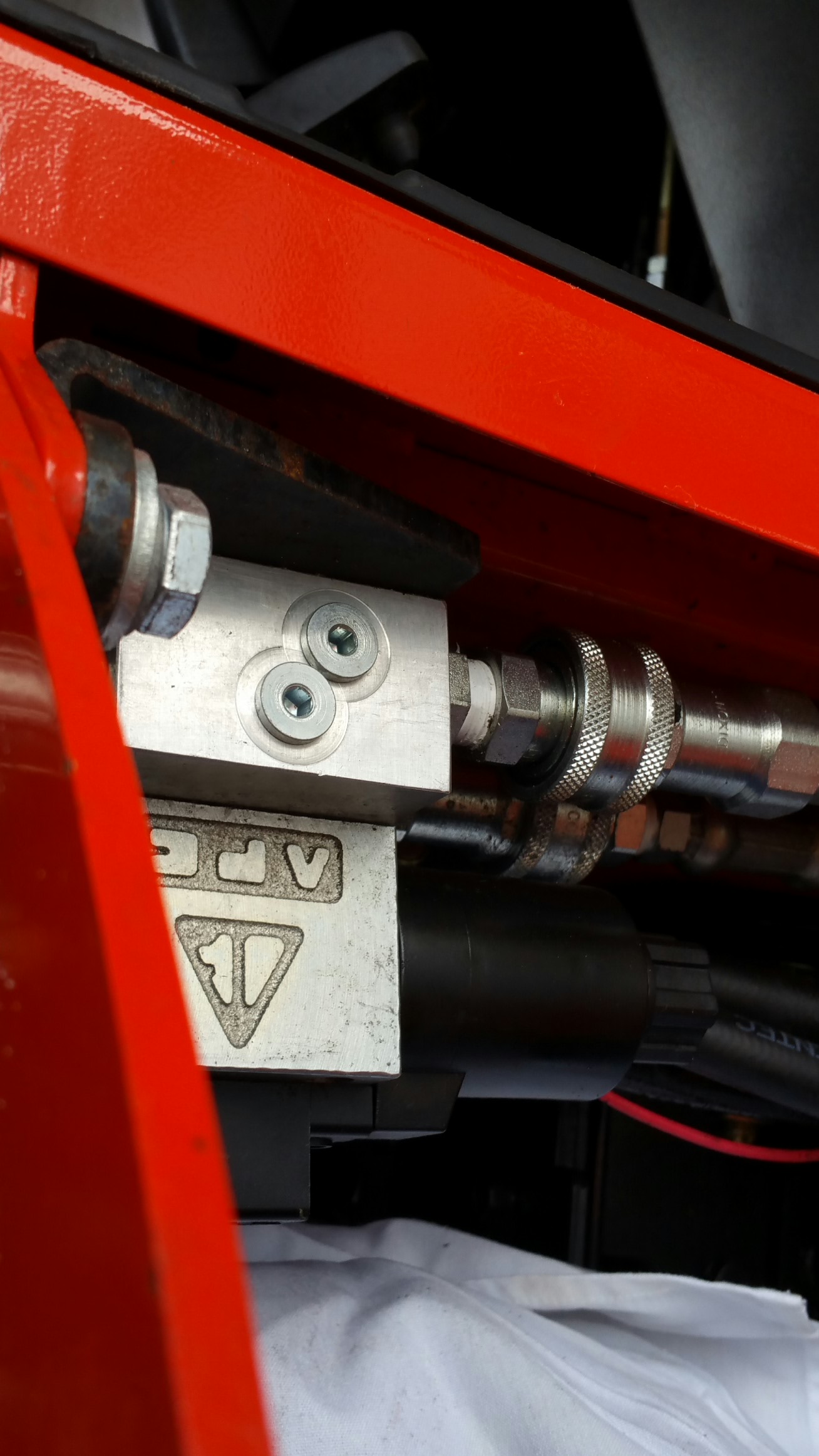

First thing I decided to try the instruction for bleeding the HST. This did help some it allowed me to now be able to operate steering,loader, and 3pt with out any rpm loss like before. But I still have little FWD, REV and third function. Attached are the photos of the 3rd function along with the plugs I was talking about. The first picture is of the plugs that were leaking the second is of the front plugs (there are 2 on each side). I followed all percautions prescibed. Stole the wifes beach towel, and other things that I didnt think she would miss, I also got her new dish gloves. I used the leaf blower and blew off all debris, and further used brake cleaner to get rid of any residues. I then preceeded to take apart the valve, it was pretty much as the video showed. The spool was easy to push out through the right side, but would not come out on the left side. I saw no debris or shavings in the oil and I collected everything that dripped out in a piece of tupperware. After checking all that I reassembled and checked for leaks, nothing was visible.

Here are the pics I could not insert inline.

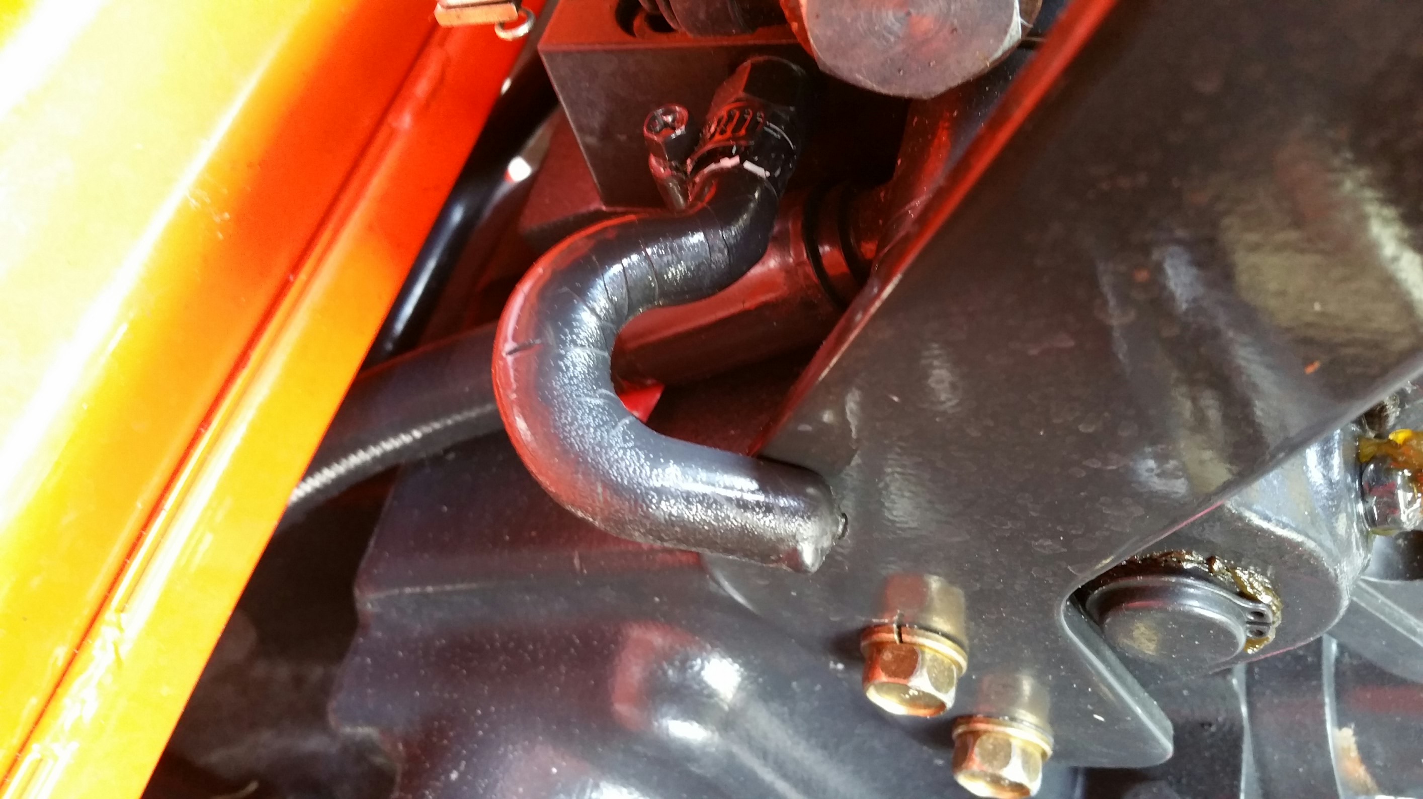

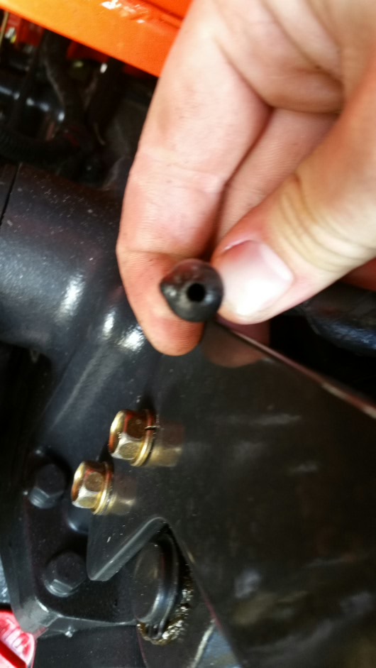

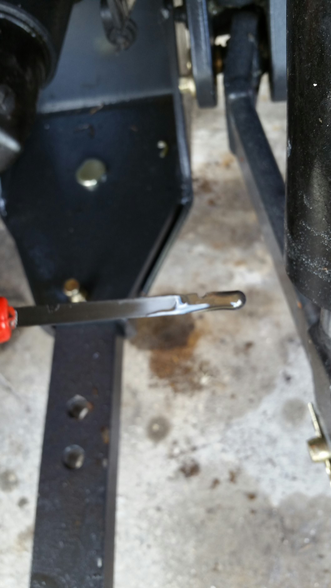

Next spoke to the dealer he wanted me to check the HST vemt line first. Did that and it was clear but to be sure i removed it and blew it out with the air hose. 1456163682342.jpg1456163688909.jpg
Here is the HST level currently with engine cold and all cylinders down.

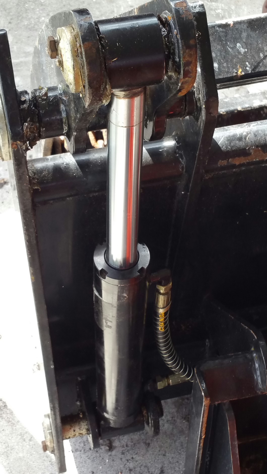

Someone had asked about the cylinder, it was the left side cylinder on the grapple that needed replacing.
I also have called EA reference the valve to get there insight (Helpful as always). I have sent them pics and they are contacting WR Long for tech support.
I will contact the dealer again and see what he thinks next. I was thinking about draining all HST oil and starting over with that as well to see if that helped any. I dont generally like mixing oil when avoidable.

Your dipstick fluid level looks to be above the full mark? If it is, get it to just at full, (tractor on level surface), engine off. Too full can overpressure the seals and cause other potential issues.

#1- If you look at post #35 picture you will see the plug I referenced that was leaking. just under the flange is where the O-ring sits. the actual threaded part is much smaller that the head would show and it sits external of the valve body. I checked the plugs on the opposing side and they are all the way tightened down. I tried to take a picture of the hole with the plug removed but the camera died on me. At any rate the plugs have no tip to them and just lead to an open cavity I see no restricting ability or any flow control function just a hole. I talked to the dealer and he feels like they might be to release air/pressure after install??? I contacted EA today and they are working with WR Long to provide more answers on the valve assembly, apparently they source a multitude of valves and have to research the particular one I have.
#2- Post #36 on the last picture, I have a picture of the cylinder that was replaced. I had replaced that cylinder on the left side of the grapple first thing on the morning all issues had started. I followed the directions provided which were essentially plug and play. The cylinder was replaced because it developed a seal leak around the piston shaft ( just a weeping leak but it was under warranty so I replaced it). The plug was the only thing that was leaking and it appeared to me that it probably just was not tightened fully at assembly and had worked loose, all others were tightened all the way down and this one was loose (finger loose).

#4- the dipstick actually has 2 notches on it and the fluid is sitting just above the bottom notch indicating that it is on the low side of normal.

Just commenting now. I couldn't understand what little screw could have worked lose but the photos in post 35 cleared that up. The actual valve is the cube that says APC on the side but all the hydraulic connections are all made through the metal block that is bolted to the actual valve. Apparently, the block was designed to accommodate a variety of connections from different directions and these "small screws" are just plugs to close the unused holes. I wonder why the spool would only exit one side of the valve body? Maybe this valve body was machined to only allow removal from one side, even though the valve in the video showed removal from either side? Or could there be debris or damage that prevented the spool from exiting the other side? The valve spools are designed to be balanced so they are not effected by different pressures on different ports, but trapped air can do funny things in hydraulic systems; so maybe that's a factor. Air would have gotten into the system both when the cylinder was replaced and when the screw plug was open. I usually cycle a new cylinder several times to purge any air, which worked fine, but I've never used a selector valve. This has been a very educational thread but probably less entertaining for the OP.
