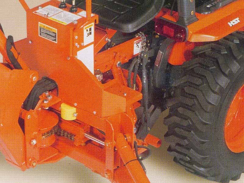

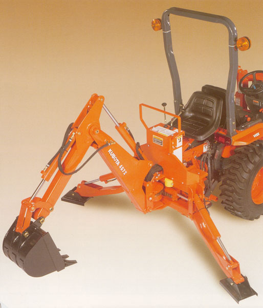

I'm a bit surprised here. I was sure that a B4672A backhoe was 3pt hitch mounted.
   / I think I has decided #6
It really looks 3pt hitch mounted to me... but I could be wrong.

Stef, I think you're right. I was looking into a used B7610 with the 4672 BH awhile back and the owner said it was 3pt. mounted but with some kind of support bracket that added a 4th point. Dunno if I misunderstood, but it sounded like a whole lot less than a full support frame like the Woods has.
