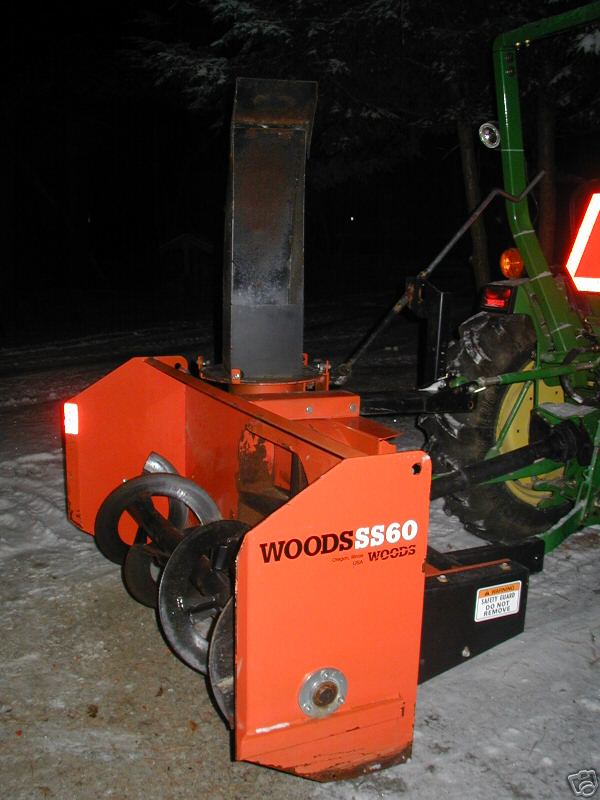

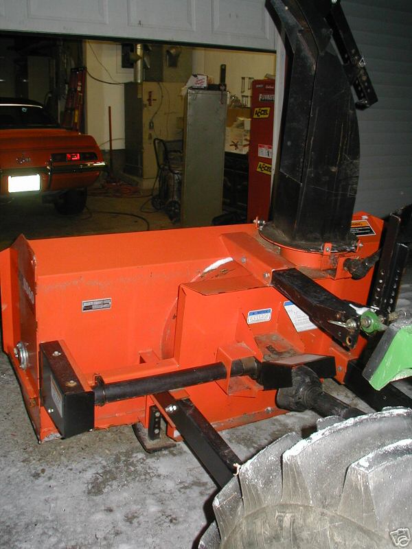

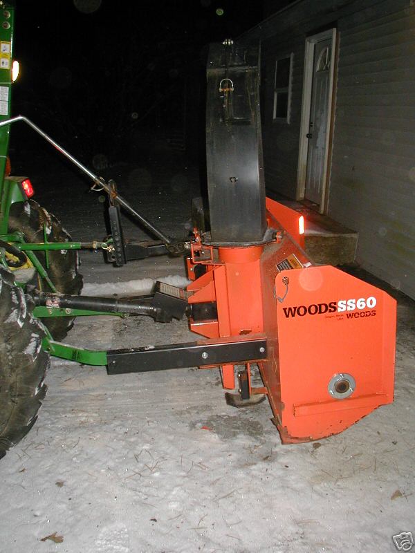

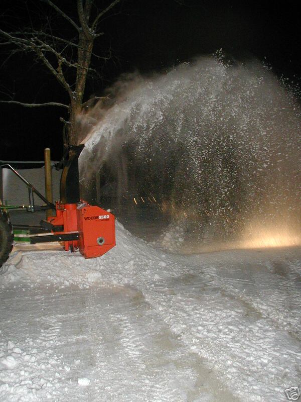

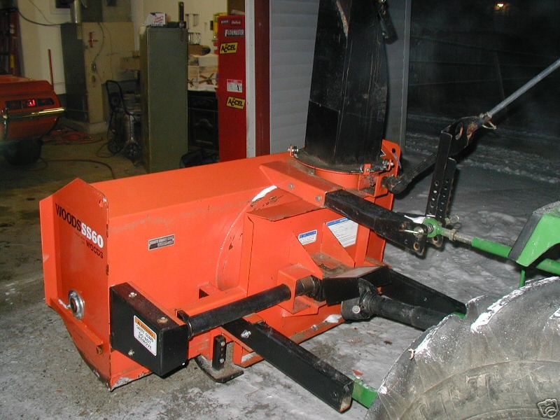

I would think that a good number of us have had the same questions in the past! I for one wouldn't ask thought (LOL)
Looked for pictures and the only one I could find was of my woods blower mounted on a JD tractor. On the picture showing it actually blowing snow you will see the blower is way up off the ground.
Go ahead and hook it up to your tractor and see how it fits!
Wayne
