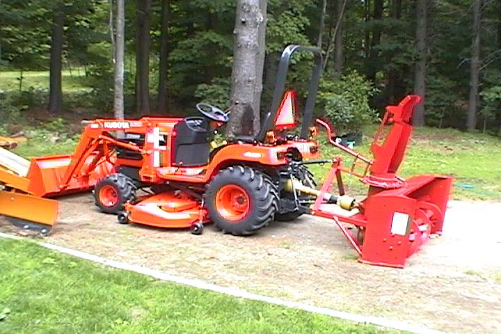

   / I Think the BX2200 is Just Right, but ... #8
Hook,
Use something like this to clear the driveway..... :)
That's a BX22 with 51" 2 stage blower.
#9
Poster: JimMorrissey
Subject: Re: I Think the BX2200 is Just Right, but ...
My God. It looks like a mutant :)
Isn't it a pain using a rear blower? How long is your driveway?
