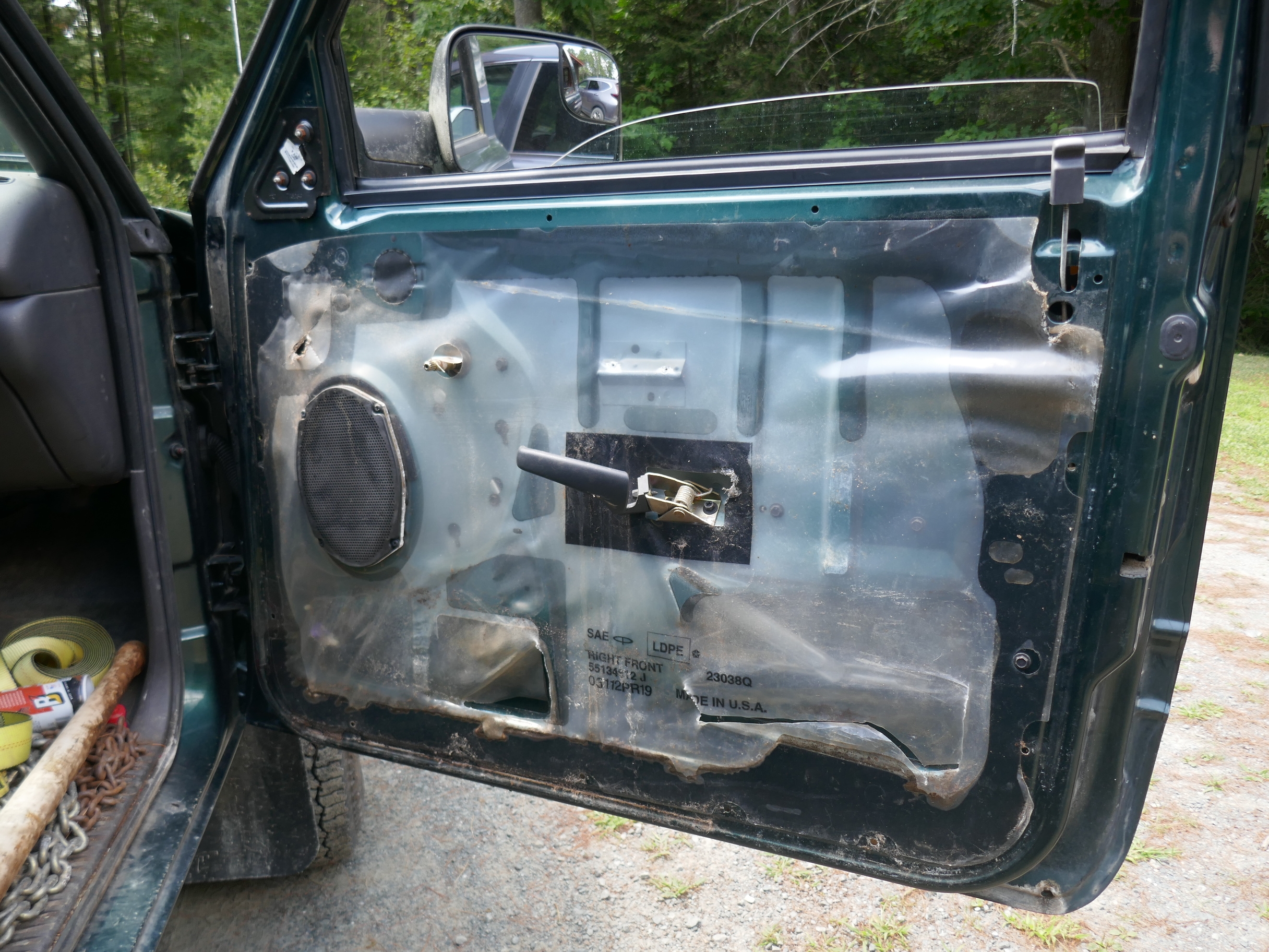

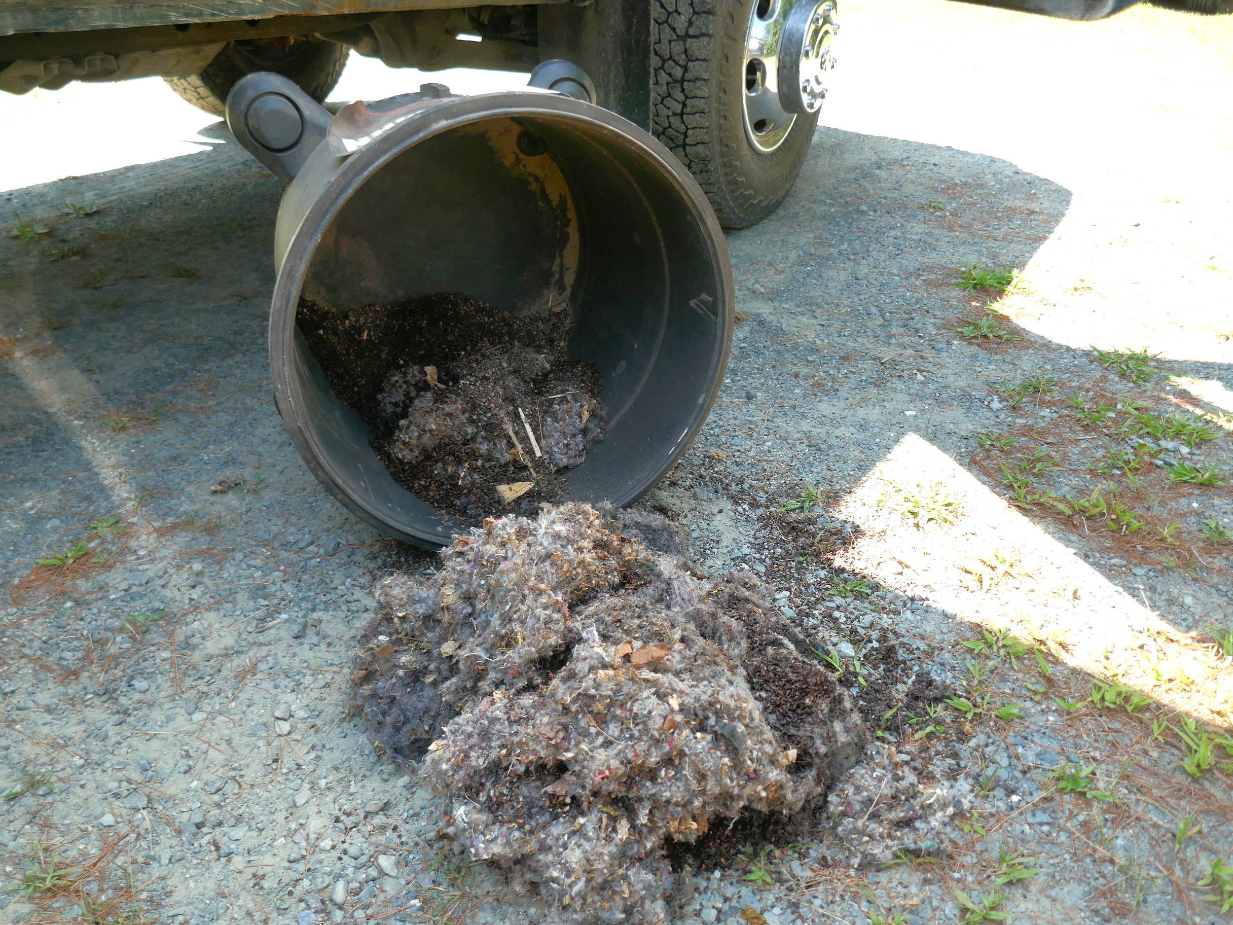

In my One-Ton. So I took the door panel off.....
and cleaned this out of the bottom of the door
gg
If you search, I had a mouse pi$$ situation on a nice farm truck and managed to get the smell completely out.

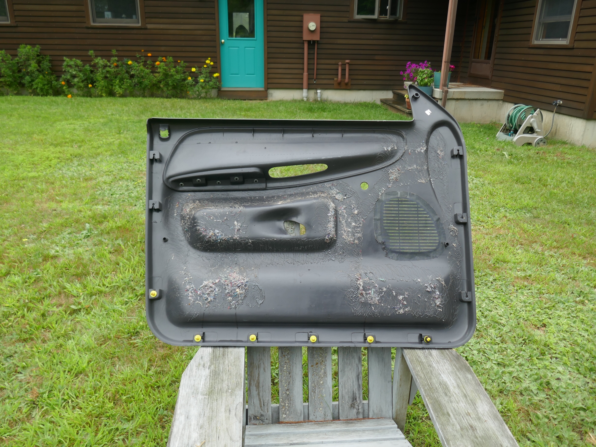

I have been trying for almost 2 weeks to get the mouse smell out of this door panel that was partially covered with felt insulation. The mice had chewed up most of it. I used multiple heavy applications of enzyme odor remover, sun, and air. I got out most of the smell but not all. Maybe good enough for an old truck no one rides in but me but I decided to rip out all the insulation because I was pretty sick of mouse smell. Now there is not even a hint of mouse. So The enzyme worked pretty good but not perfect.
