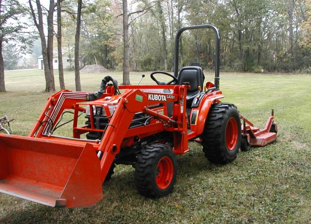

for your usage, i don't beleive the 7500 is too small, if u want u can jump up one size and check out a 2410. but when it rains dowm there(not that often right) just stay off the wet area. i pull a 5ft RFM behind my 2400 with not a problem, if the grass gets out of hand i just slow down and let the mower do the work, great advantage for using a hydro.
