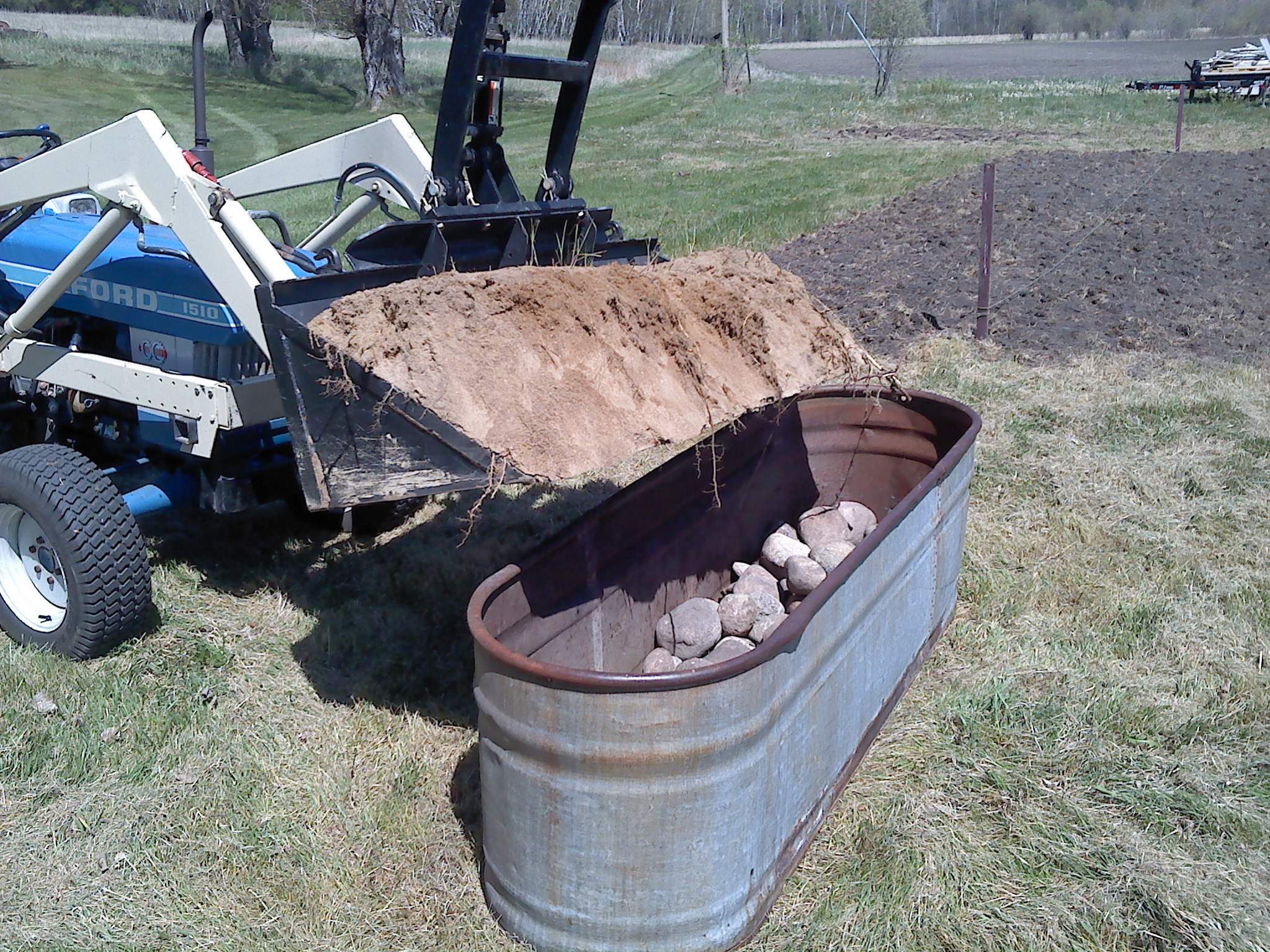

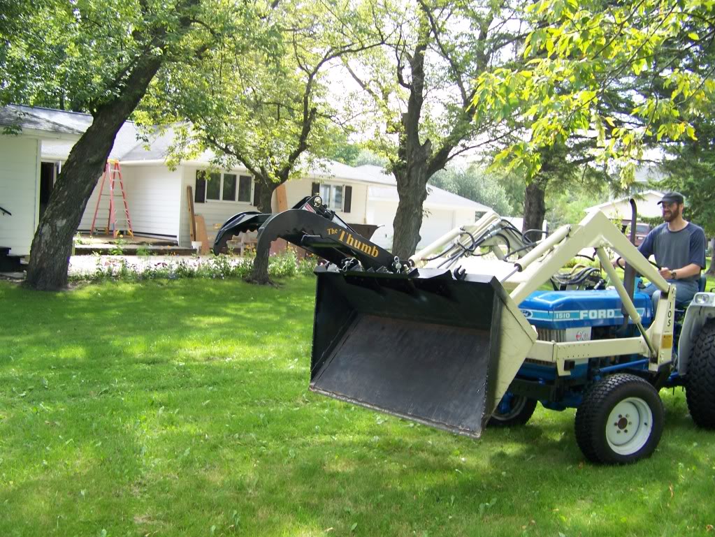

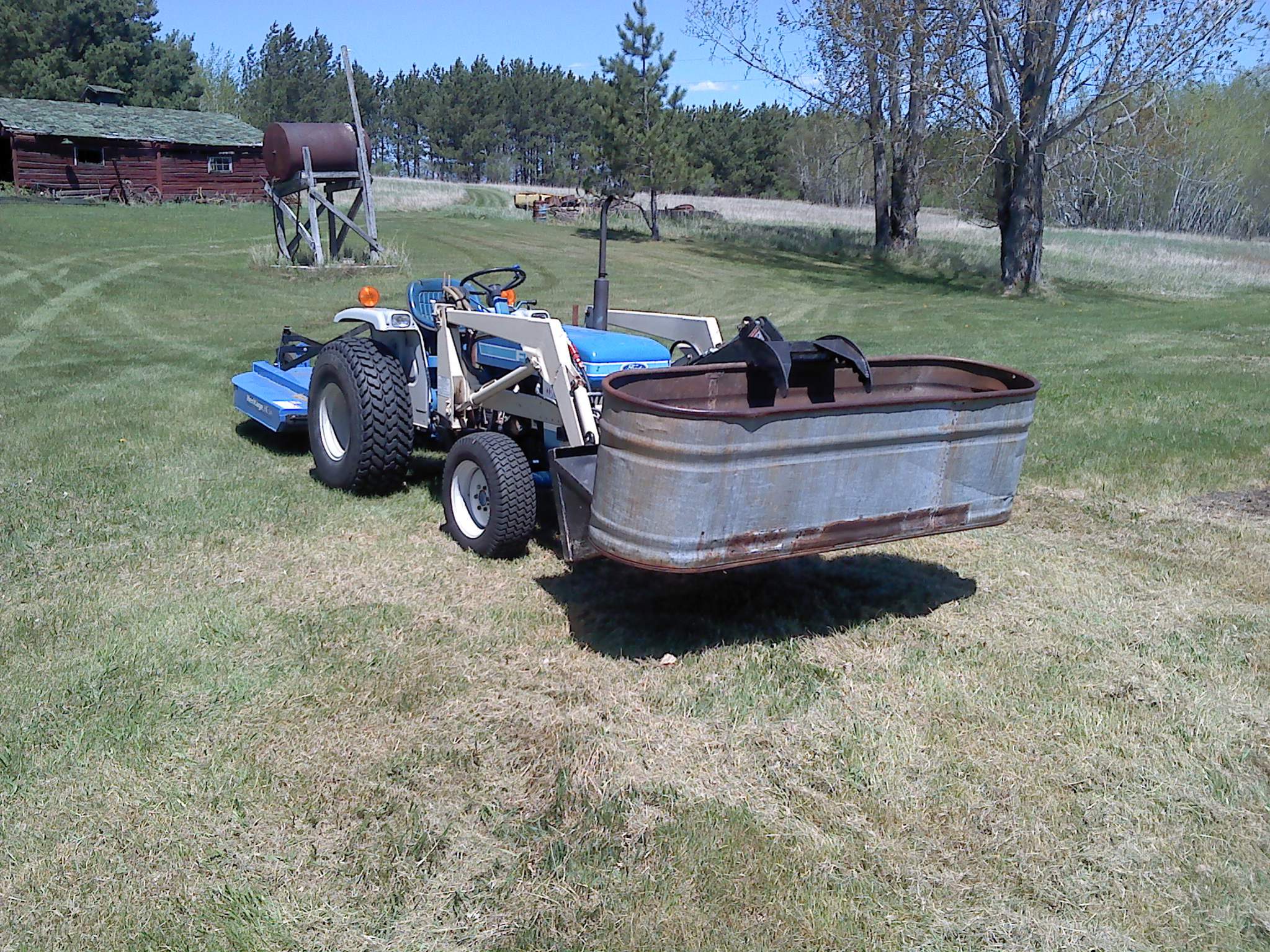

Bigger? You mean like this? :thumbsup: It's home-made and was on the tractor when I bought it; I only added the grapple. It can get real heavy when fully loaded, but I love the huge capacity. I've never wished it was any smaller, as you can always dump a little material out if it's too heavy, and it has allowed me to grab and move some pretty large items that might be iffy with a smaller bucket.

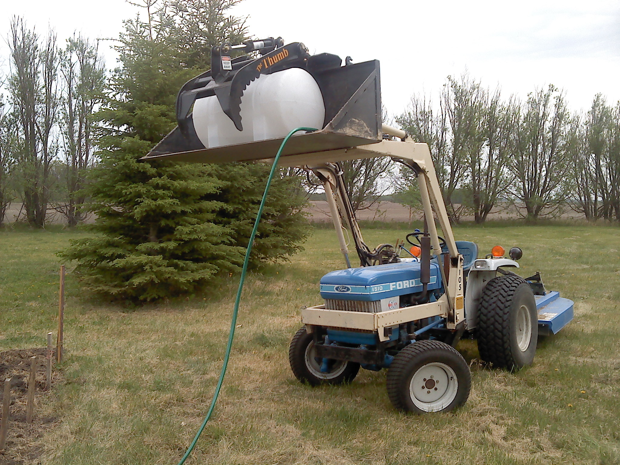

Oh, and it looks like you might need to prop up your over head fuel tank a bit. :laughing:

Hah hah...:laughing: Actually, that's a water tank. We had a dry spell and we really needed to water the garden. There's no way I was willing to purchase and fight with 500' of garden hose and I didn't have a spare pump, so I filled a tank I was saving for a sprayer project, attached 50ft of soaker hose, lifted it high as I can and let gravity to it's thing. Irrigation on the cheap! :thumbsup:
