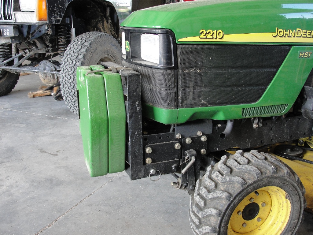

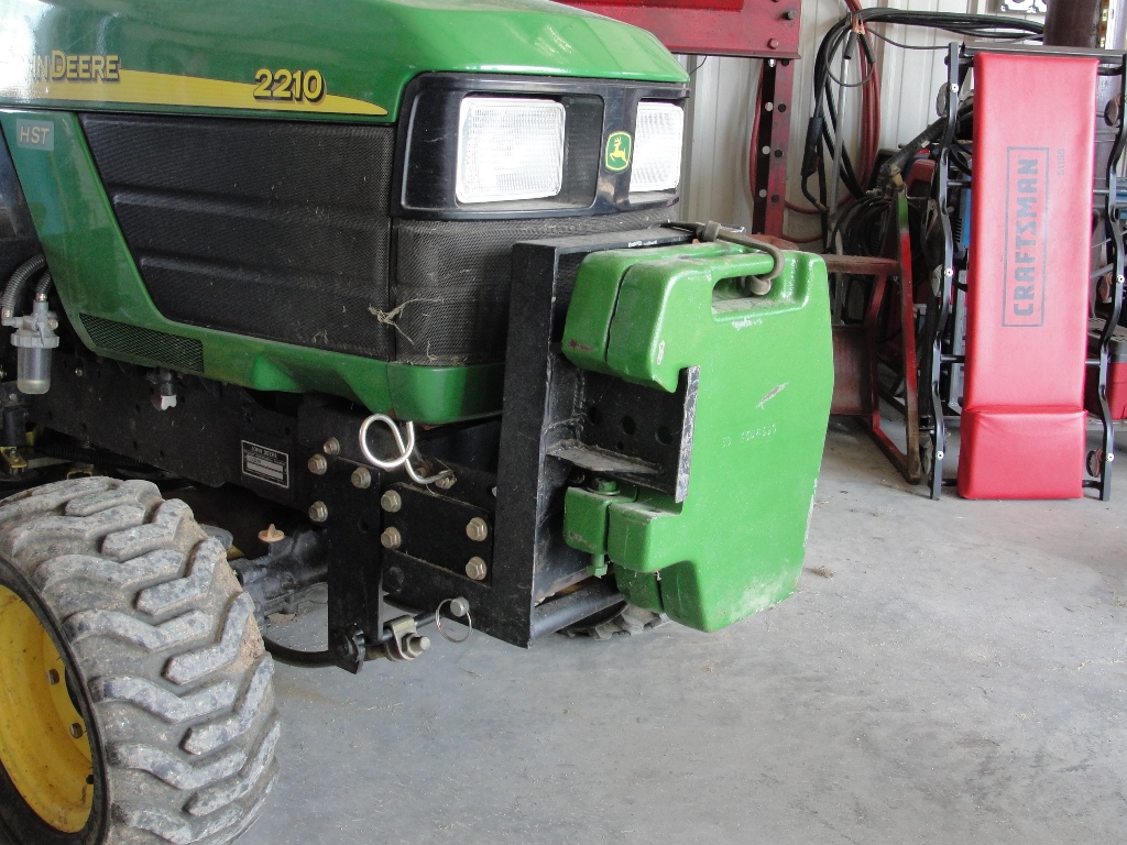

I'd like to know if installing a front quick hitch will interfere with the FEL mounts? In other words can I drop the snow blower and attache the FEL without unbolting brackets?
   / I want a snowblower for my JD 2210 #13
Yes. There are a pair of small brackets that bolt to your existing frame. These are used to "pin" on everything else. I remove everything except those two brackets in the Summer for mowing. I use the pin holes to fasten on a grill guard. The bolt on brackets will have no effect on your FEL.

   / I want a snowblower for my JD 2210 #15
I'm sorry I don't have better pics. Here you can see the brackets that bolt to the frame. The rearward one that hangs down is how the MMM fastens on as you can see. The other one more forward is what's added to use the quick attach system. As you can see I use the two pins to hold my grill guard/weight rack on. I don't believe either would interfere with the FEL. JD is really good at designing this stuff to be compatible.

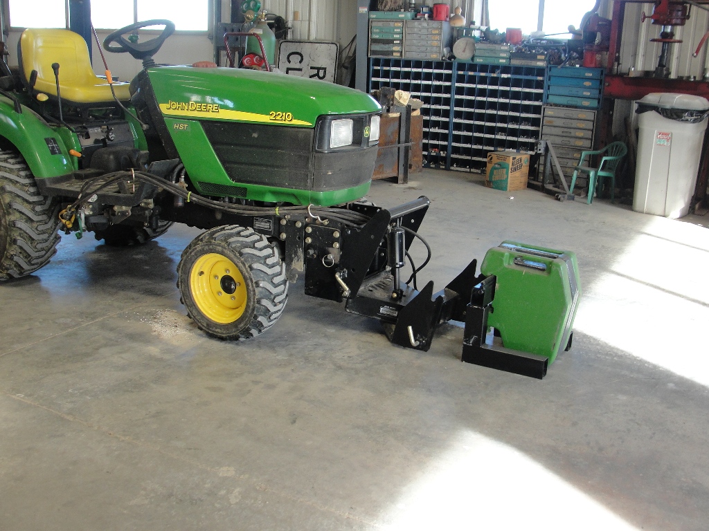

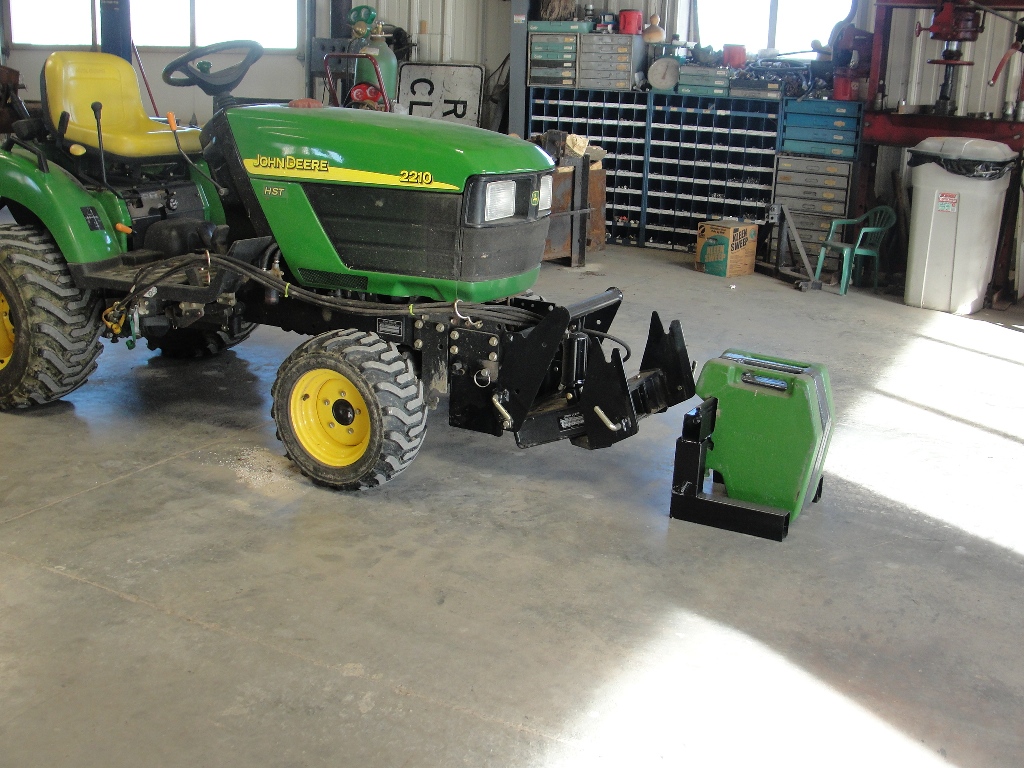

   / I want a snowblower for my JD 2210 #17
Here's the best pics I have of the quick hitch attached. My blade fastens to it. A blower would also. Sorry again for not having better pics.
